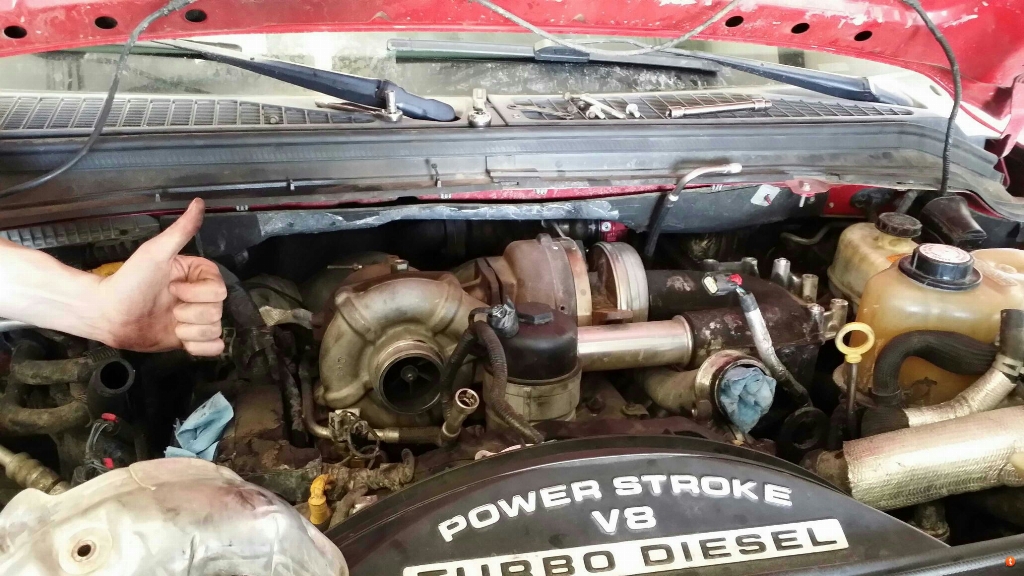

About to pull the turbo's

Yes I know this. Lol. There's gonna be a lot of purple power and De greaser once the stock turbos are out. Before any new stuff goes it, I'm gonna go to Costco and buy a giant pack of tooth brushes. LOL

does yours have the egr plumbing in there?
Yes. I have egr piping. I got the 4 off of it, drive side up pipe unbolted from manifold, and all up pipe bolts besides bottom ones. Well I rounded off drive side right, nothing cutting wheel can't handle
Radioflyer
Jan 8, 2012
1,889
Ahhhhhh gotcha. I've got a waste gate on mine so hopefully it will be a little easier. We shall see.
Cknox121
Apr 26, 2013
1,748
Augusta GA
Thought I was going to snap my 10mm ratchet wrench off lol. You can get 4 of them with the ratchet wrench and a socket stuck on it the end of it to give some more leverage.
I'm trying to figure out a solution to get the bottom ones off with out rounding them off.
Oh a propane torch helps

Turbo's are out, just waiting for a couple more vital pieces. ;)

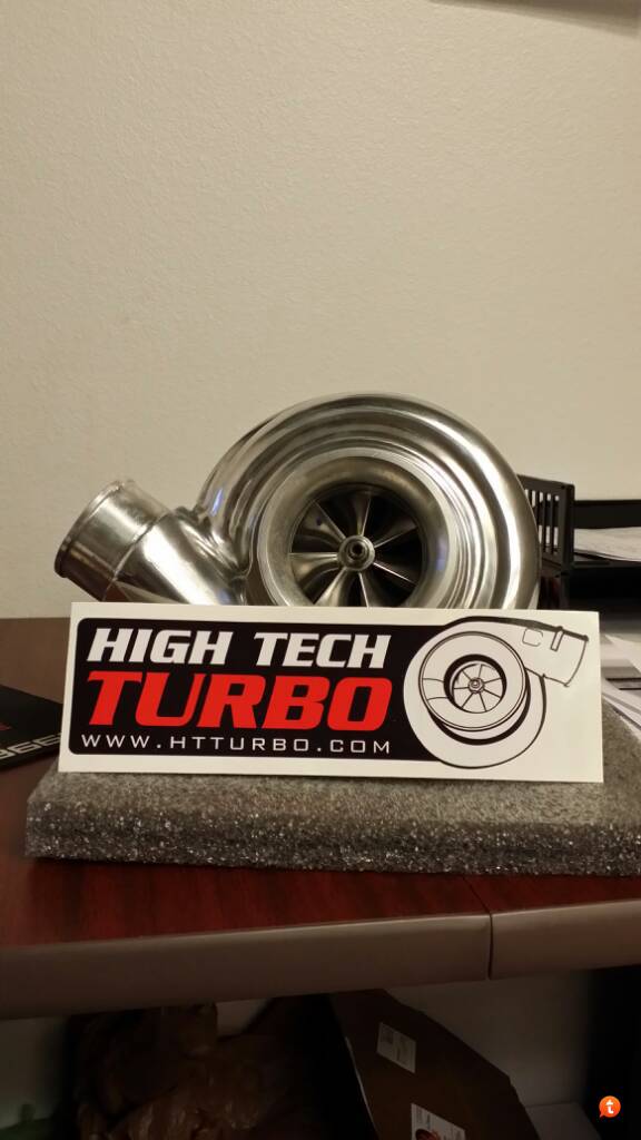

1 major piece to the puzzle, just need to mount it. Thanks JDUB!!
