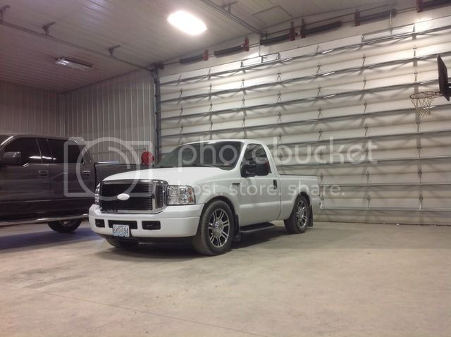

Those wheels look great on there. I like how this is turning out (other than the fact that it reminds me what mine could look like if it wasn't a rusty, dented up beater)

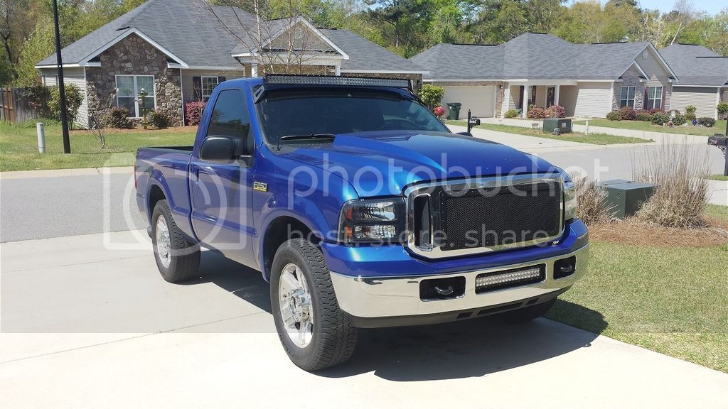

Looks killer man! Yeah, I was going to buy the same grille as yours but I didn't want that ford oval in the middle. So I went with an XLT style grille, cut out the center portion, then installed an eAutoGrille insert. You can see it a little better here...
I was not crazy about having the ford emblem on this new grille, but I knew I could not find a cheaper grille, lol it was $89 shipped. I did not realize your grille was a mesh insert, I found a full mesh grille on CL and the guy would not text me back! I am planning to put a lightbar behind this grille, likely will not match the output of yours there haha
Yeah, I don't know why people pay a ton of money for grilles. You can find them all over the internet for dirt cheap. My lightbars aren't anything super fancy. I've got two "no-name" brands. I bought my 20" LED lightbar in the bumper off Amazon for $66 - and it performs just as good as all the other name brands (except Rigid and Lifetime's new Sun thingy). And the curved 54" lightbar I got off eBay for less than $200. So... for less than $300, I'm putting out over 40k lumens.

You have some serious light output it looks like. I want to mount something behind my new grille, above the ford emblem probably, I don't know what size for sure, I also thought of using 2 small ones instead of one large, I don't know... Mine has cheap hid headlights and the ballasts have failed periodically in the past for us, so I think adding a lightbar may be 'cool now, necessary later' lol

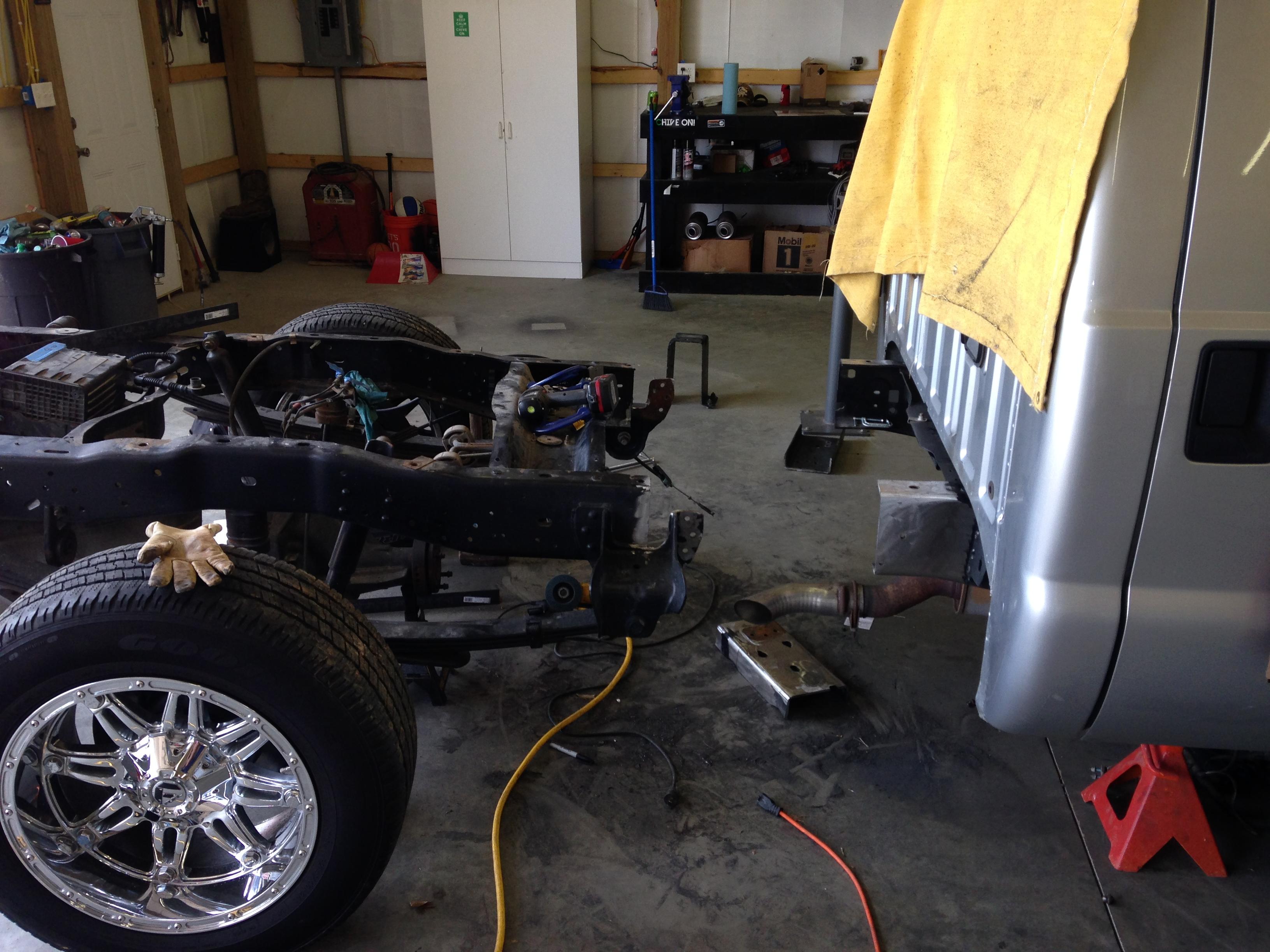

Here's my addition to the thread, 11 model, 250. Shortened it myself. Everything went real smooth, cut it in the center of the front spring hangar to help line it back up/brace it a little. Plated the backside as well. Stayed after it and took 6 days start to finish. Got lucky and came across a new takoff bed.

What did you do for fuel system and driveshaft.

i had a local machine shop build a complete new drive shaft. and i was able to use the long bed fuel tank since the truck is two wheel drive i didnt have to worry about hitting the transfer case. the fuel tank tank was a tight fit and it now sits 16 inches farther under the cab
