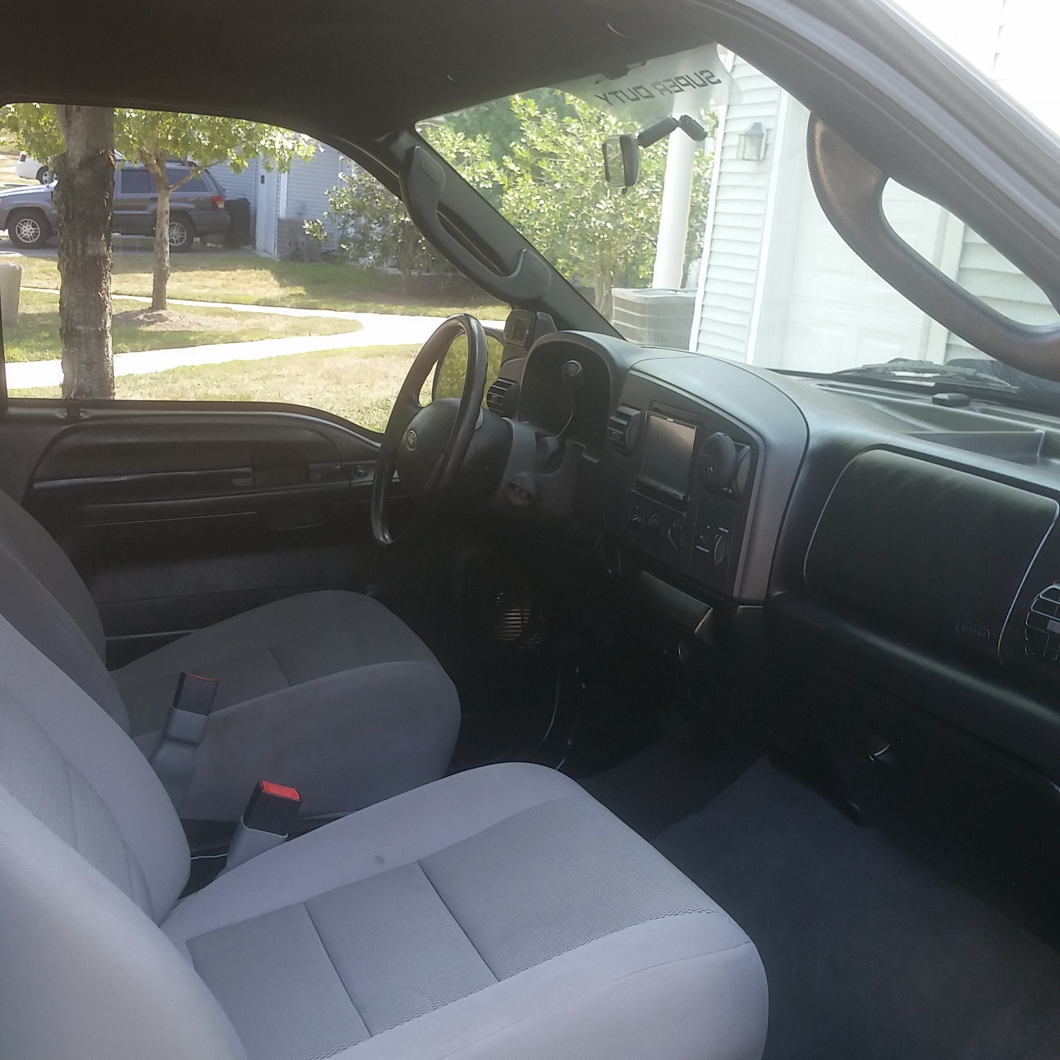

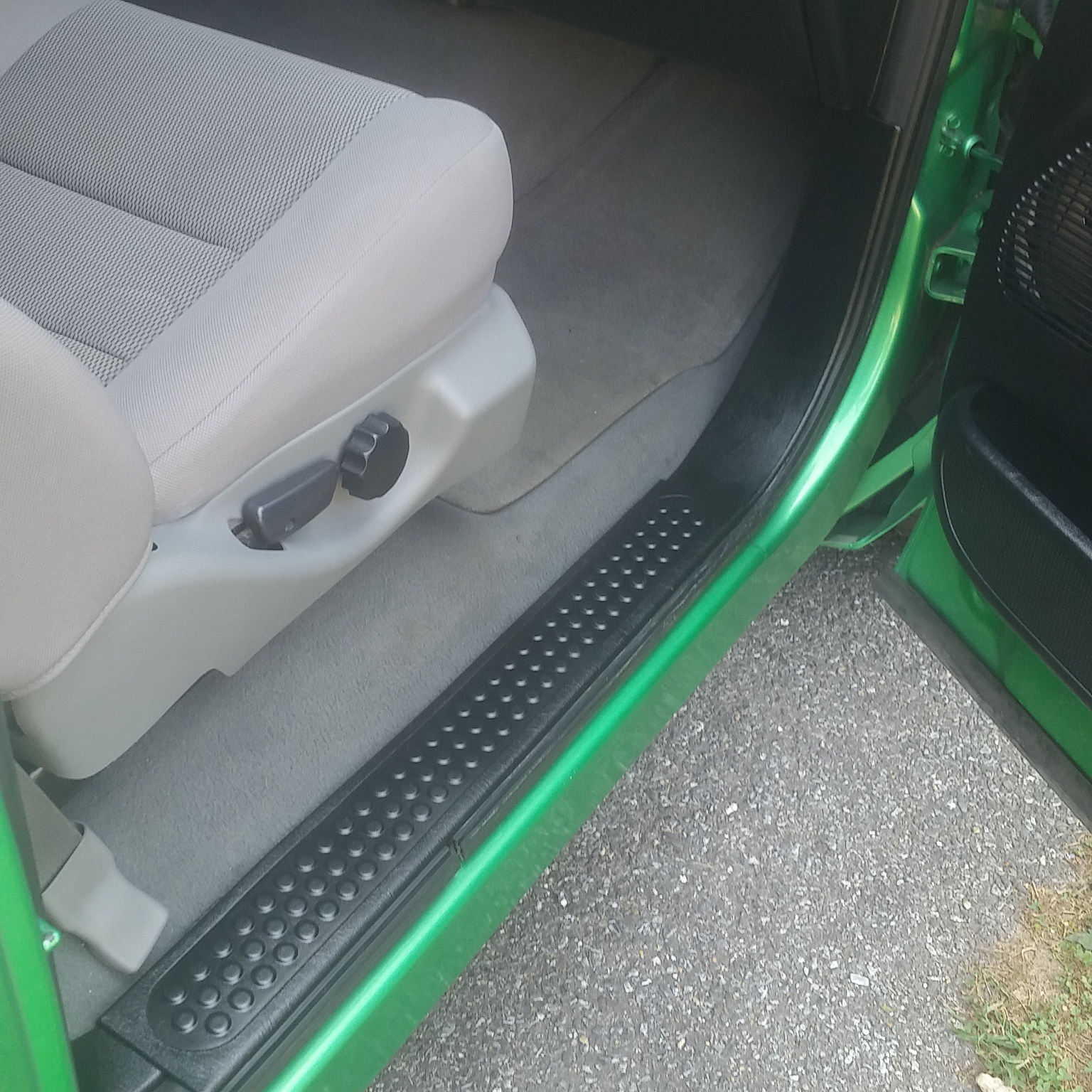

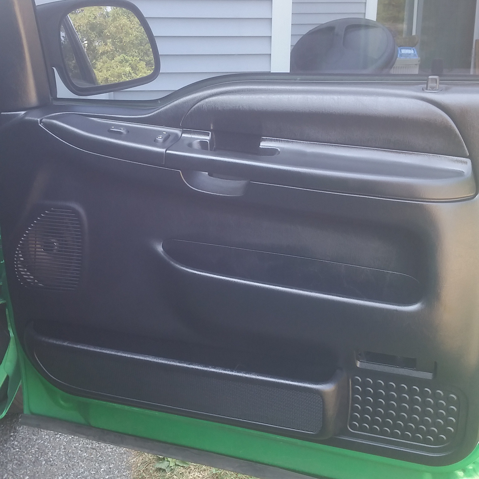

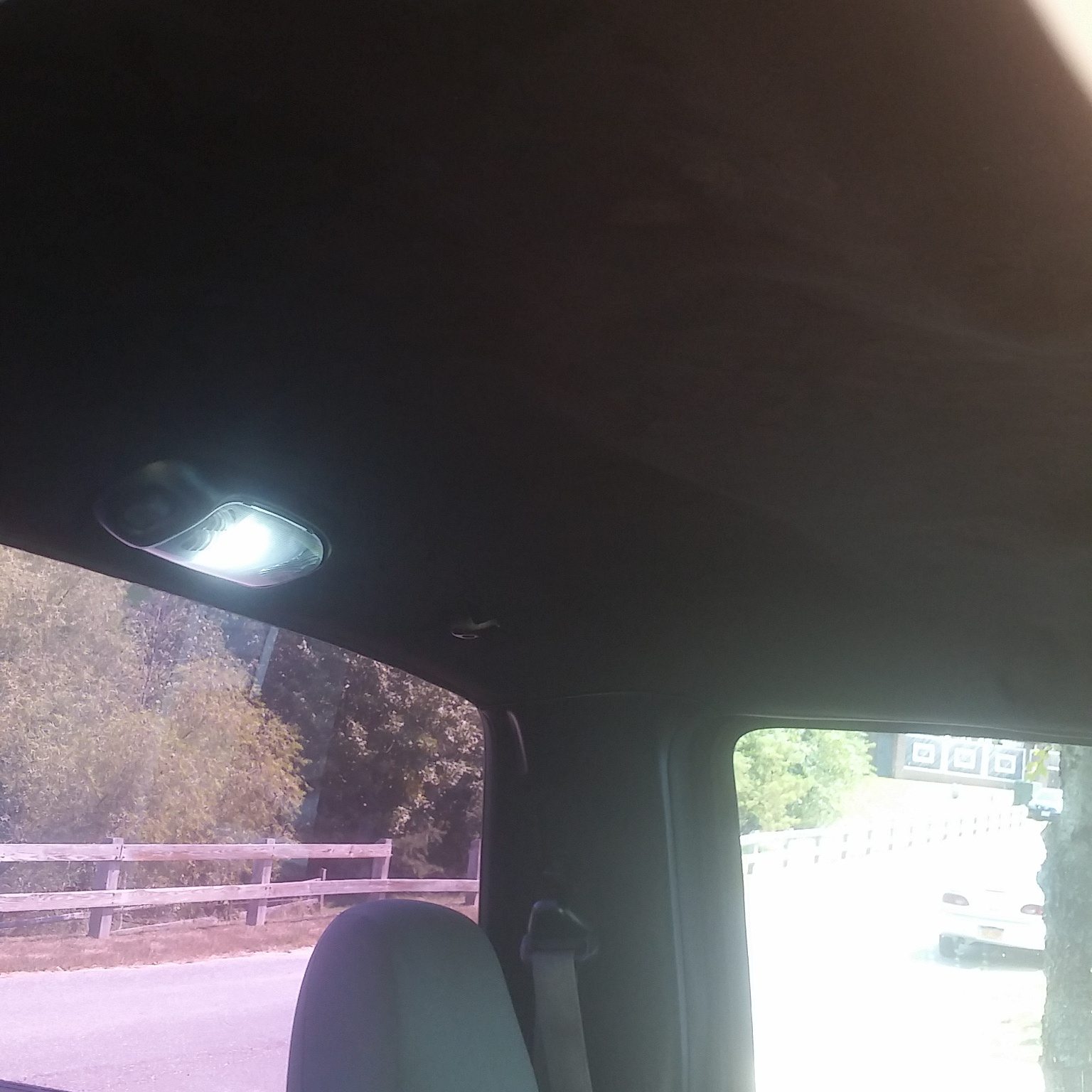

Finished up the interior, just need seats and carpet now.

I used dupli color vinyl & fabric spray to do all the plastic, then got suede at the fabric store to do the headliner.
