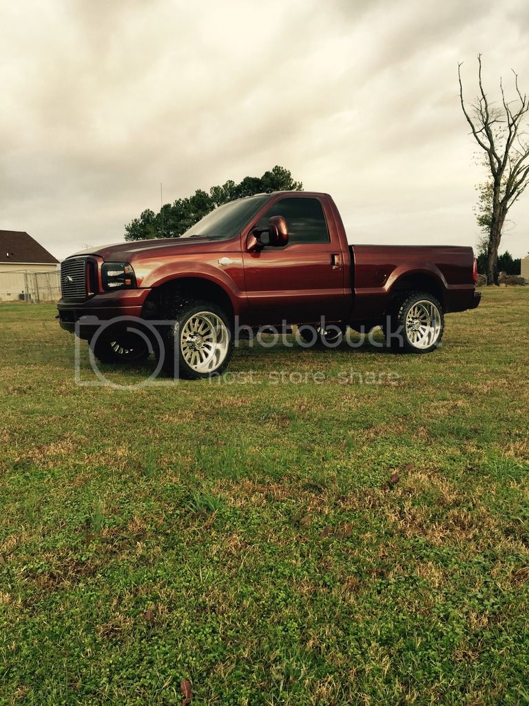

Washed it up the other night however got dirty picking up these king ranch seats down this long dirt lane
