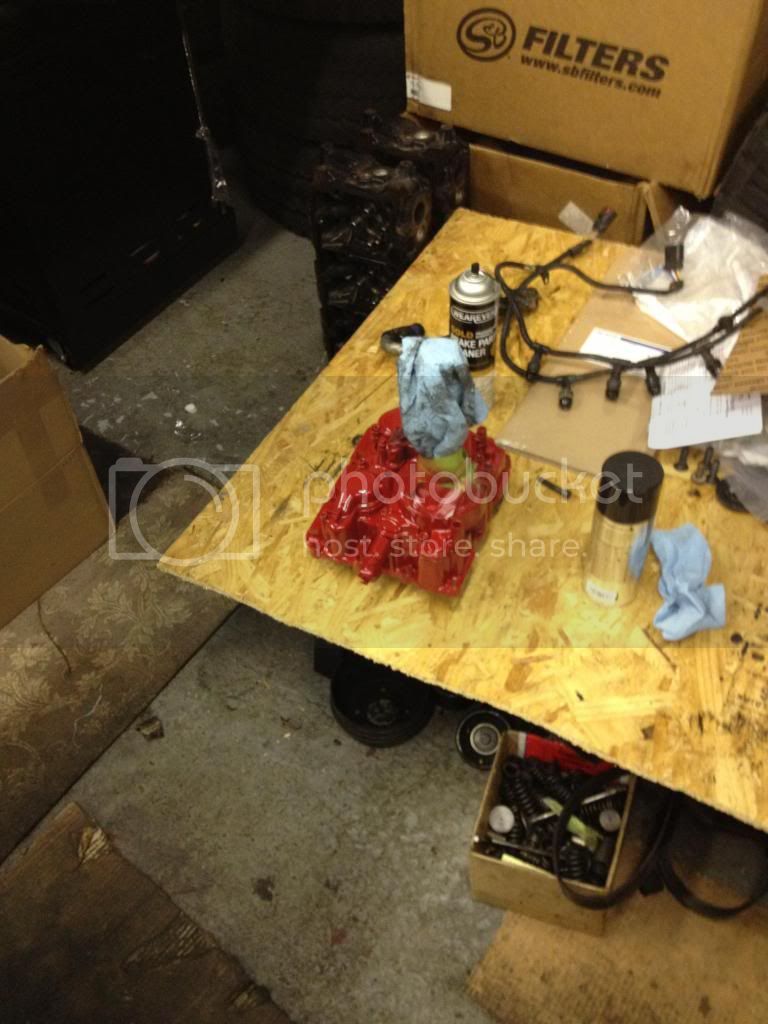

looks like im going to go with 250, should be more that enough with the O-rings......weekend plans
assemble the rest of the motor, replace the oil cooler, polish and seal the coilvoers, and hopefully get them together as well...
powerstrokedkid87
Jul 11, 2011
2,824
New Jersey

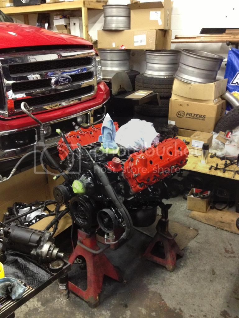

got the motor closer to back together yesterday......Heads are back down, fresh powder coat on the rocker box and valve covers, new oil cooler, just gta toss in the new HPOP, put the wire harness back together...then the oil pan comes off for my turbo drain....some more parts headed out to get powder coated....feels good to make some progress...but a long way to go

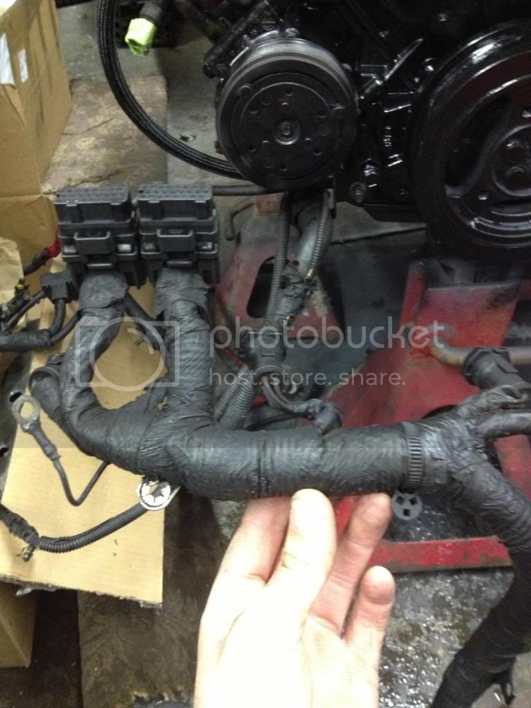

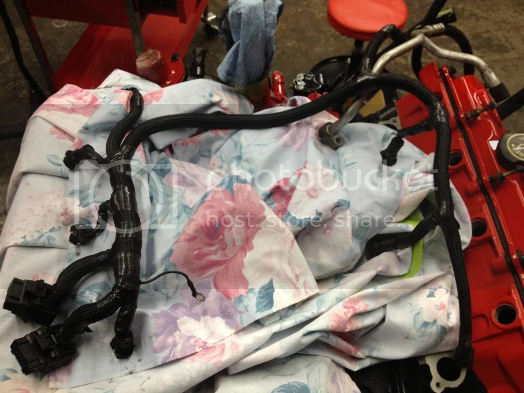

didn't get nearly the time I expected to this weekend, spent about an hour last night re-doing my injector harneses.....
from what it looks like, this wire loom is really going to clean up under the hood!
befor
after
pictures don't really show how good it actually looks
powerstrokedkid87
Jul 11, 2011
2,824
New Jersey
Where did you get that loom?
I got this from summit racing
I'm assuming you had to de-pin each connector?
as josh said, no you don't have to depin anything, its split wire loom, but much much better quality then the standard plastic wire loom. On this harness I cut off the top layer of plastic loom and tape, and recovered it that way I wont have issues with heat.
its going to be a painful process, but will certainly look clean when its all done!

More of the wiring harness got done, got some teaser pics of my wheels, coilovers should be back together this weekend, thing is coming together.....but a long way to go...pics on monday
