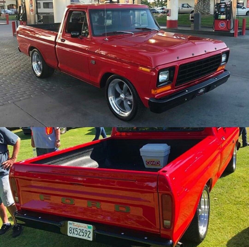

I was playing around with a gear ratio calculator the other day. If I go up to a 30” tire, I can bump up to a 3.73 rear and keep rpms below 3000...or right at it. I’ve been considering 20’s for a while, and could get a 30” tire when I do, which would still tuck inside the fender wells, if I picked the right offset. I really like how these trucks look with the old grey Torque thrust style rim. Like these in the attached pic. Also considering doing that with my front end if I stick to the 79 style...sort of wanting to find a 77 front end and go back to what it’s supposed to be.
