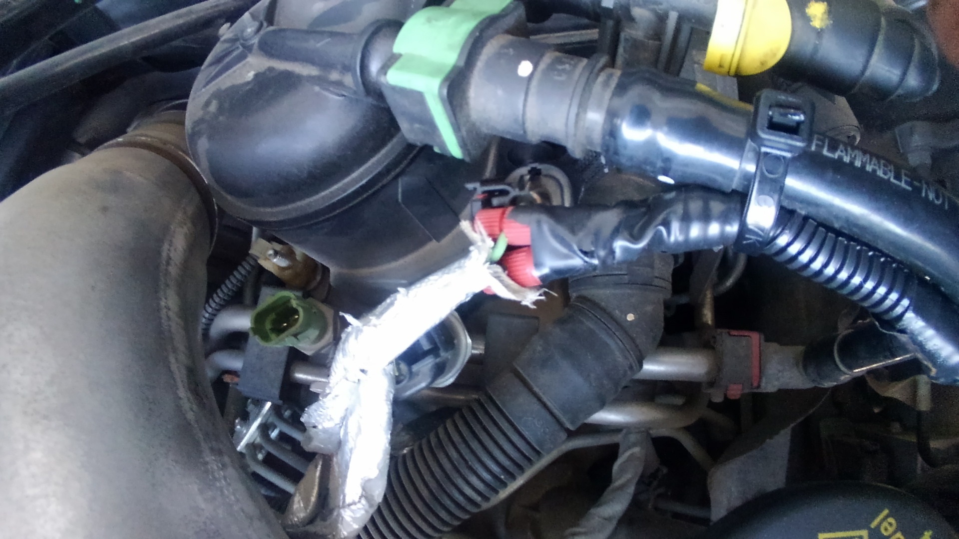

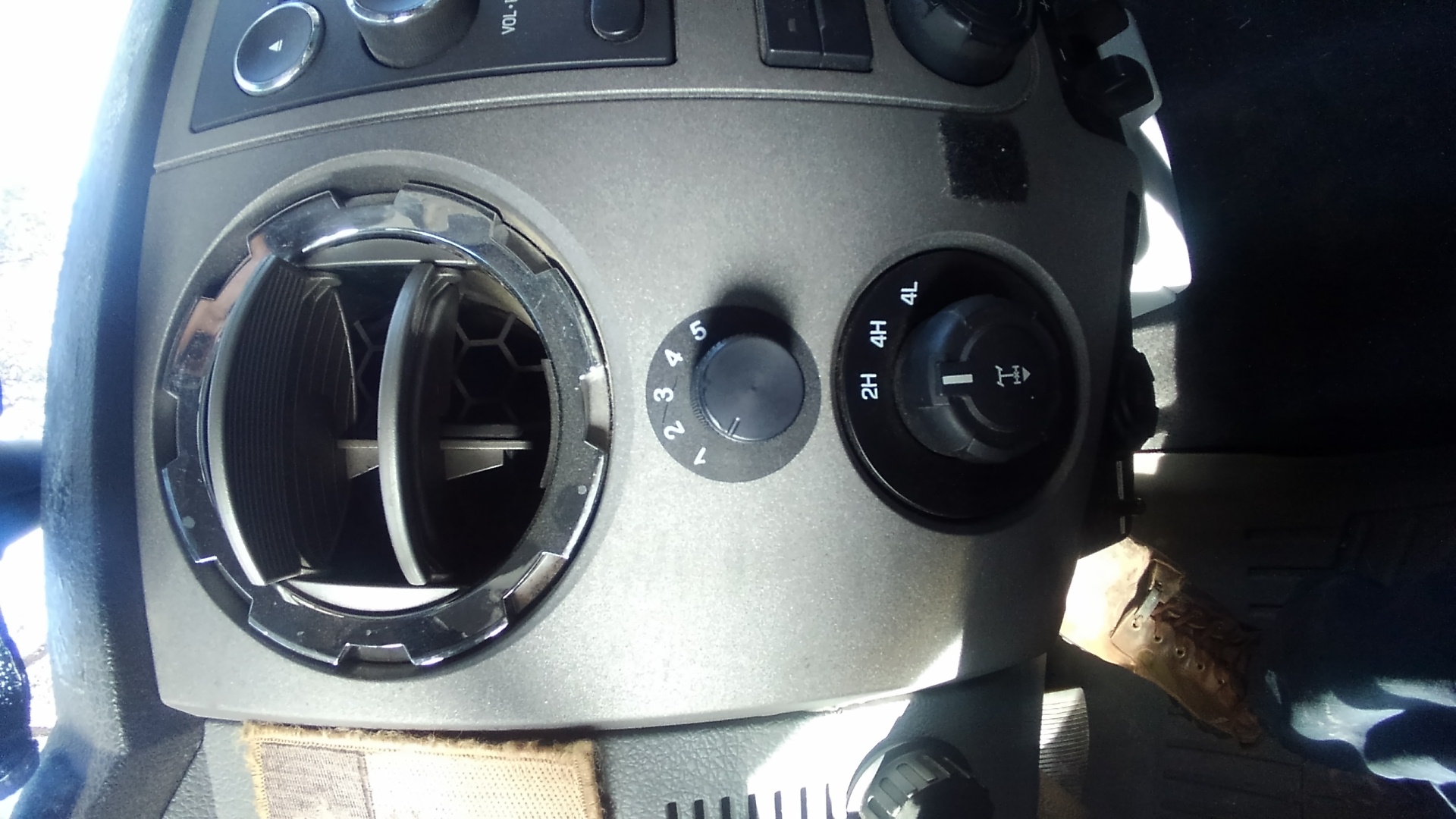

I just got finished installing the switch & loading the tunes on my Tuner. 0 instructions came with the switch as far as install, use, loading tunes, etc. The only thing it came with was instructions if you let the washer fall off to limit it to 5 settings again & how to test it with the small LED & button on the back. Did do the test & it was correct. I'm getting short, one worded responses from the place I purchased from. Looks like I'm 0-3 on customer service from diesel performances places.... :shrug:
Anyways, I went out & drove a bit up & down the highway as well as in town after having everything loaded & installed to what I think is properly. I can't tell if I'm getting changes between the power levels on the switch. I can definitely tell the transmission isn't shifting differently between the different levels.
I attached a few pictures of the install & what is now on my tuner. The file I loaded onto my truck is 11-12 SOTF 0-120 Stock Trans.
From what little the tuner has replies to me, I guess it means 0-120HP adjustments with Stock shifts? Next file would be 0-180HP adjustments with Performance shifts?
Sorry to be clogging up this thread with my ignorance.... just looking for some help to be sure I'm doing things correctly.
