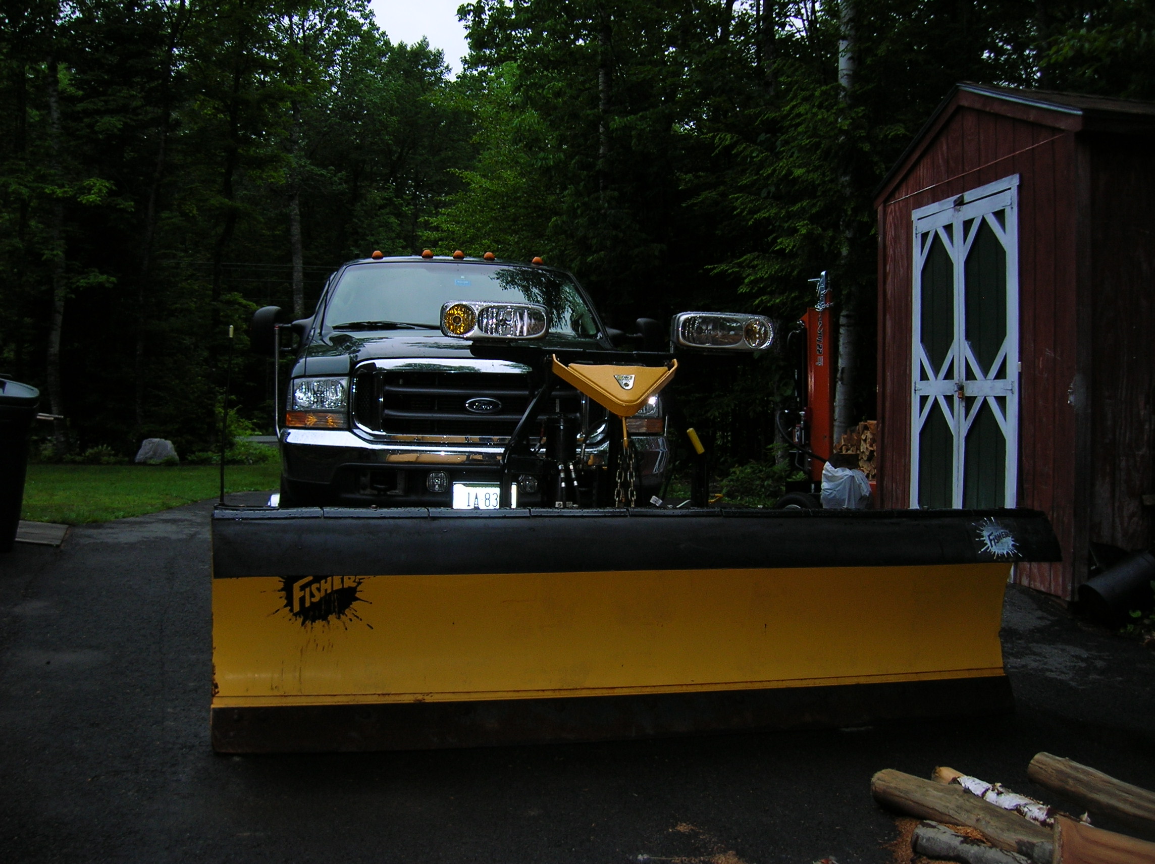

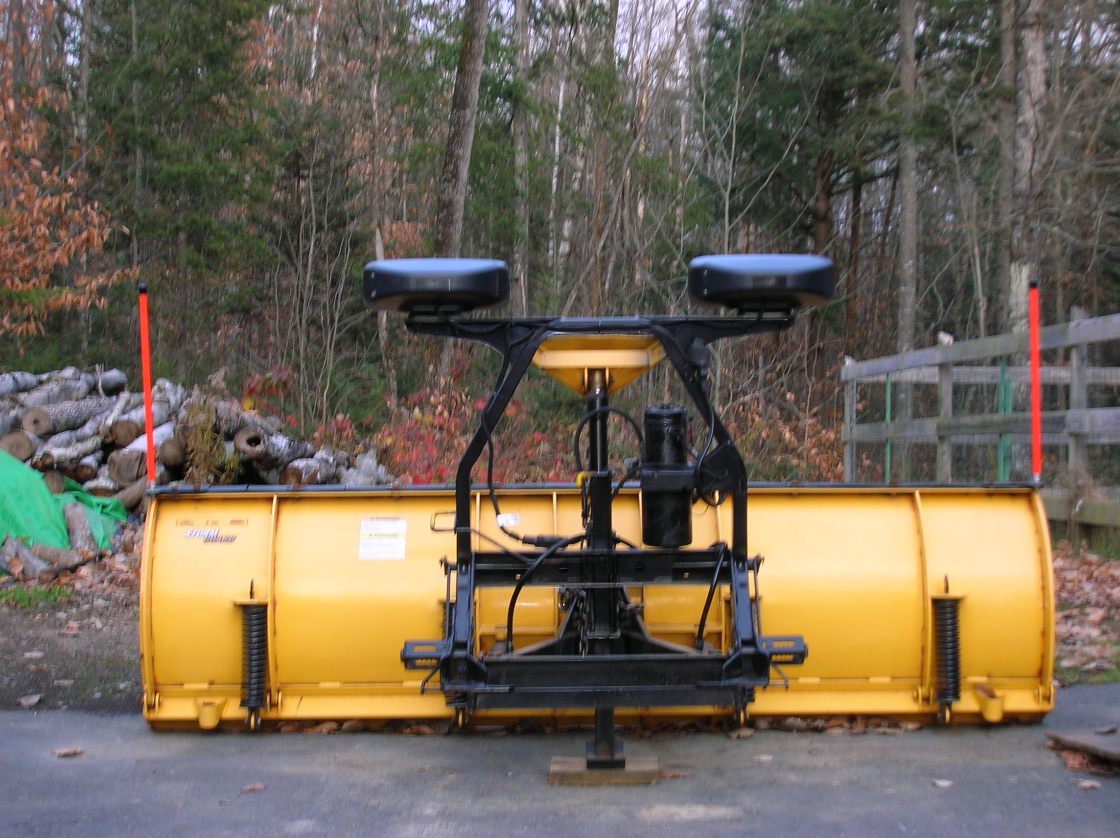

Cool.. I notice lots of guys up here rebuilding older plows.. Plow prices have gotten out of control in the last few years.. $5500 for a new Fisher is insane..
I bought this one (9ft MM2) last year from a guy in CT for $3 grand, it's like new and Fisher gets $5,700 for the same plow..
