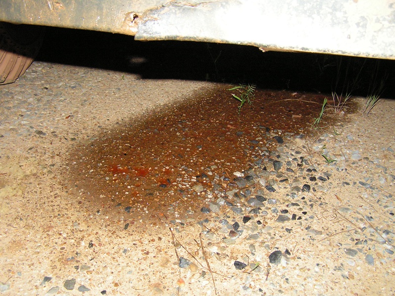

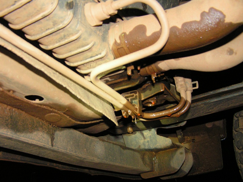

Ok this is a new one. I just parked the truck and notice antifreeze dripping from the front of the truck. So I climbed under the truck and its leaking antifreeze around the 2 hoses that connect to the radiator on the passenger side at the bottom. Also the corner of the radiator mount has antifreeze on it. I cant figure out where its coming from. Its dry above the hoses, both hoses look fine and they arent wet except on the bottom side. Anyone else had this happen?

Heres a few pics of the problem.
The leak seen from the front of the truck.
From under the truck.
In this last one you can see its dry above the leak.

^^^I hope you are due for a coolant flush. Maybe if you hit it with some brake cleaner you can pinpoint the leak with out pulling the radiator.

Its switched out to the long life stuff awhile back so nope not due for a change :(
Im going to clean it up good today and see what I can find. Just want to make sure thats what it is before ordering a radiator.

It could be leaking.in.front if something.went through the front of.the.radiator and running down and back. You are definitely gonna have to wash up under there to find it.

Clean it then pressure test it. My guess is its cracked at the little neck to the radiator that I believe goes to the Degas bottle.

Well since im pretty sure its not a hose Im going to order a new radiator tomorrow. Better safe than sorry. Just didnt want to replace it if it was just a hose or something but I cant find anything wrong with those and cant find any cracks in the radiator itself. So I'm replacing the radiator.

Well the radiators changed out now. The leak was coming from where the plastic tank joined the aluminum part. Cant find the exact spot as my son didnt move the radiator before I pulled the truck forward so its kinda beyond diagnosing for sure now :D
