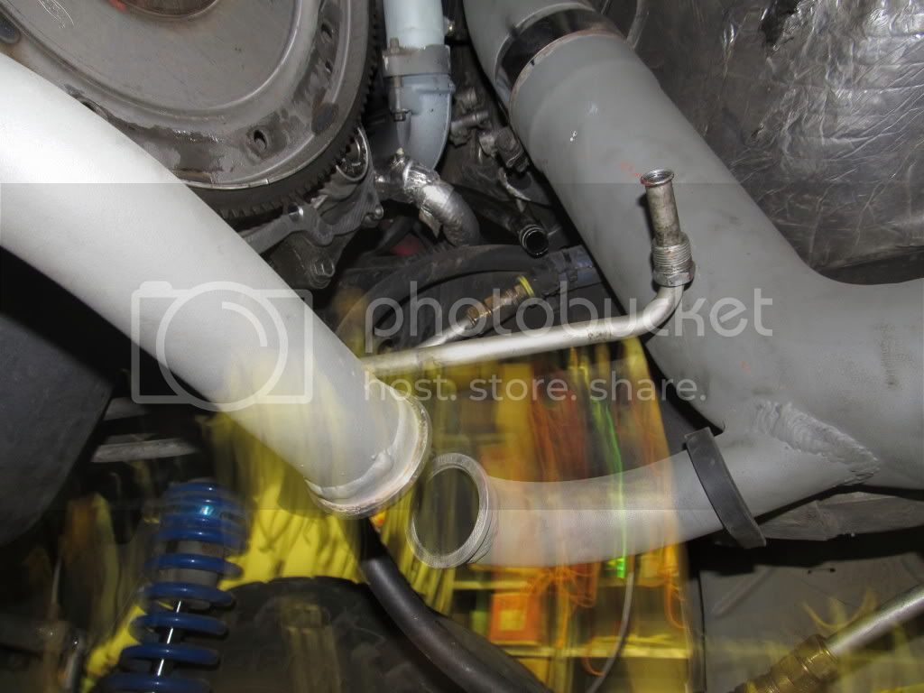

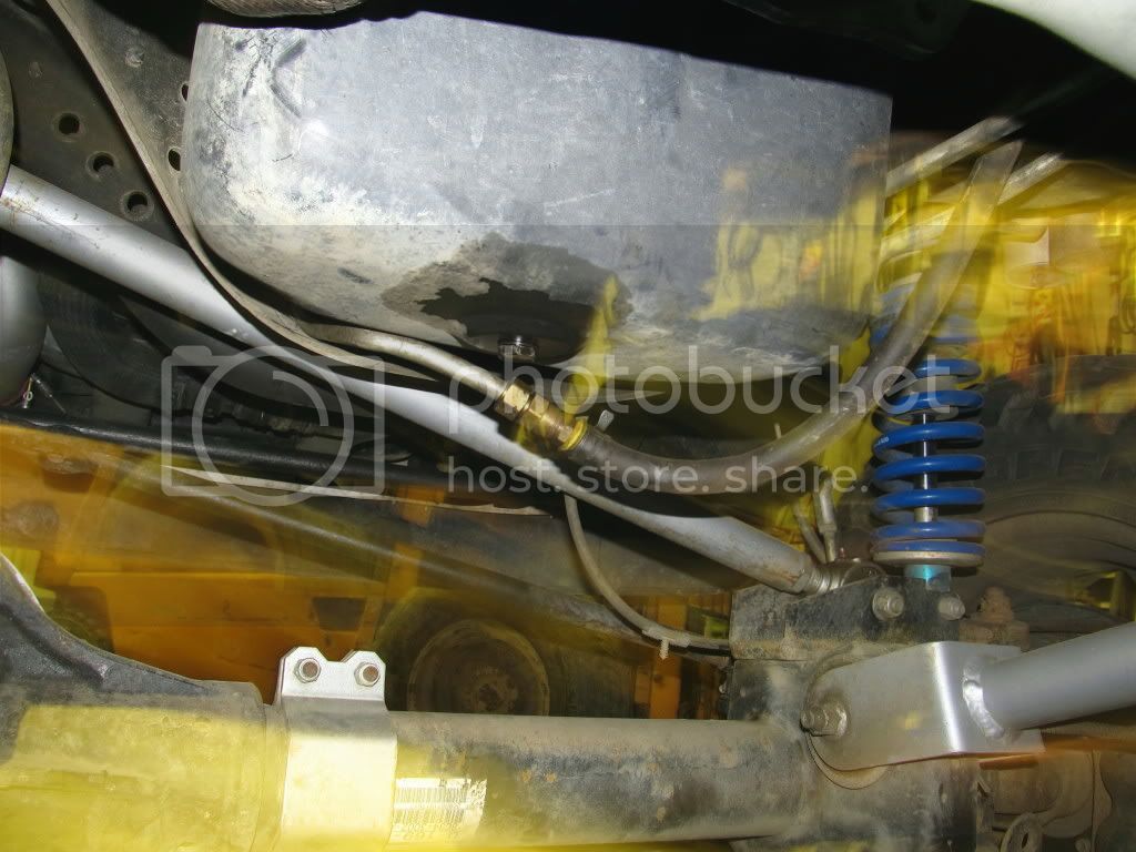

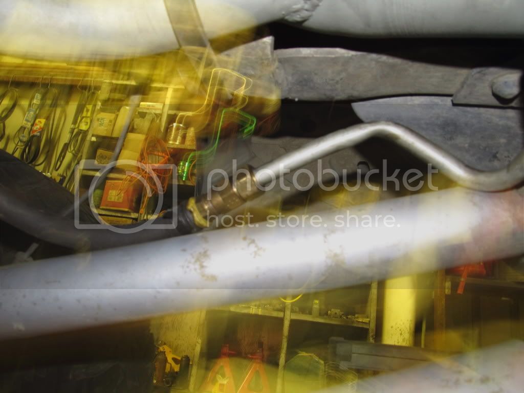

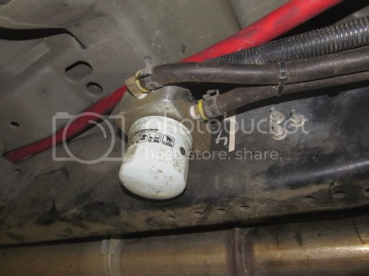

Hope these help, sorry about the yellow lines(?) may have been set on wrong mode.

so the elbow with the 90 goes to the cooler and the one closest to the framerail goes to the trans?

Metal from the tc would still travel through the trans, go to the cooler then through the extra filter. It should stop it from recirculating through the system. There was no metal in mine from the failure, I haven't yanked the filter yet to see if any metal is in there.
