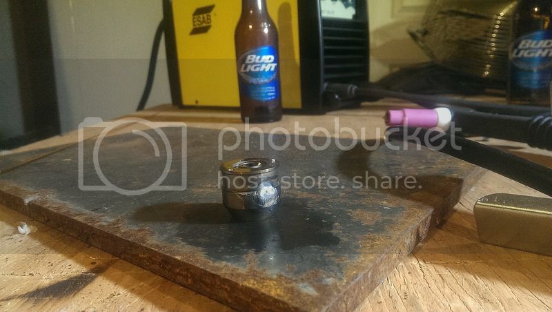

One barrel welded up. The lift tig is a little tuff to get the hang of I still want a pedal lol. After plugging the port the plunger still easily slides thru the barrel. I have 11 more I can weld up gives me some error room and I can pick from the best. I do have 200% nozzles for the frankenjectors.

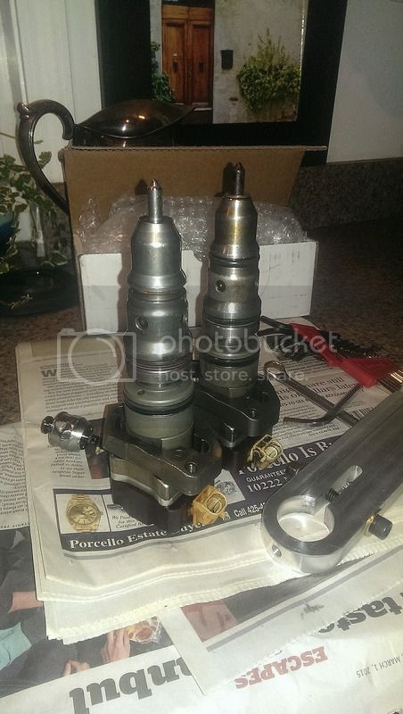

One stick of dynomite assembled...progress is slow going when you work 7 days a week lol. I may get these on a flow bench when they are done. Currently talking it over with a local vendor that has a bench. These things sure are fun to put back together...

Well I've welded a few barrels now. Getting better with every one. All are a go except one is a "not too sure bout that one" I hit it with too much heat and the plunger was very tight until oiling it up and working it down the bore quite a few times. I'll just set that one a side. After pulling injectors out of their shipping boxes I discovered I actually have 14 injectors and one is new. It's tricky welding these with a lift arc machine. I have it down to strike arc, feed the filler fast, one one thousand pull to kill arc and push back in for post flow. Let cool completely on a heat sink and repeat until sealed. I did start ordering parts for E fuel. I purchased Cat 175-2949 water separator for pre pump and the 1R-0750 for post. Still debating over dual SD or A1000?

Cool. For a chill plate, you want at the very least an aluminum plate or better yet some copper. Steel doesn't have very good thermal conductivity relative to those two materials. I'll show you the one that I use when I get to work today. Also, build yourself a third hand that doubles as a ground like the one Jody uses on WT&T. I couldn't find a good pic of his but here's one with a sliding weight.

Yeah I didn't have any huge chuncks of aluminum around. The steel plate helps but minimizing the heat with the Welder is helping the most. If I actually had a higher end unit with pedal control this would be a lot easier. For what its worth the chinesse ESAB box ain't too bad for light use. For the ground I was just welding this up with the barrel directly clamped.

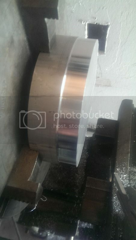

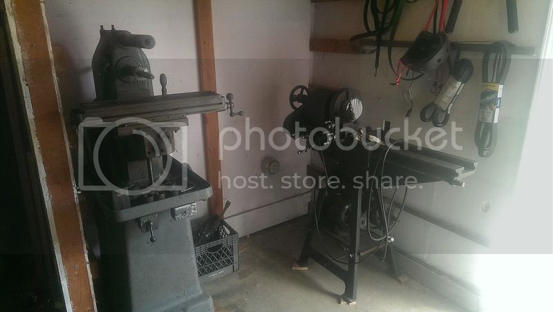

Nothing to see here really. Just getting back to this project. I have collected a couple of lathes and one knee mill to help projects along. Started turning the larger crank pulley adapter.

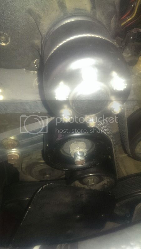

So under colder conditions I was getting belt slip until the engine warmed a little. So I built an idler to better wrap the blower pulley. Now there is no slip and I also found out that as rpm increased the belt was slipping past the blower pulley. I could never see more than 6 psi (in neutral) for example turning the engine to 3K (in neutral no load) now the blower outputs 12 psi at 3K. I also ditched the small electric fan and went back to manual. Towing it was getting hot and I may find a larger electric fan as I did like the faster warm up with an electric fan. I still need to someday install the honey badger Sr pump and fuel system. Maybe this spring when the weather improves.
