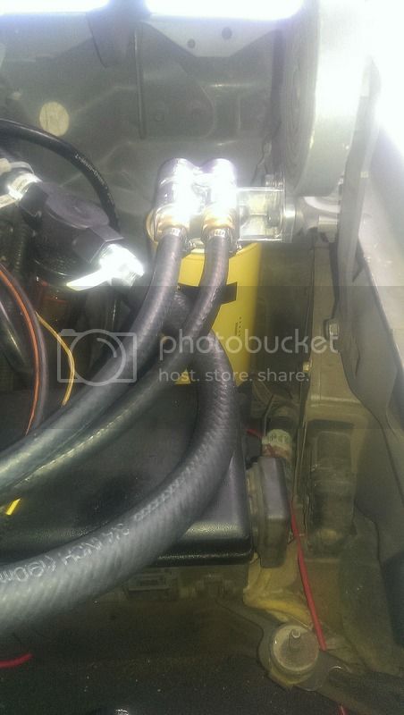

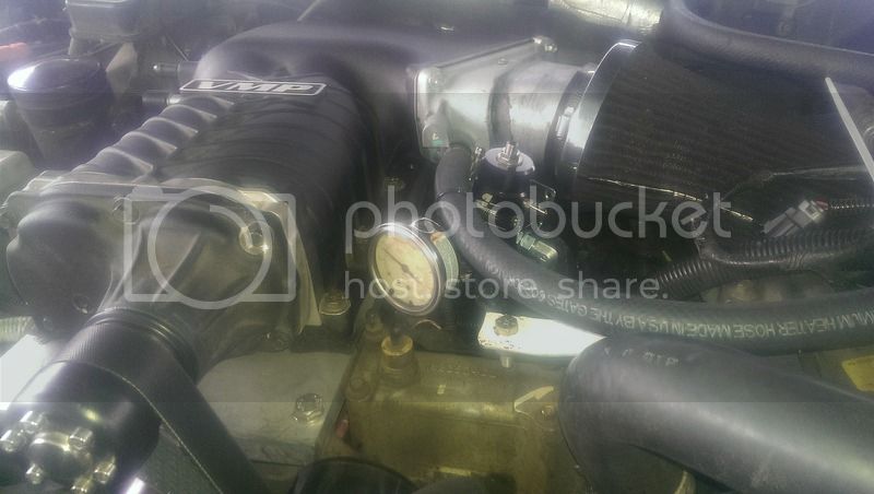

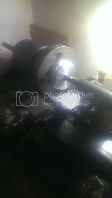

Well over my Christmas break I did turn on the larger pulley adapter a little. I am in no hurry as the blower is working just fine. This morning I ditched the fuel bowl for a 10 mircron CAT filter and added a regulator. Stock pump is growing weak. I plan to replace the stock pump and then add one of the SD pumps I have on another feed circuit so it will be fed with a mechanical and a SD pump. I may add a sump or install a second pickup line.
Now that the bowl is out of my way I can install the Honey Badger SR and then injectors.

What's the part numbers for that filter set up you have? Trying to figure out what I'm going to do for a fuel system
Sent from my SAMSUNG-SM-G900A using Tapatalk
Magnum PD
9,566
8
VA
wix/napa
bases are 24770/4770
pre filter 33406/3406
post filter 33674/3674

dont do it that way. if you are doin a fuel system then get a superduty pump with pre and post filters and regulated return.
Wix # 24770 Napa # 4770 for the bases.
