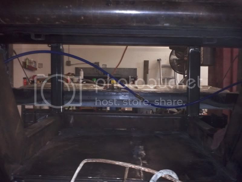

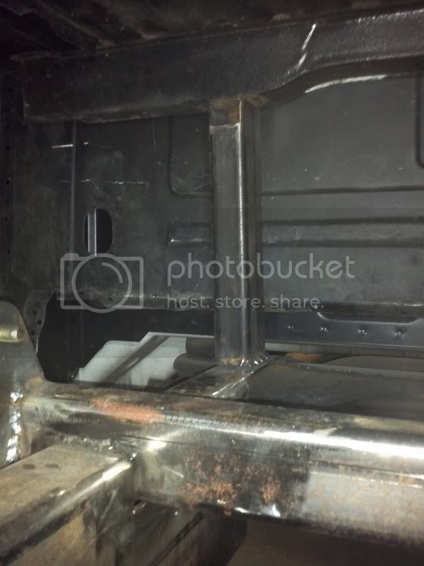

finally got the 4 main bed mounts built
did the front passengers side first by reaching it threw the stack hole in the bed
pic taken under the truck looking tword the cab after tacking in place

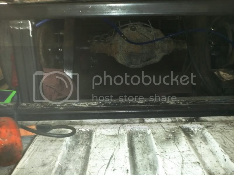

measured out the drivers side front but couldnt get under the truck to install it
so on the the back

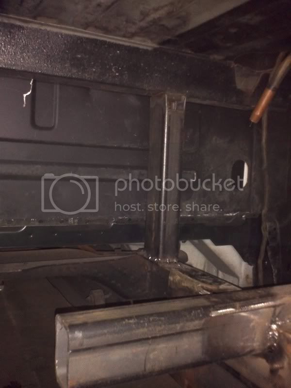

first i built a cross member under the bed welded that to the bed floor
then the uprights were made and welded onto the frame
pic taken from under the truck looking out the tailgate

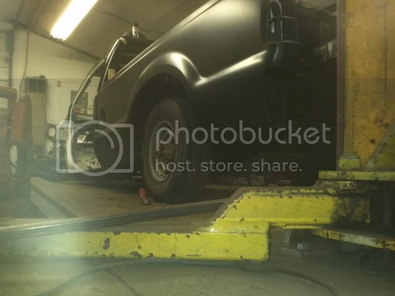

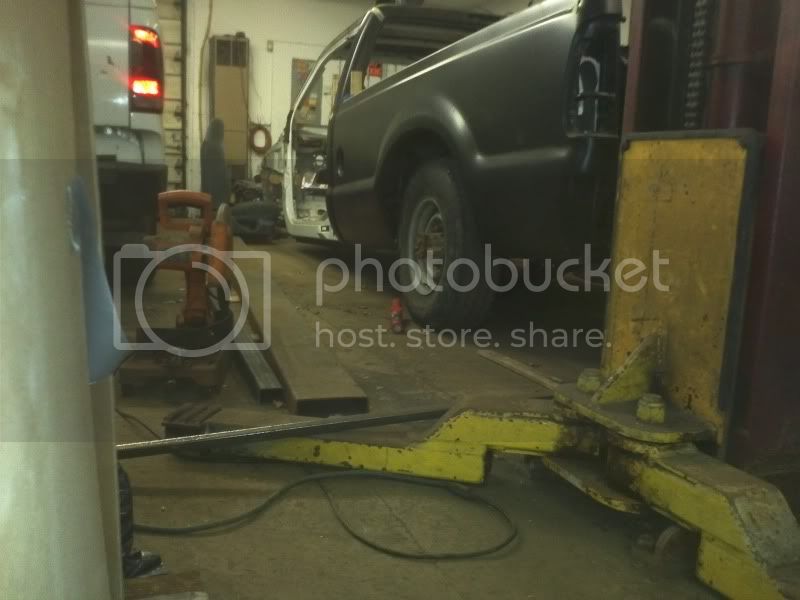

some random pics
me sitting where the fuel tank belongs welding the back two uprights in place

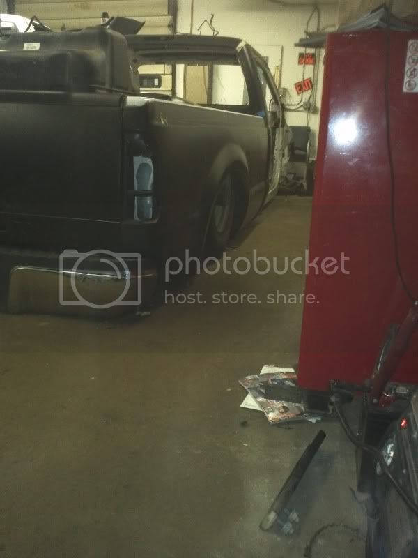

looking at the rear axle from the tailgate
high rider

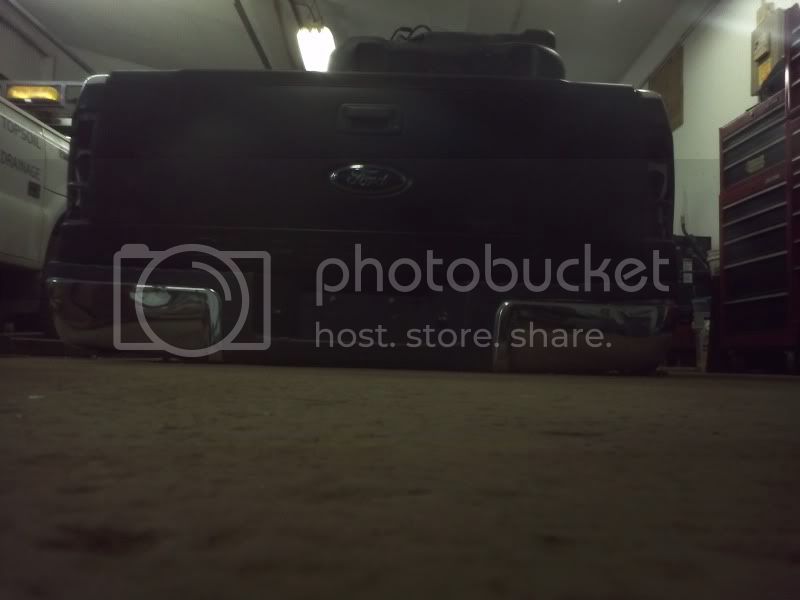

some pics of it laid out
Bumper???

I'm pretty sure a roll pan wouldn't last post the first drag session

The fabrication master that you are, I'm sure you could make something solid that would be just a tiny bit below the bottom of the roll pan so that it'd drag before the roll pan would. I do like the bumper on there but also think a smooth rear would look cool too.

I kinda feel like a super duty with a,roll pan and this low would look like one of those fat chicks that some how have a completely flat a$$

What if you put an off raod rear bumper on it? something simple with no lights or hooks or foot holes, something different.

I vote rollpan on this, I love the progress you're making man it looks awesome! what are your total colors and did you decide on a wheel yet?

i looked at it again last night and i think at some point ill order a metal roll pan and see which i like the look of more

I like the idea of the bumper, specially to have the chance at catching people off guard before it gets laid out and makes sparks fly.
