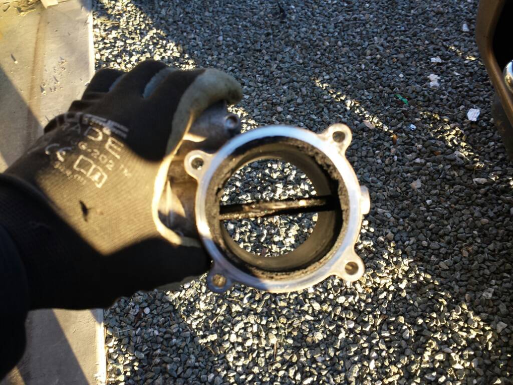

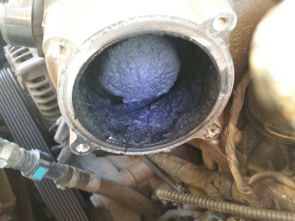

to OP and anyone else. This is what I found when I went in there. This is past the throttle body. Half of the throttle body was caked up like this also. Looking into the manifold was obviously black but not caked on too bad. Cleaned it out with a shop vac and some brake clean.
So I removed the valve, and aired up my tires an extra 5psi. Reset the computer and still says 14.3. truck feels a little better in the pedal.
and Cleaned out
How many miles where on your truck before you cleaned that chit out of it?
