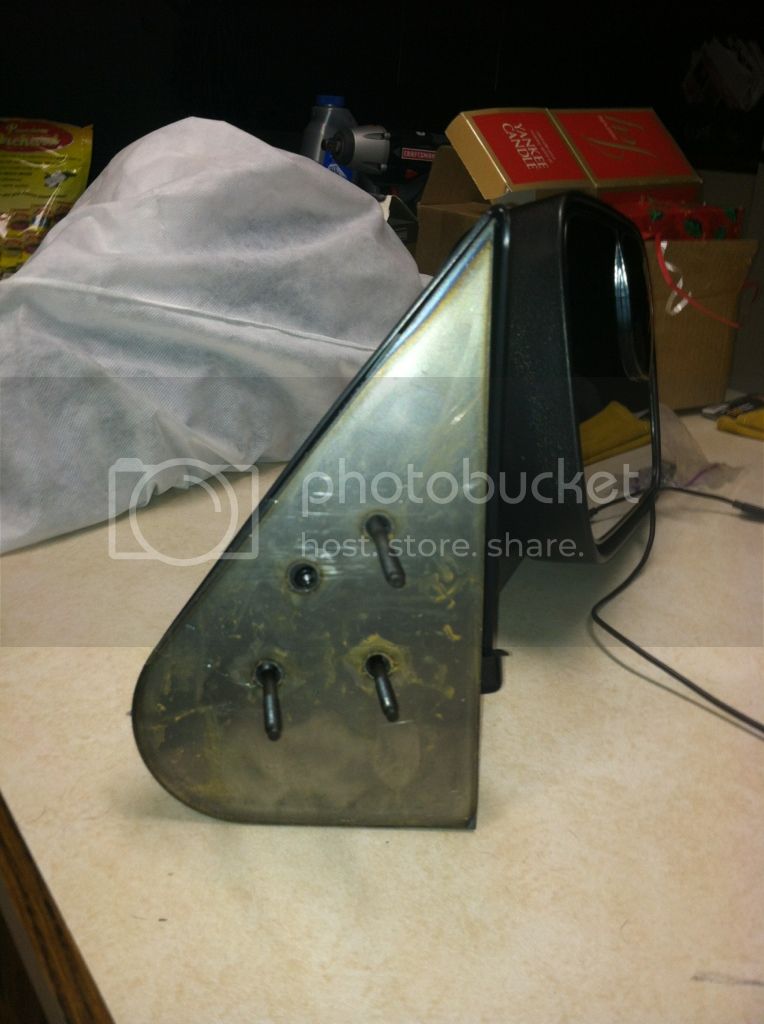

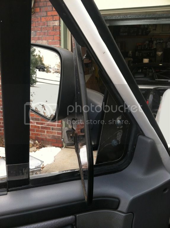

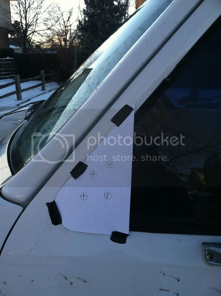

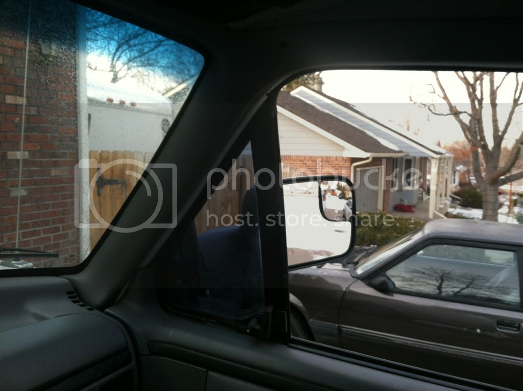

Ill show what the wing window looks like from the inside open fully once I get it installed tomorrow completely.

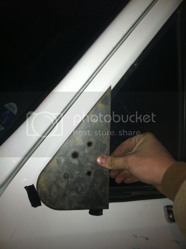

I did cut a few extra sets while there.
Just slid on for alignment purposes.
More to come tommorrow!

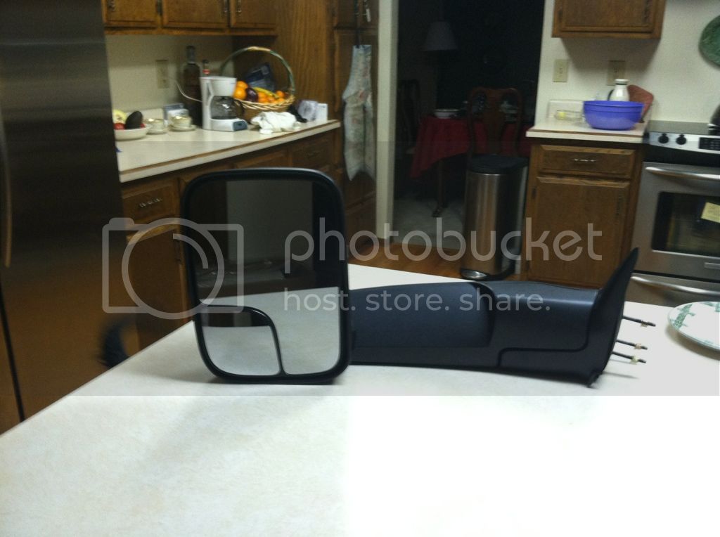

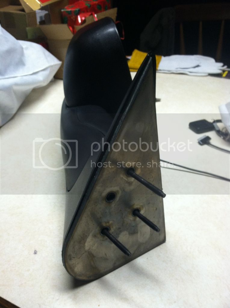

I am going to see how these ones mount and look. If it is what people like I can cut more. If not I can modify the plate a bit and then have them cut.
I got the one side tig welded in. Going to start the otherside after lunch.

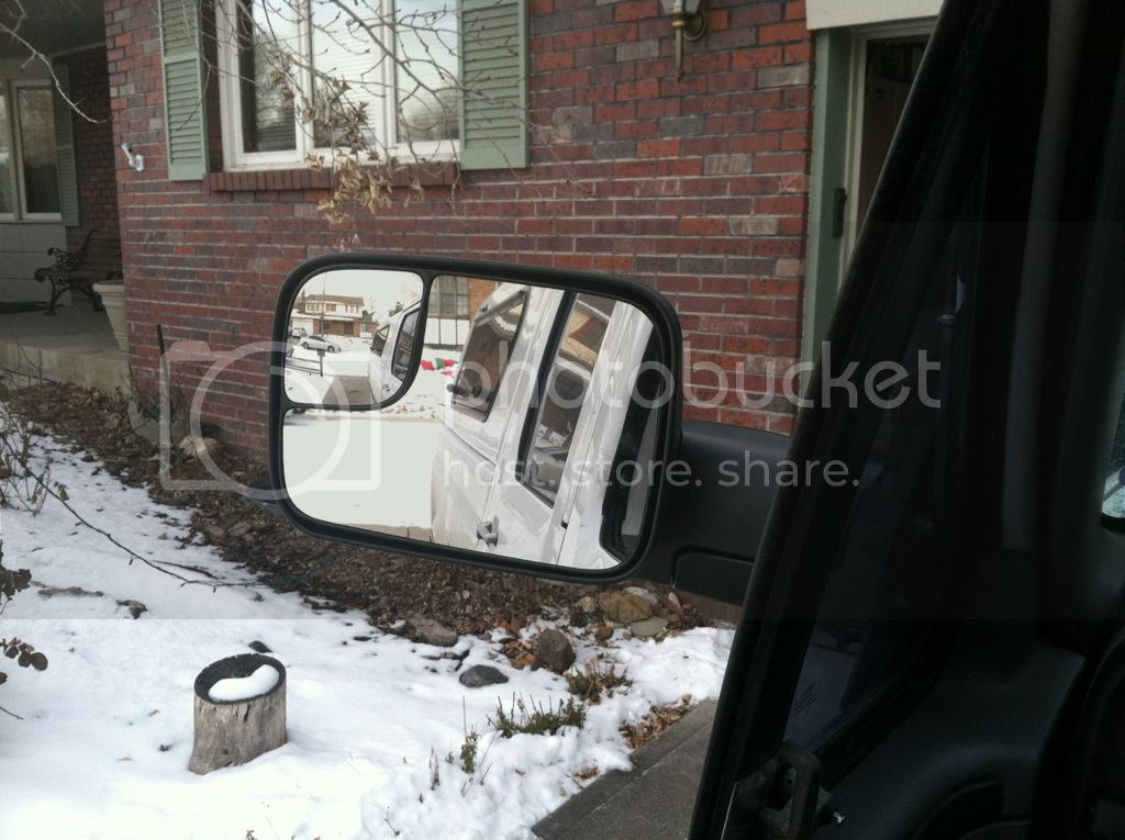

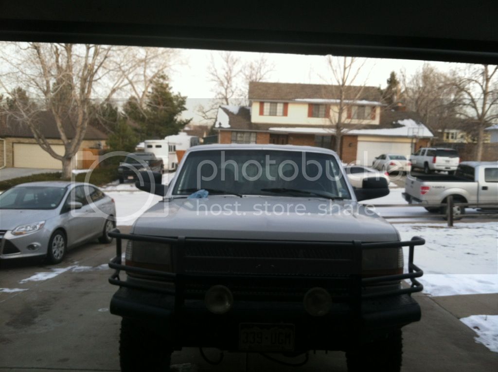

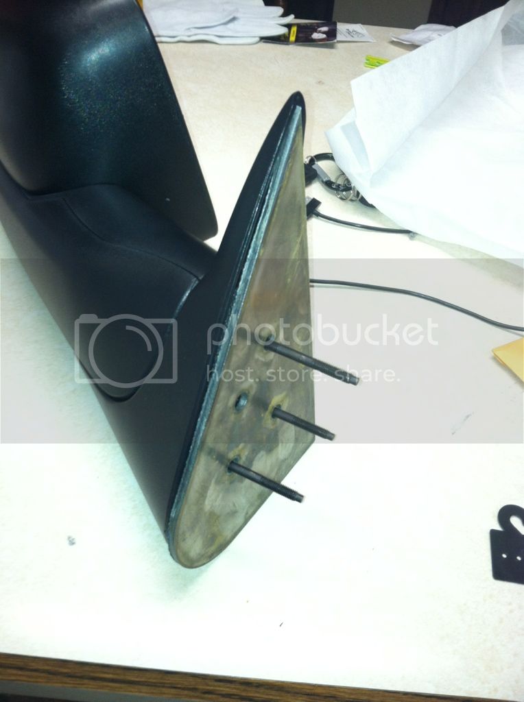

ill have to do the bondo and paint once it warms up some. But here they are.
Ill try and get some better pictures tomorrow! The furthest forward bolt is hard to get to, had to make it a stud and put a nut on it, the other two bolts are visable from inside the truck and easily tightened from the inside with the wing window open.
