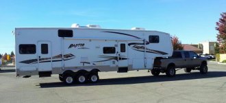

To me it seems there's something wrong with the truck whether boost leak, clogged intercooler, or any number of other things that could be wrong.
Just as a reference I pull a Raptor 3612 Toyhauler which is 38'. Truck is lifted, on 37's with a tuner and some light mods. I'd look to fix the problem rather than just buying random new parts at it.
Jason
2,320
Somewhere down in Texas..
I know you had cauht flack over it awhile back..but that's a slick looking setup...despite how top heavy it looks...how tall is it to the roof again?
I agree on the checking everything before throwing parts at it. My stock turbo made 28-30 in Matt's tow tune, and 30+ in my hot tune. And towing 20k lbs in his tow tune, it was stupid easy to stay under 1200°
That toyhauler dwarfs that truck. That is not.a.small truck at any rate. Ive towed a ton of crapwith the same suspension and tires with simply a single 100hp tune. A guy could.get into deep doo doo pulling something heavy with 450+hp. Especially in a torquey motor like a.7.3.
People with stock equipment think.stock isnt enough but 90% of.the.time they arent getting max efficiency from the stock setup. Boost leaks, worn turbo, stock exhaust, etc.
The stg 2's towed awesome with the 38r but you dont need to.burn the.tires while.towing, lol.
The trailer is about 13'10" so it's just a few inches under legal limit. It tows great. Just have to really watch for branches and be selective what gas station you pull in to. Towed over the Techachapies a few times as well as other areas. Never been in a position where I even started to feel uncomfortable, even when off road on hills or sand dunes.
i drive truck and out here on the east coast the legal limit for hight is 13.6... if your 13.10 then dont take the toll road in MA..alot of there over passes are 13.9....
It's 14' CA and NV which is about the only places we would go.
I should also mention I have DP tuner with 4 tunes. The truck tows great on "1" which is the stock tune and "2" the tow tune. Both do well, obviously 2 has a bit more power, and controls the trans a bit differently. Still on stock intercooler which will be upgrading in about a month.
