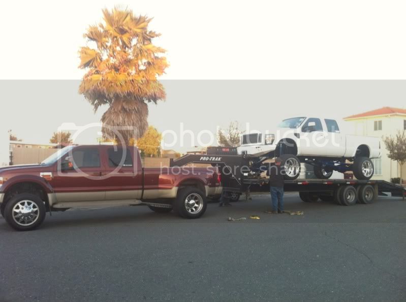

My 2012 dually does the same thing when my gooseneck is really heavy...
weekendwarriorfsw32
1,626
Central California
My 08 F-450 has them and they were one of my favorite mods still to date. Helped a ton with towing heavy.

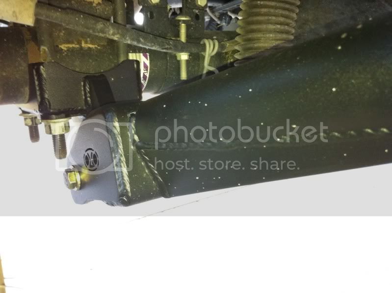

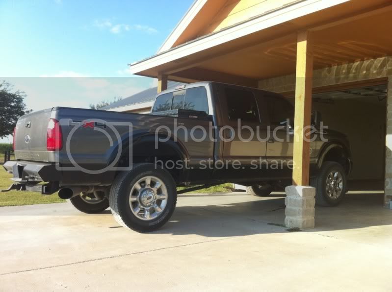

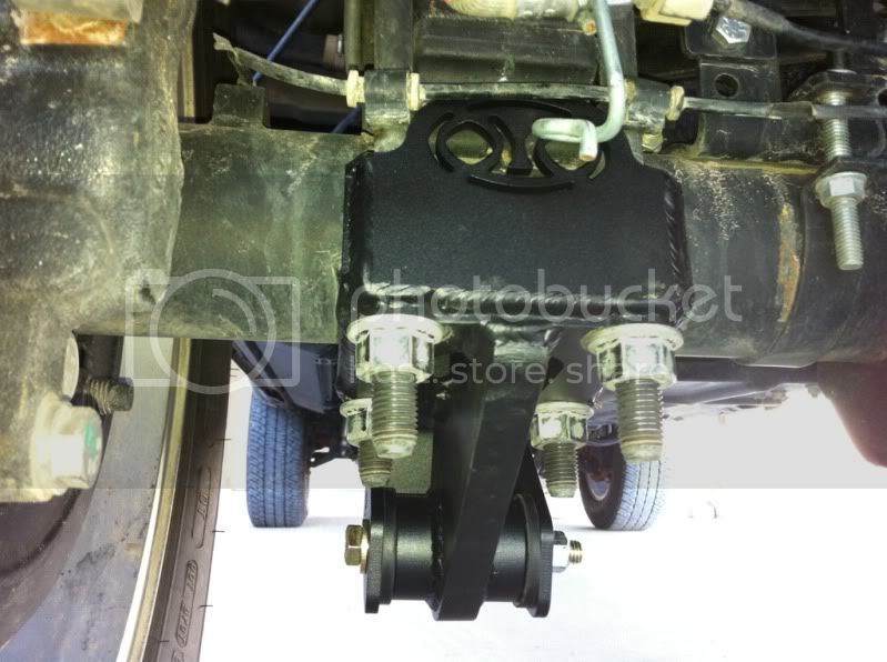

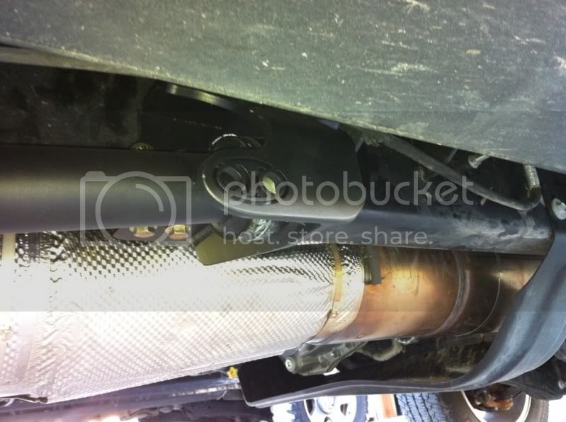

Not the best pics but it gives you an idea how the bolt on bars look.
