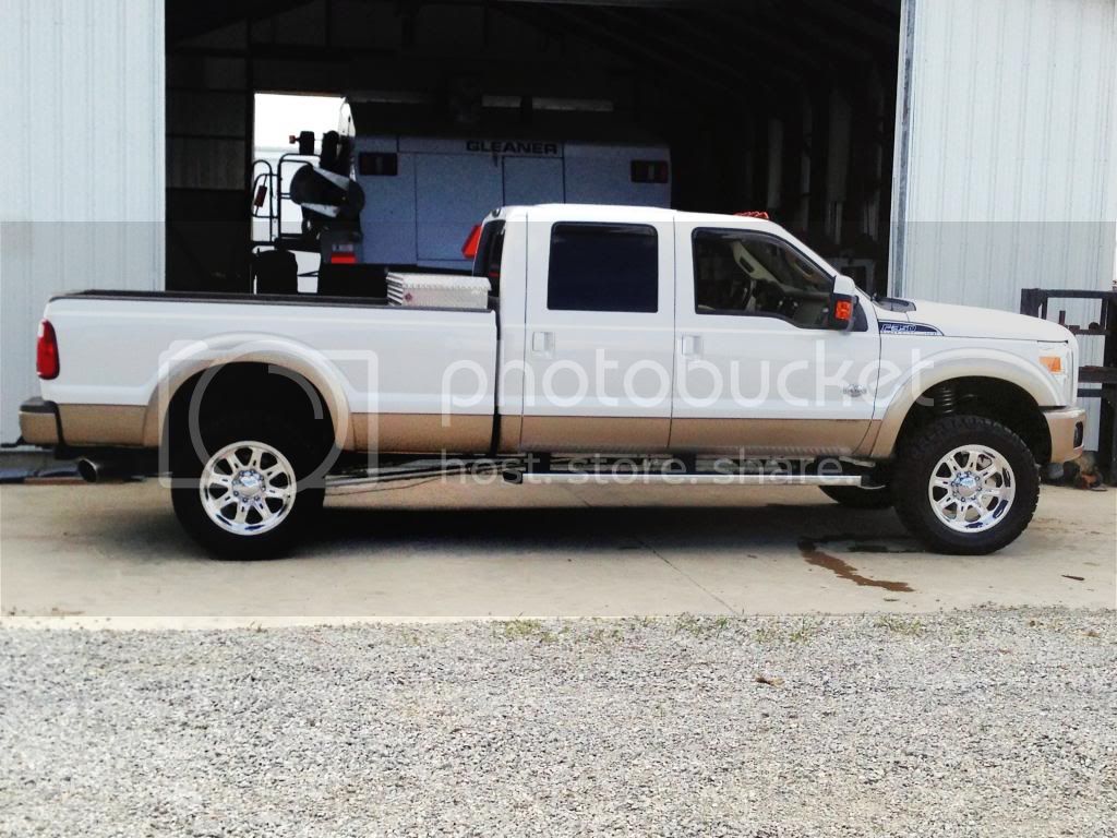

Is there anything being done to recenter the rear axle? On my '12 F350 (rear suspension is stock other than shocks) it's visually offset towards the rear of the truck (looking at the fender well.)
I've seen other '11+ trucks and all look the same so it's not just me.
I run mine one pin forward to recenter the axle in the wheel well. With the stock blocks my wheels were pushed towards the rear too.
These are 5" traction blocks with the long gusset bars
