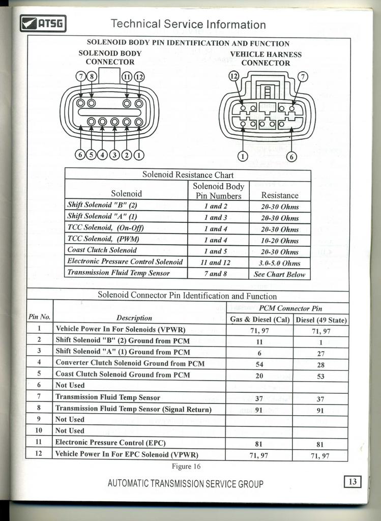

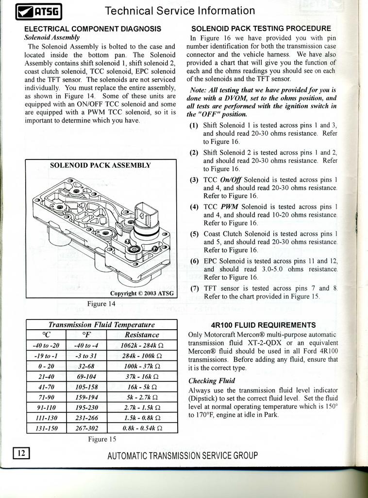

heres the ATSG pages for troubleshooting the solenoid block. on edit, we have the PWM version
