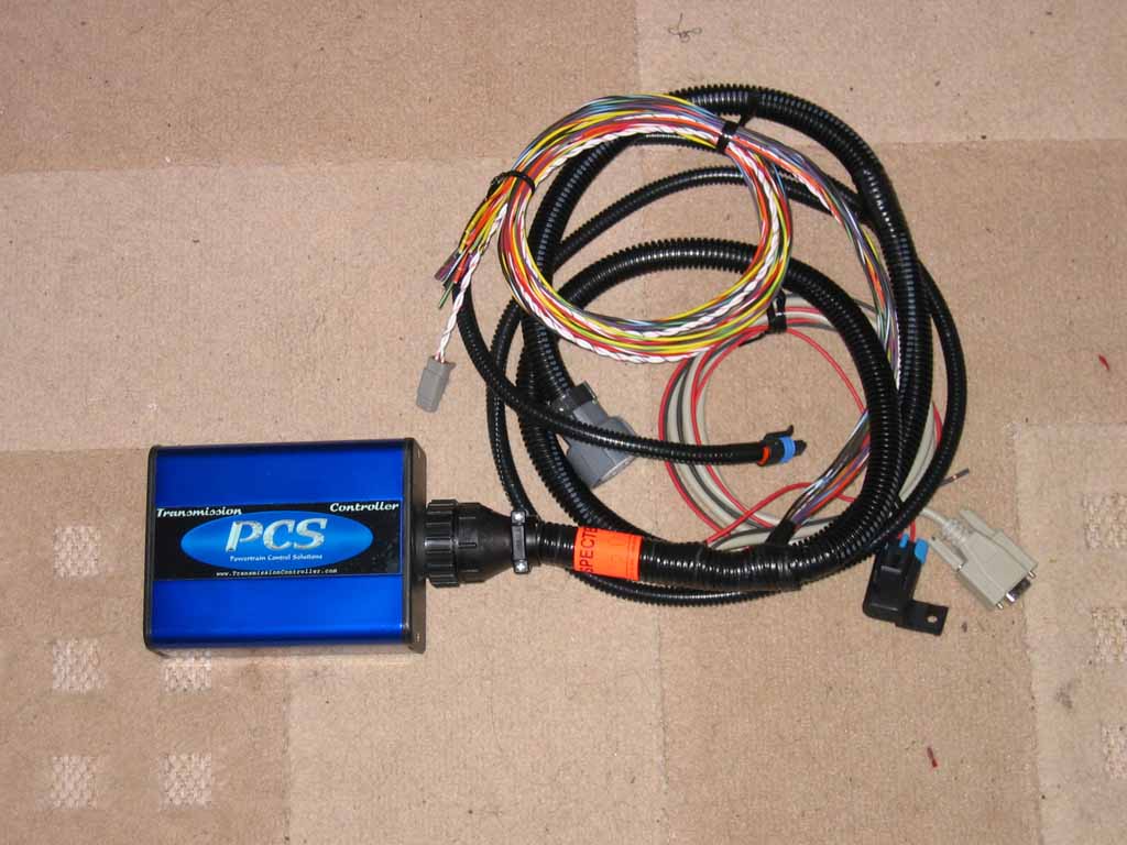

Working on the GV setup I started looking at it a different way. Got forwarded to this guy,.
https://www.ebay.com/itm/142482832692
He is saying that this unit will take the AC input from the Vss and I can set the trigger point wherever I want. Like 70mph. Problem is that it will shut off at about 66mph, So I would need a second one to set where I want it to disengage. Or a line condition to change the frequency to a rate where 5% hysteresis equals approx a 20 mph split like I want.
Fun stuff either way. Excited to give it all a shot and a fairly simple way to automate it all.

PCS should run a GV no problem. The PCS just wants to know how many gears (in that case 5) and what solenoid order you want to use. I imagine a person might be able to have the PCS pop the GV on and off and split each gear automatically if they wanted. Is there a reason you aren't looking into it? Probably the best controller available for either of the transmissions you are referring to. I use them for all sorts of things. The trans, but also multiple wastegates, water injection, secondary fuel pumps, temp monitoring, datalogging. Very powerful tool. They have two calibrations switchable with an input.
PCS is one I would still like to call but if they are like any of the other tuners they don't actually control the solenoids and do not have outputs to control solenoids or relays. They simply load their software in place of what is already in the PCM
At least that is how it was explained to me.
Charles
2,729
47
No.... it is a stand-alone trans controller. You literally tell it which outputs go to which solenoids and what order you would like to fire them in. I run my EPC valve based on MAP for instance.... not TPS. My trans is nearly always spot on with shift firmness this way. You can do just about anything practical with a PCS. I used to independently run the gate on my GT55 and the gate on the 38R with PCS PWM outputs based on two independent pressure sensors, one for each stage, while also kicking on the water injection at XX boost and kicking on the second stage water nozzle at XXX boost, while holding a manual shift controller in my right hand on a short extension harness with manual/auto toggle and shift up/shift down buttons on the little handheld remote. On my crew cab another one is currently wired to kick on my second factory fuel pump if the main pump drops below 50psi...
It has various digital and analog inputs and outputs and most certainly drives the trans solenoids, wastegate valves and relays directly. I have used them for years. The original. I have not used the newer unit. I still have two of the original units.
We run a pcs in our race truck, as we’re running a 4R behind a 6.0. It is standalone, has a ton of inputs/outputs, can switch tunes, run data logging, all sorts of fun shit. You are the tuner for it, if it doesn’t do what you told it to do, chances are you didn’t tell it correctly. Hell, we typically run second gear starts, it’s never in first, but one of our transmissions has had an issue where it blows thru second and neutrals out, so we’ve run third gear starts before. We have a burn out tune on a switch, that switches back to our normal trans tune after I put it in 4wd and flip the switch back. We’re data logging boost, back pressure, icp, fuel pressure, and all the trans stuff thru it. We still have about 5 inputs available and a whole bunch of outputs. Probably have no issues running a gear vendors off it.
