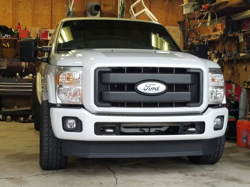

Been on the fence about headlights forever, decided to try some cheap ones off of Amazon. Ordered LED heads, fogs, and switchbacks and actually really like how it came out!

Once you go LED you will hate driving the old style. I run LED headlights on 2 of my trucks. And the one has Rigid fogs, it's glorious!
