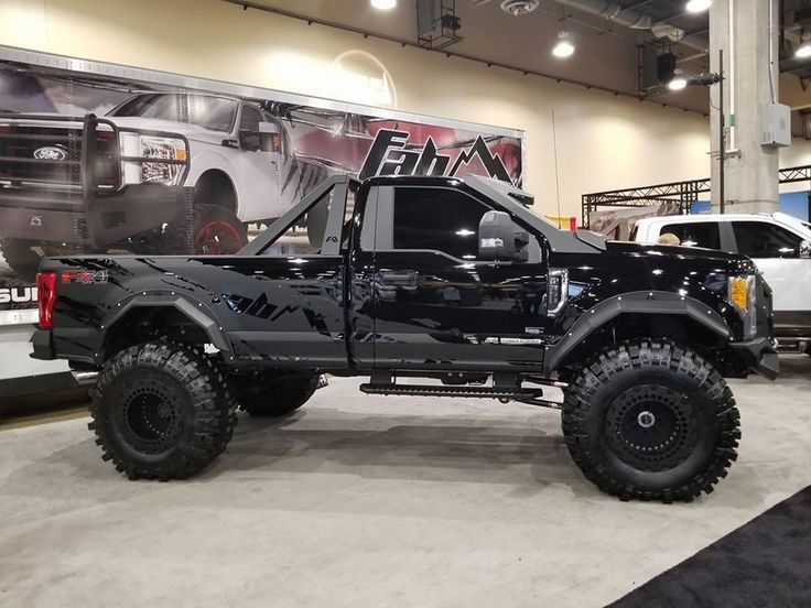

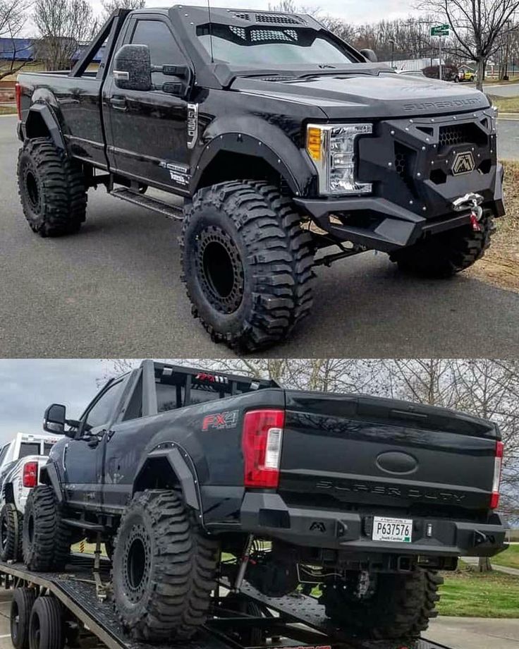

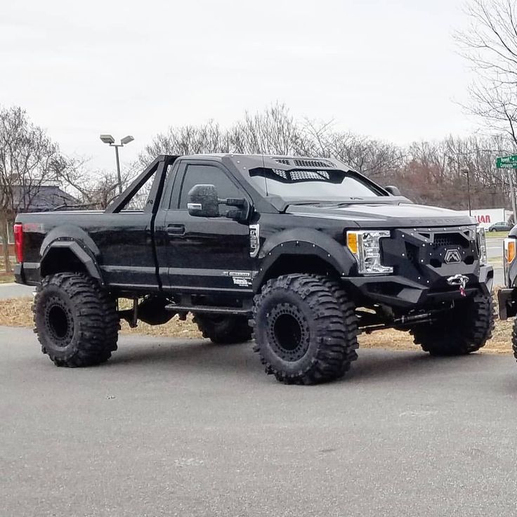

looking for some decent wheels to go with my 44 boggers i have been looking for some good drw, 10 lug specifically, beadlock wheels and preferably like the ones i attached below in the pictures, thought those looked pretty damn good, anyone else have any opinions on good wheels for some 44 boggers? this is all going on my 97 ford f350 xlt crew cab long bed dually v8 7.3

i dont even think he understands what rim configuration has to happen to enable dual 44" boggers. I have seen it done but it sure wasnt hwy legal nor conventional means!

Sounds like you aren't looking for street legal... Which is good because I'm not sure that's possible. ��
With that being said, a lot of it depends on how hacked together you're looking to go, what your goals are and preferences for beadlock styles too. I run srw 8 lug, but rigs with both true weld ons (with 44" boggers) and recentered hummer wheels/cheater style with PVC inserts (37" tire). They both have their benefits.
One thing with recenter wheels or anything you get from most of the off-road companies (trailworthy fab, etc)... They are not meant for Highway use. They serve their purpose, but don't always balance out great at higher speeds.
Any reason you're dead set on drw? It wouldn't be first choice off-road around here for a number of reasons.
