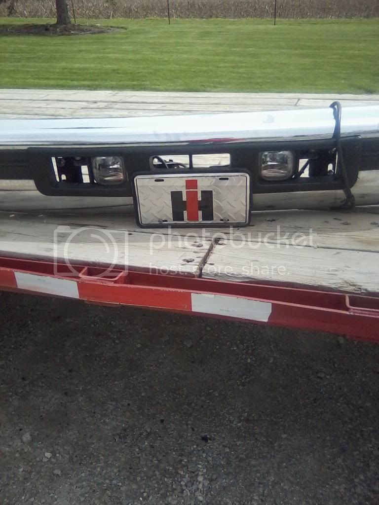

But next i'm going to mount and wire up these

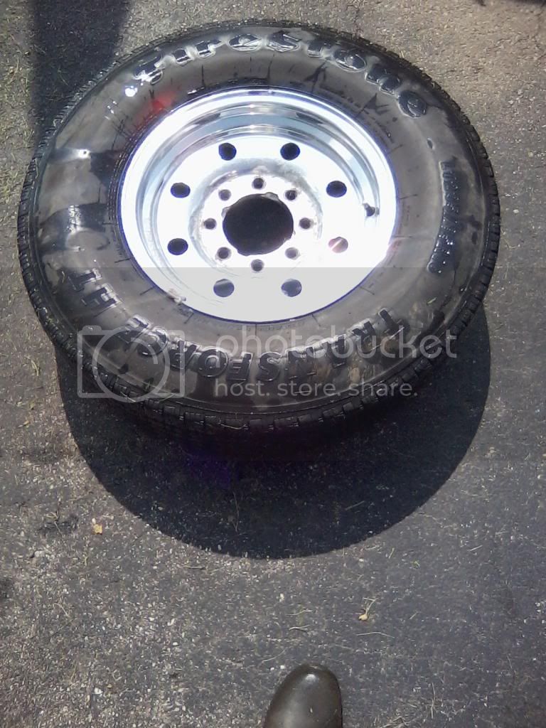

Haven't polished em yet. I got a spray can of paint stripper from Napa, sprayed it on, let it sit for 10 minutes or so, rinsed, off, and repeated until it was all off. I bought 2 cans, but didn't even use a whole one to do all 4 rims. Just getting rid of the clearcoat made a huge difference. And if it wasn't for the damn corrosion in a few spots on my rims, i'd just give em a quick polish and run em.
Not sure what i'm going to do to clean em up though, prolly have to sand em.
Here's a better pic.

Thanks you! They will look really good after you are done. Right now i cant stand the way my rims look with the yellow look to them.
That rim is looking good already!!
