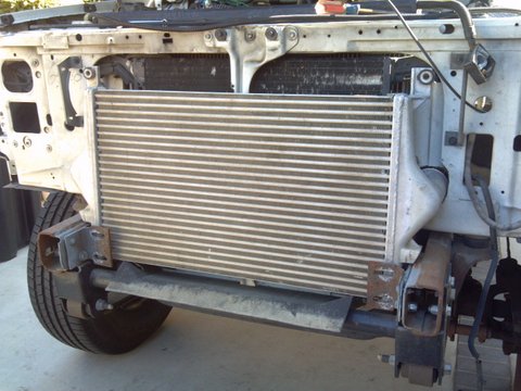

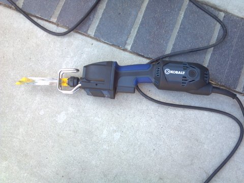

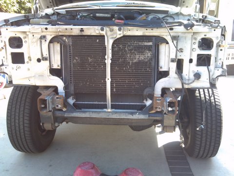

What do you know, I squeezed some work in today.
It took me an hour to strip down the front end.
Then I used the Kobalt recip saw and cut the holes in 30 minutes.
It took a little tweaking to get the I/C in there, then I made the mounts.
I ran out of light, but the front end is put back together, minus the front bumper.
Rusty

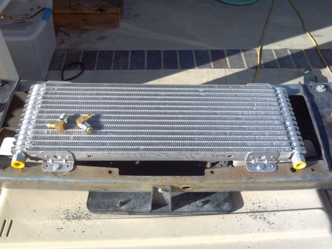

I installed a Trucool trans cooler on the front bumper. I initially installed it with the fittings pointed down, as others have. My RSK cross member interferes with the fittings, so I had to rotate the cooler 180 degrees and redrill the mounting holes. Plus I need more washers to space the bumper out so that the studs don't hit the I/C.
Rusty
