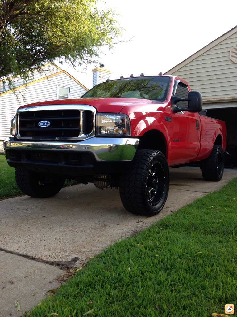

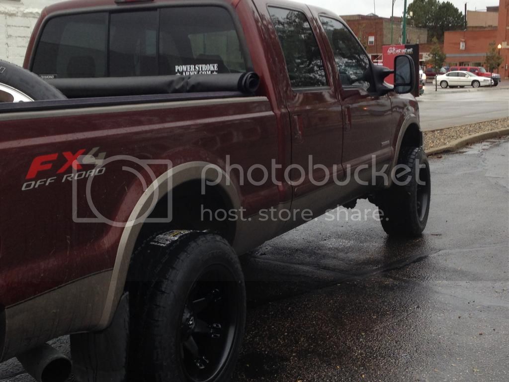

2006 F-250 1.5" level 20x12 -44 offset fuel octanes with LT 305/55r20s nitto terras, it rubs as of now, have to do some trimming.

Sharp truck. Not a fan of big wheels / low profile tires on a truck. You nailed it. You got just enough tire sticking out to look mean and aggressive. Not so much to make it look like a skateboard. Just noticed you sig... 4.56 gears, lockers, high steer... You really take that baby wheeling? I love to see a big truck wheel.

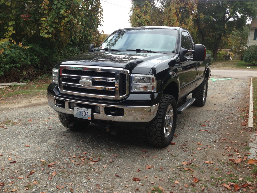

My truck has factory 20's with 305 duratracs. Kinda wish I went 325's. next time.

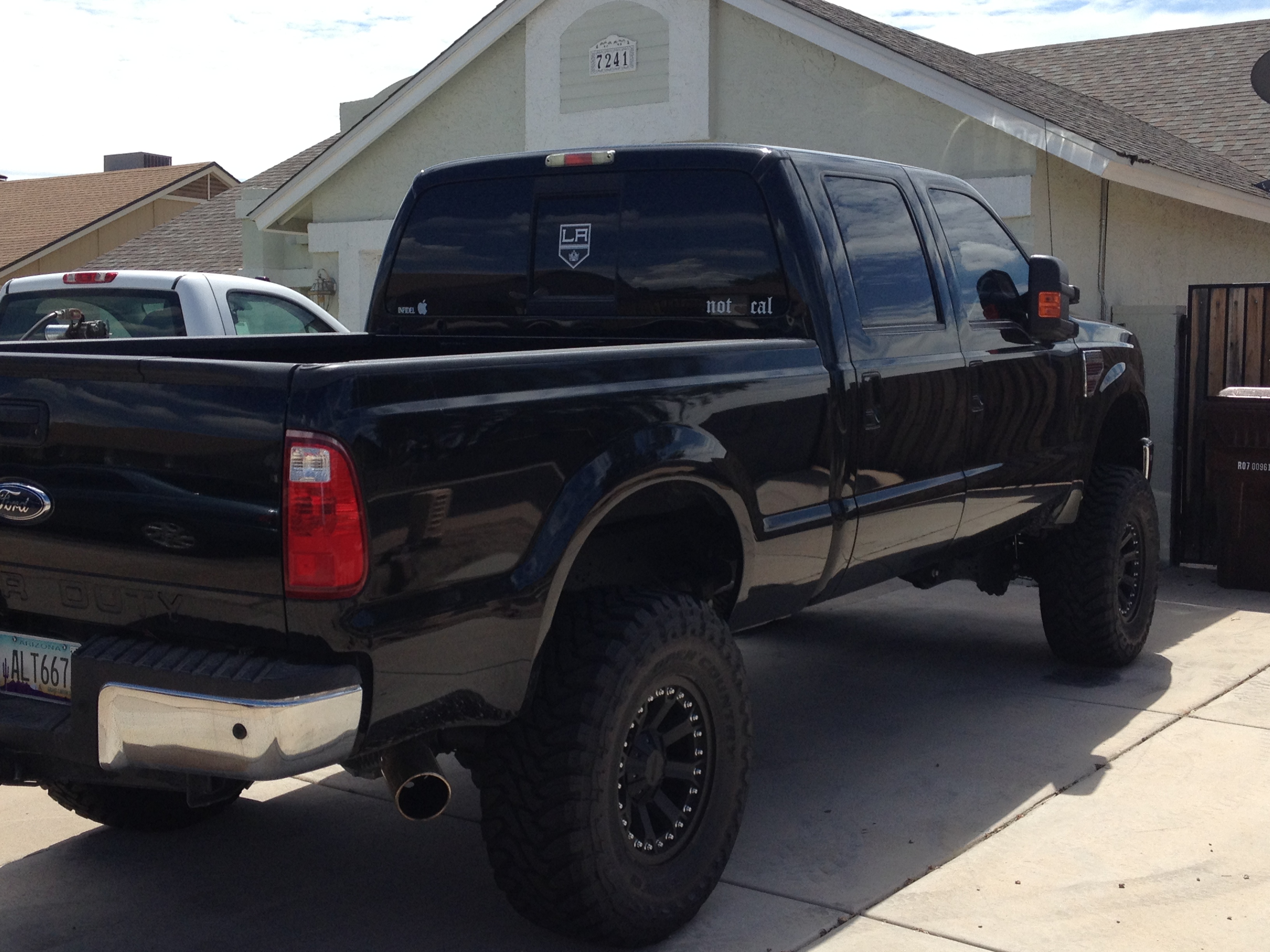

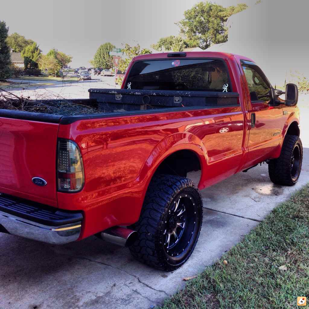

18x9 pro comp wheels 0 offset 37x13.50 18 tires 7" icon vehicle dynamics lift

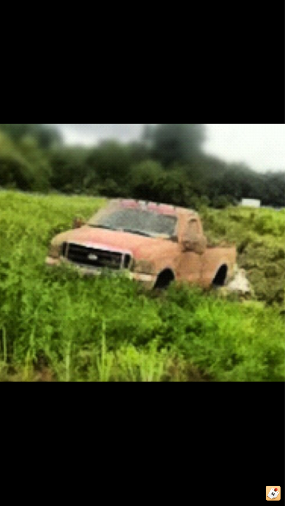

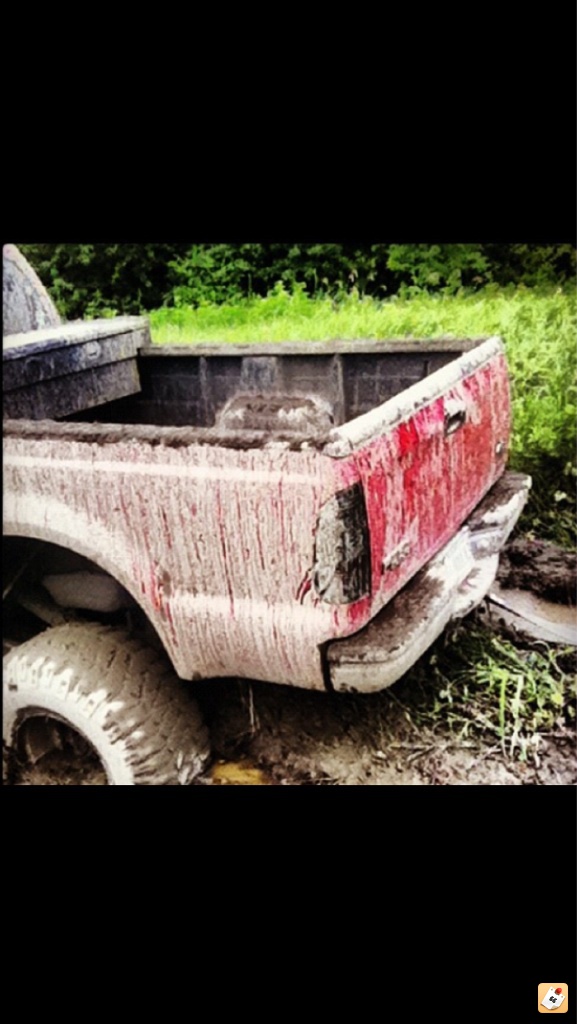

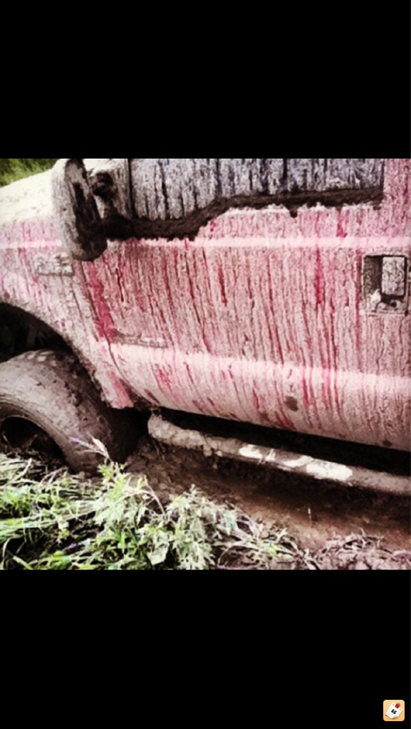

Thanx man and yeah when it was on 38's I dumped it every mud hole and climbed any obstacle someone said I couldn't. Haha. But that got to expensive and too abusive to my truck. So dropped her down. Loving the lowered life though! I do occasionally miss the glory days of pulling other trucks out but been there done that, broke and bought enough parts to get the shirt for free.
Except in these pics. In this pics I was stuck as F#%€
