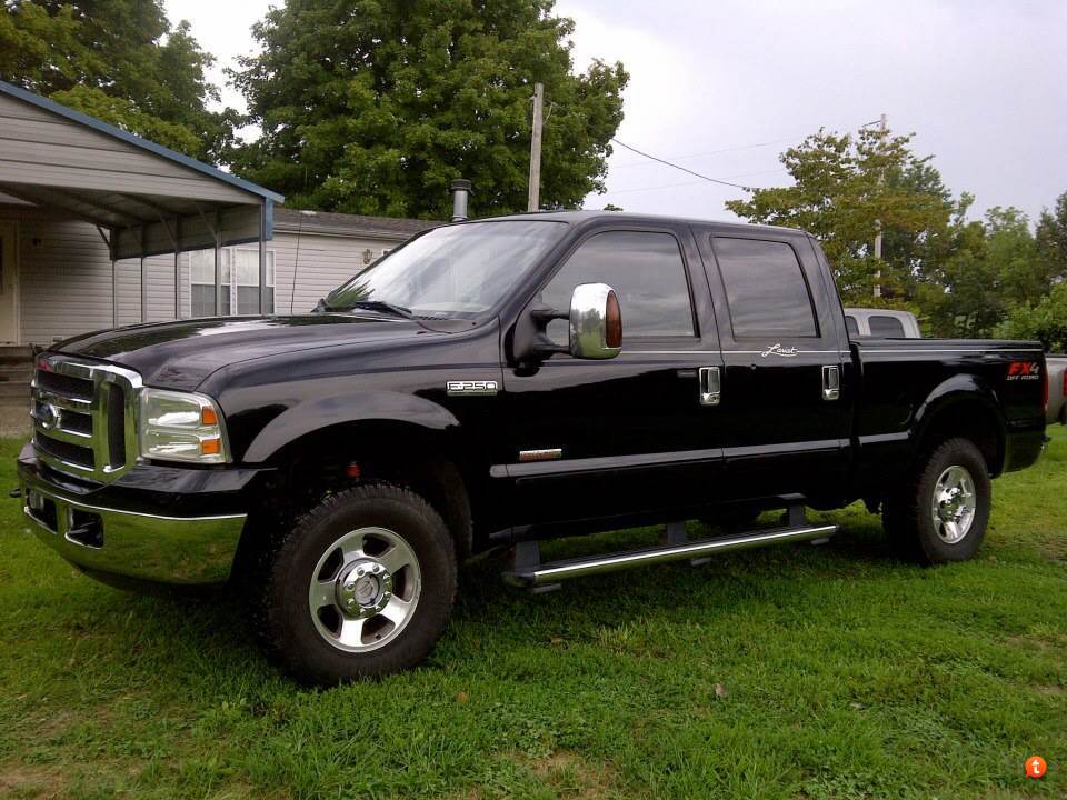

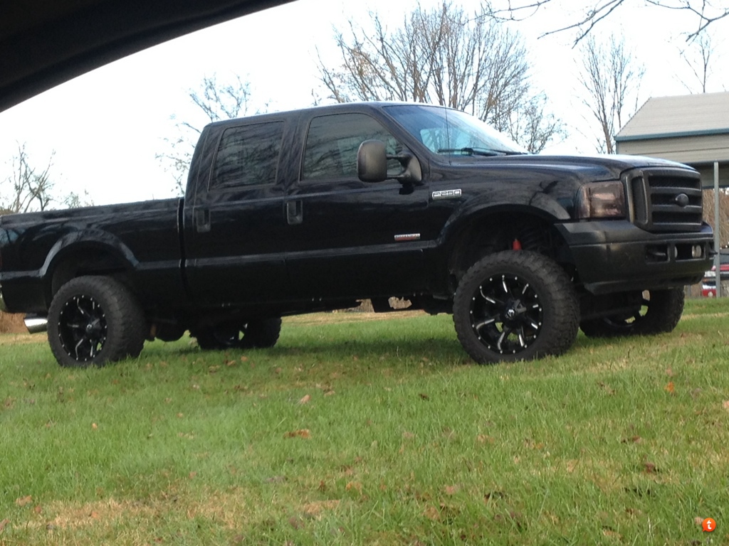

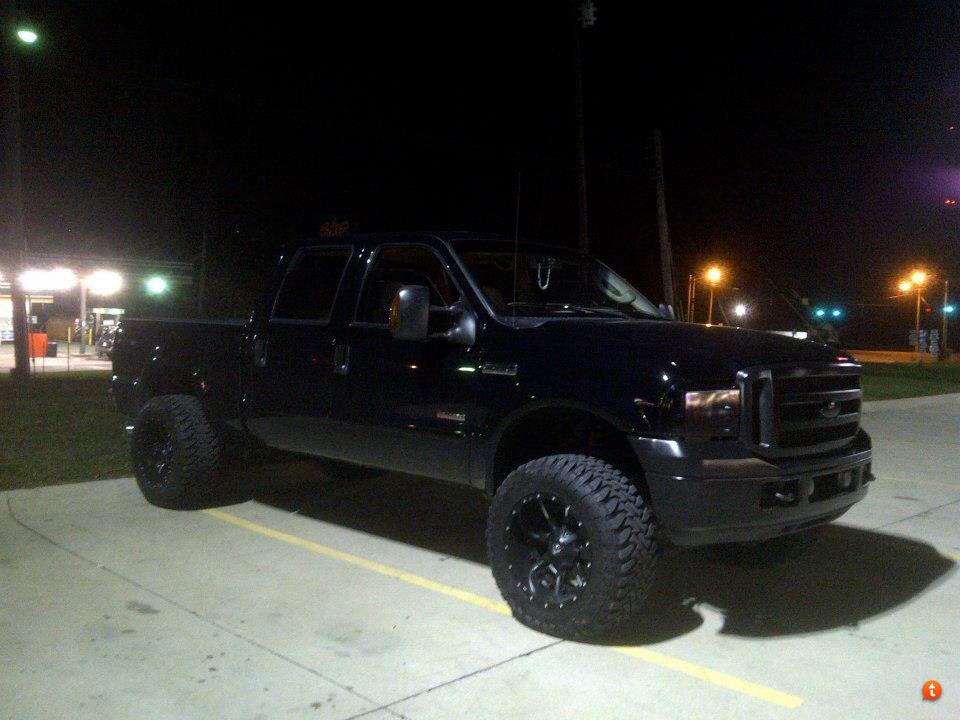

I would not run that narrow on the rim size with that tire, with the 13.5 wide tire id Atleast run 12" wide rims. I run a 35x13.5 tire with a 20x12" -44 offset Fuel Offroad rimz. I just had a 3+1 leveling kit and it worked out pretty good, wanted the truck a little higher tho. But the stance was Awesome, stuck out just a little bit, looked good an aggressive IMO.

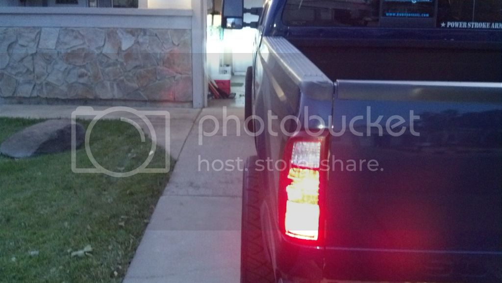

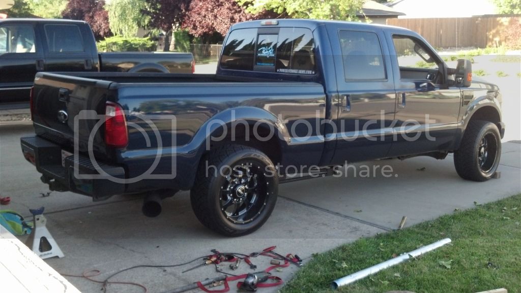

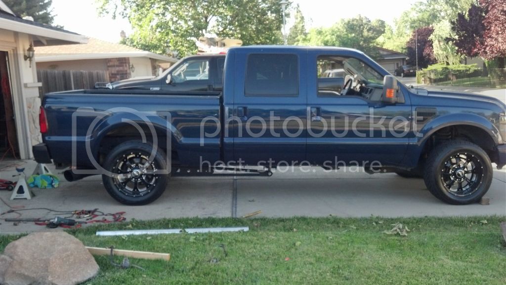

20x10 novakanes. 305/50r20 nitto 420's, 5.4 coils, 1.5" pmf blocks with no overload. No rubbing so far.
Anyone have any guesses as to roughly what size spacer could be used with factory 20's and 12.5 wide tires to get roughly the same offset affect as the above truck? Would 1.5" spacers be pretty close or is that closer to a 2" spacer?
Thanks.
