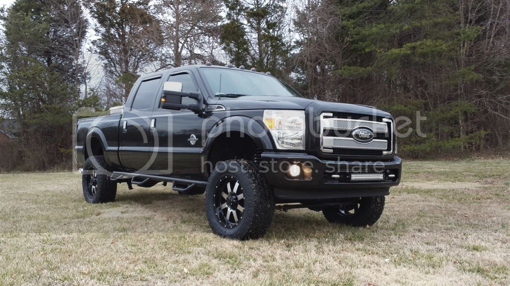

Here is my recently converted 2003 6.0. Current brand new set up is 20x10 Fuel Throttles -24 offset deep lip wheels with Nitto G2's 35X12.5x20. Lift is 3.5" fabtech and matching rear blocks on stock '03 springs. Minor rubbing on inner fender, I will get that fixed this weekend. Fitment turned out perfect.

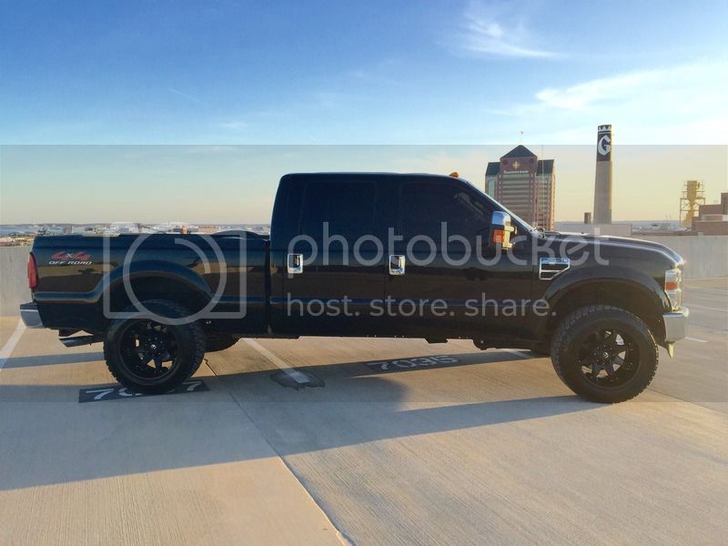

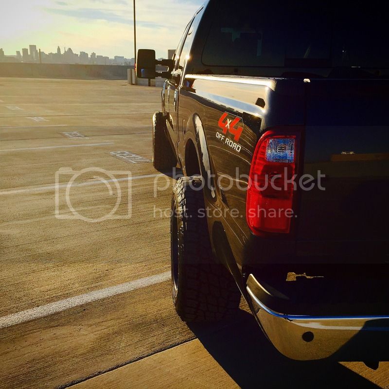

Well here's the Ox as she sits now.
2012 F250 CCSB, 4in Zone radius arm lift, 20x10 Centerline Scout polished rims with -25 offset, and 37x13.50x20 Toyo MTs. Front bumper bracket was removed and I did minor trimming to the factory fender flare to alleviate any rubbing. I can turn full lock both ways without any rubbing. It does however rub if I hit a bump hard while turning sharp or backing up at full lock but it's all rubbing on the inner plastic liner.
