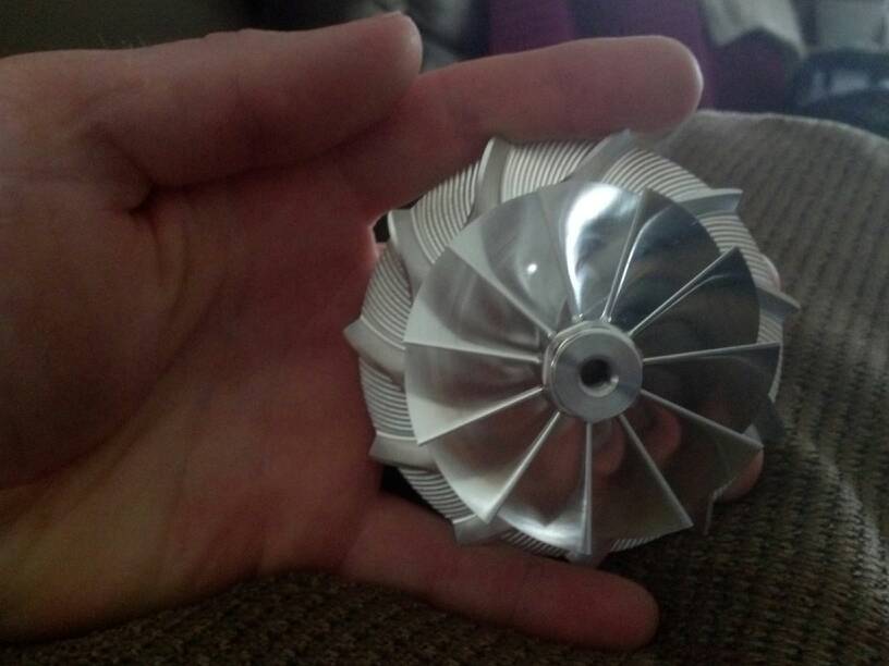

mine showed up today.

So the package says to not use an impact gun which im ok with that but how do you know when its tight enough and do you still use locktight on this one.
littleredstroker
Jun 22, 2011
3,720
where the antelope play
I remember on my stocker and ww1 I tqued it to 100-120 inch pounds I think it was . Tq wrench on wheel, screwdriver with rag around it in the turbine housing
in for the same info... Mine showed up last week and I haven't been able to install it.. I have stock injectors and don't expect much but any gain would be nice.
CSIPSD
5,284
Bend, OR
No lock tight, most times I dont even use a wrench. Tighten with hand and reinstall. Its going to get tighter as the wheel spins.
