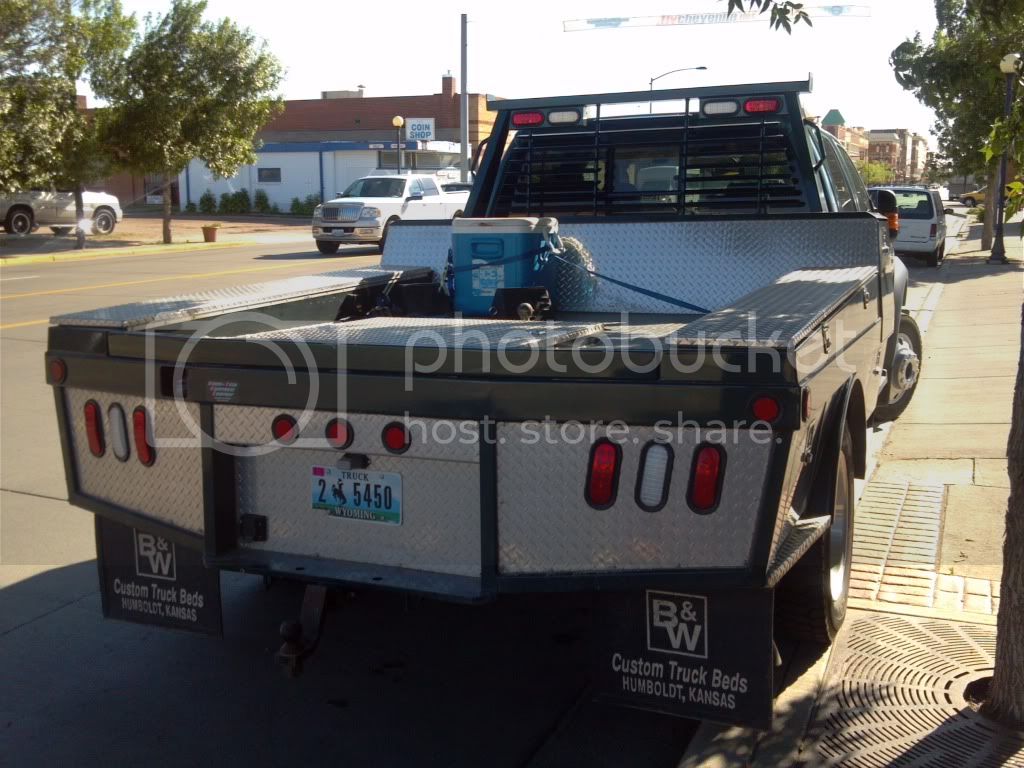

This truck is our shop tow rig. 08 F-450 4.30 gears 6 speed manual. It is a cab chassis with two fuel tanks and rolls across the scales with out a trailer at 11,600lbs. Truck has a DPF delete, Kem 150 tune, Banks air box, Banks intercooler, Banks speed brake. A custom built B&W flat bed, with a buckstop bumper. This truck regularly pulls a a 22k pound toy hauler fifth wheel or our 40ft enclosed race trailer. Before all mods the truck was a turd didn't wanna go much over 70 pulling and would only get 6 mpg at best. Egts were around 1100 cruising as well and peaking around 1400 on the big hills out here. After everything done to it this truck makes 451hp and pulls anything with ease at 80 mph. Averaging about 11 mpg still not stellar but a huge increase never the less. Egts are down to 800 cruising and barely hit 1000 on hills. In the next few weeks this truck will be getting a gearvendors and a southbend clutch as well.

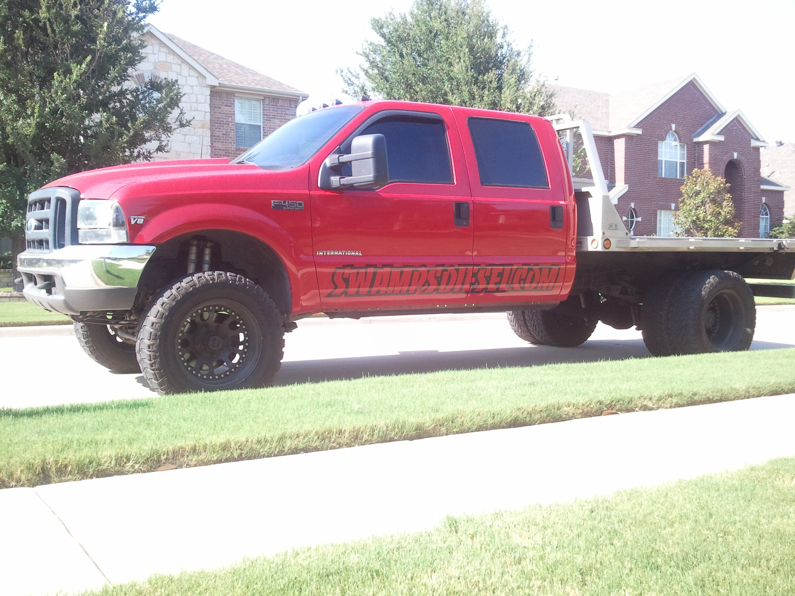

Not the best picture but the only one I have on this new phone. 1999 F-450, Swamps 200/30 hybrids, H2E, BTS, 6.0 intercooler, 6.0 trans cooler, tinted glass all the way around including windshield, custom 1 off 20" wheels, 35x12.50 MT ATZ's, 3" lift, dual bilsteins, 4.10 gears with detroit locker, full JL Audio components with Alpine DD headunit... Theres more but I'm drawing a blank. It will be getting a lot of new parts soon, ready to finish this thing!

Good looking truck. I passed you guys hauling a dodge coming into Denver. You have to the love GV on the long hauls with the 450 and 550's. Its worth it just so you dont have to hear the drone of a reved out engine and the constant clutching of the engine fan.

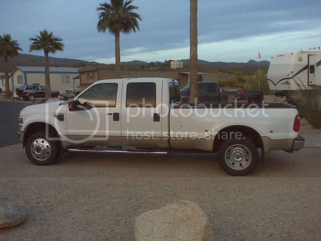

This is my tow truck. It has banks exhaust, intercooler,intake. DPF delete and downpipe. IC pipe cfm elbow and egr delete with wastegate. Elite head studs tow x turbos and high efficiency injectors. Gear Vender aux trans and a 60 replacement tank. As far as how it runs.IDK yet its still getting fixed from the Industrial Injection fuel pump that blew up. ( Note that it's not in the list anymore)I weigh 30,000 most of the time but I can legal up to 36,000. I was getting 4-6mpg. Last trip with II turbos was almost 8. New turbos will be better.
No that's not me standing behind it.
