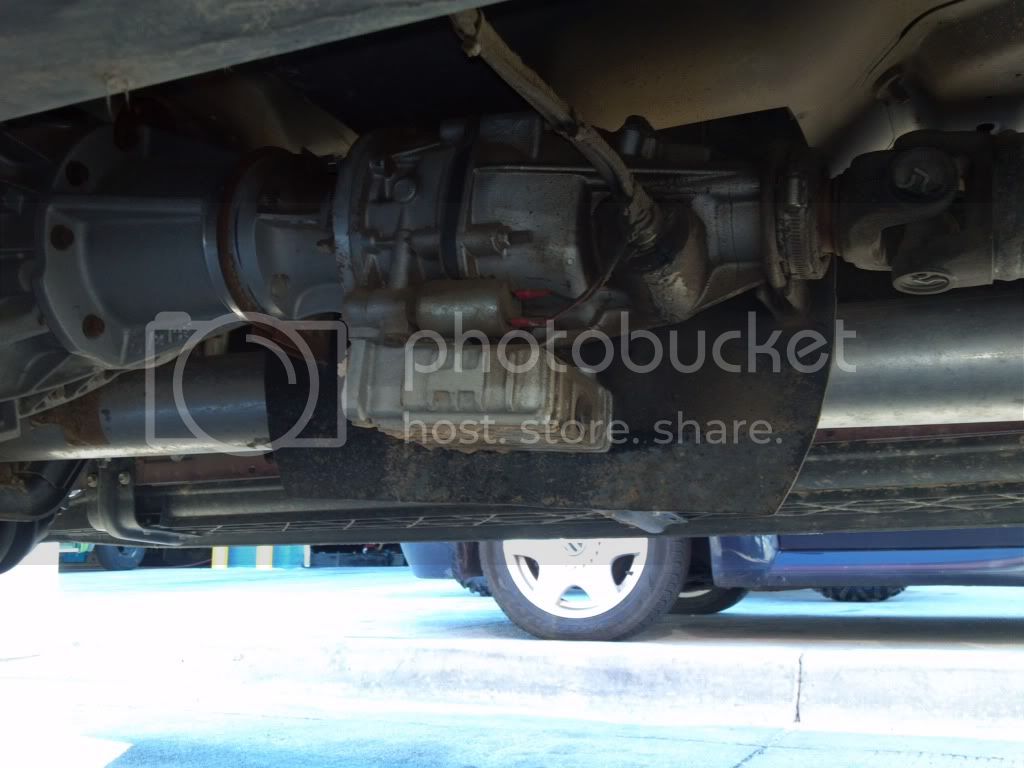

Here is the gearvendors.

I have that same kelderman mini bag system on mine. That was the first thing I did when I bought it. Where are you getting the Gear Vendors from? I thought they shut down?

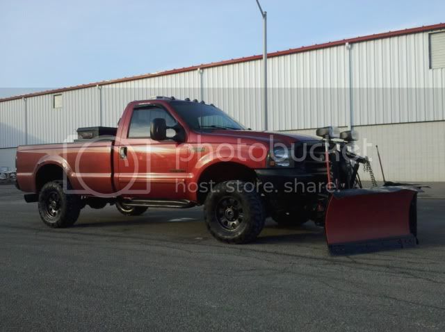

Here is a picture of mine. 2001 550 with H2e, BTS, PHP tunes, Adrenaline HPOP and a bunch of minor mods. I don't tow heavy 10K tops but I got a good deal on the truck in 2003.

Thats a good looking truck. Were a dealer for gearvendors and that unit was actually installed about 6 months ago. I haven't heard anything about them shutting down.

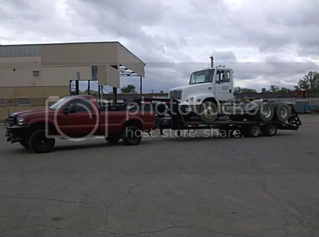

Here's mine. Not setup nearly as nicely as most of the tow rigs in this thread but it moves everything I ask it to. :cool:

Looks good. I have a 850D dozer about that same era I tow. You must have bags on that truck I don't see near enough sag.

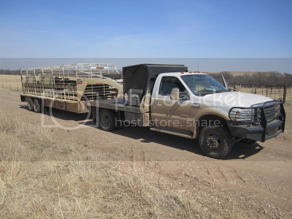

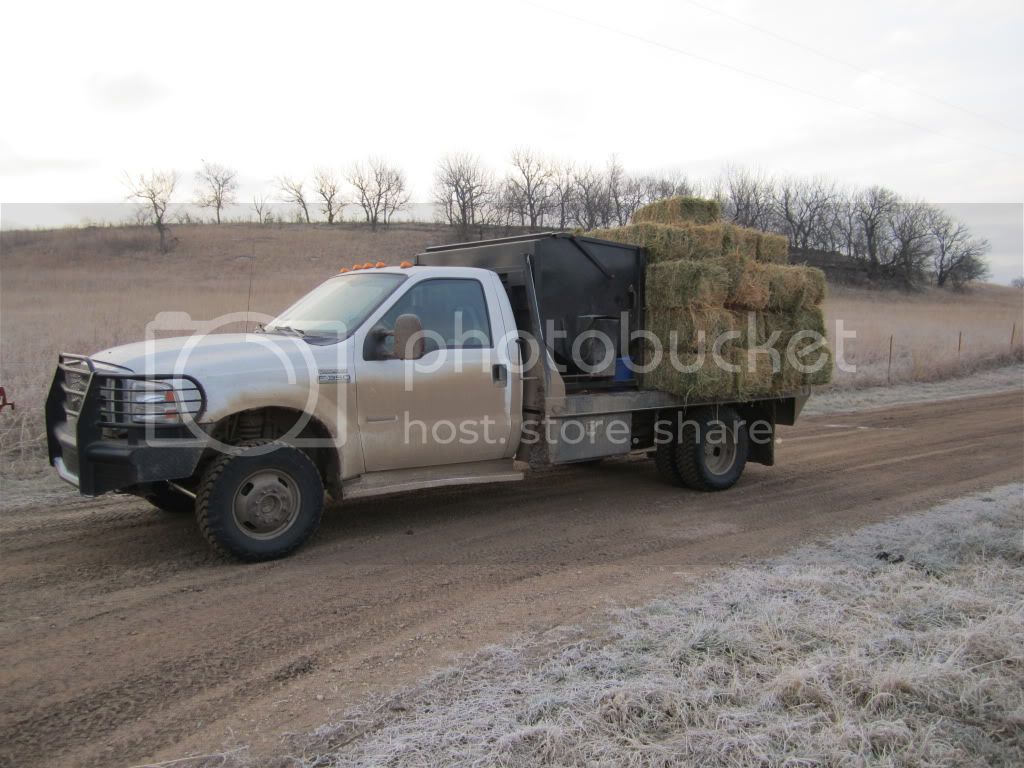

Heres a little of what mine does...
Damn!! That's a nice looking setup! What kinda trailer and what's the specs?? Looking at getting a goose neck soon aand curious what everyone likes for lenths and makes.
