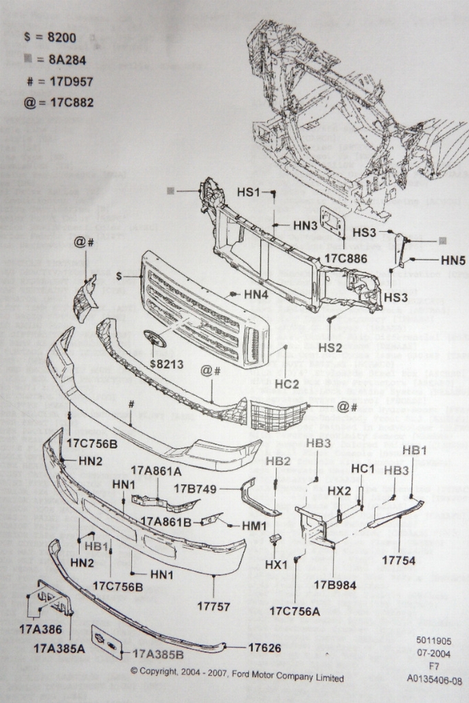

You'll need, all these things. 2005-2007 of course
-Bumper
-Upper bumper valance
-Lower bumper valance
-Main bumper brackets (attach bumper to the frame horn, some people like myself aren't using the additional brackets that support the sides of the bumper)
-Header panel (Unless you choose to hack up your 99'-04' header panel, which I don't recommend)
-Headlights
-Headlight adapter harness
-Grille
Hope that helps clear up any confusion.

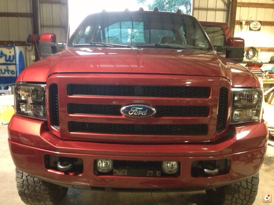

One of my buddy's trucks, he had the original front end on it and did the conversion and it looks like a brand new truck, I think they look great
Sent from my iPhone using Tapatalk - now Free
I love that look! It really does make it look like a whole new truck. Painted like that is the way I would go with mine if I do end up doing it. It's amazing what simple mods do to these trucks. Just a few pieces on the front end and even something as simple as fresh OEM badges to replace old chipped or faded ones really bring these trucks back to life.
