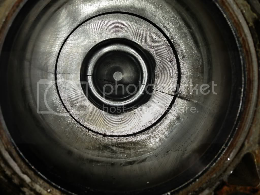

Here is what caused this.
I didn't take a lot of pics to be honest.

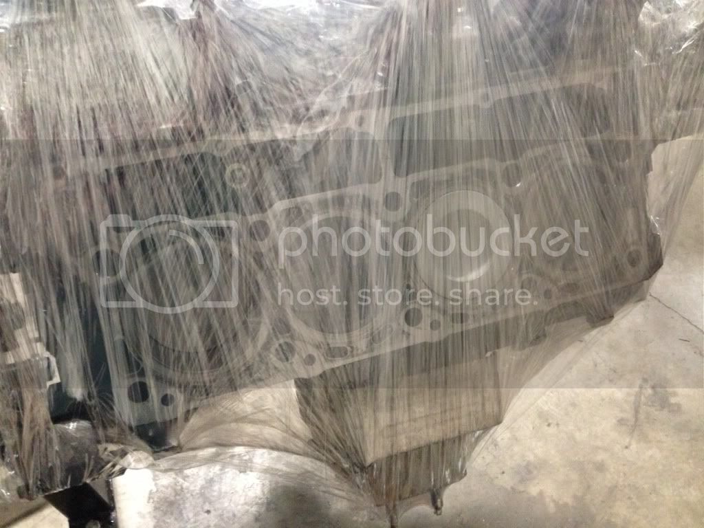

Motor with new international pistons ceramic coated.
Motor going back together.

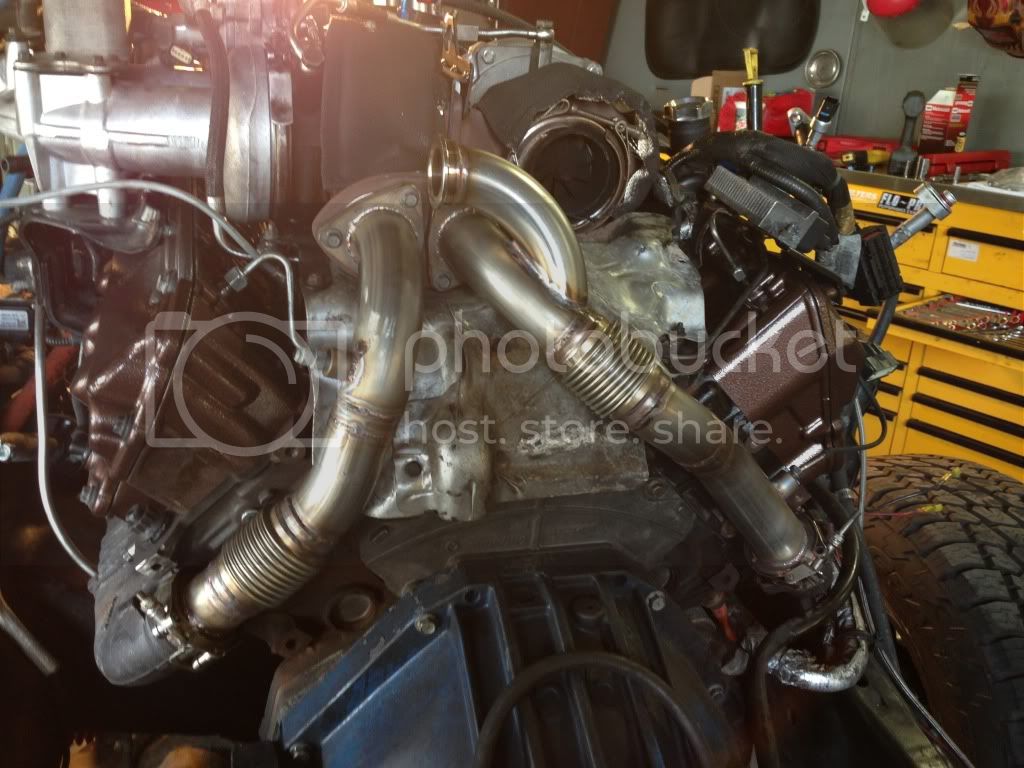

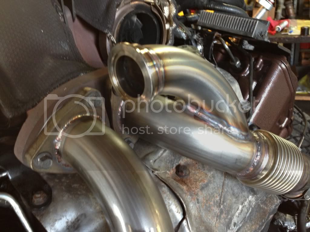

New up pipes. Back to the ported 6.0 manifolds.

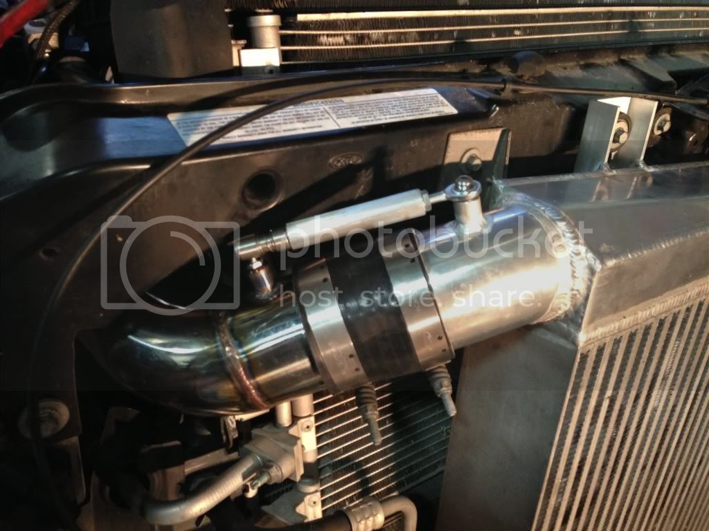

I got sick of blowing boots. So I braced all the joints. And SOLID mounts for the intercooler welded up. It will not sit crocked again.

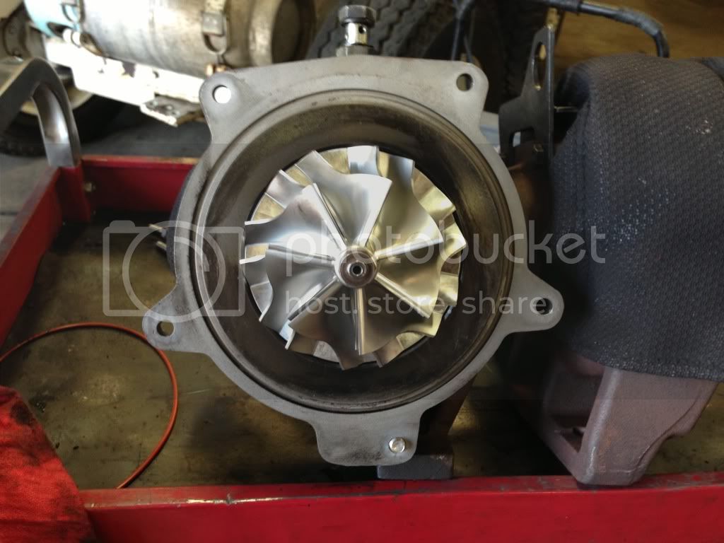

STOCK TURBO. LOL
