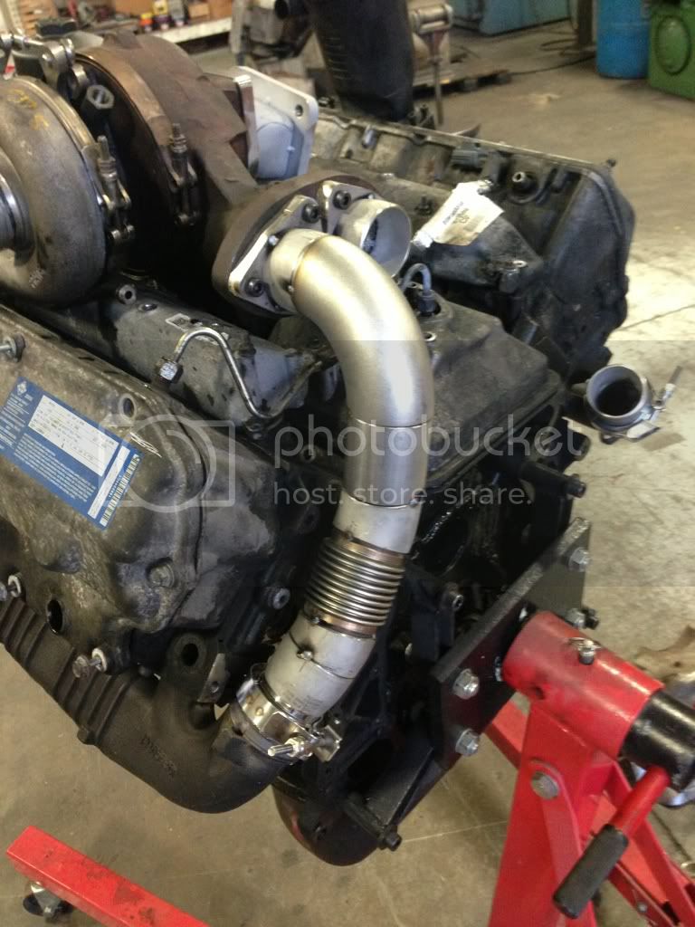

Got a little bit done today after work.
Drivers side extreme duty up pipe.
I hope your cab comes down and fits with those up-pipes ahah. Nice work!
