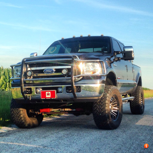

Awesome truck!
Not the best pic but here is one. I can get what ever angles you want if you want. I put one coat of nite shade on so it wasn't so damn bright of an amber color. just looked out of place.
