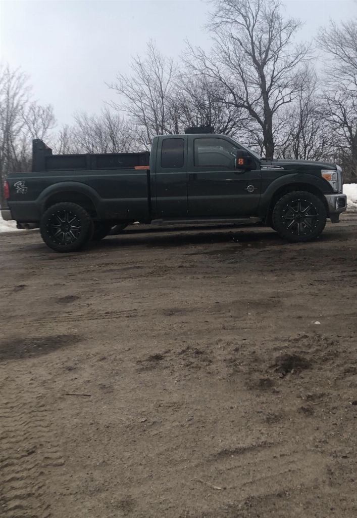

This is a picture of my truck with my buddies rims next to it. 22 35x12.5 -24 offset. I like how the tires filled up the wheel
Looks sweet dude!
I get 15 all around 37s, 35s, and 275s. I did get 18 this morning on the highway with a good tailwind. lol

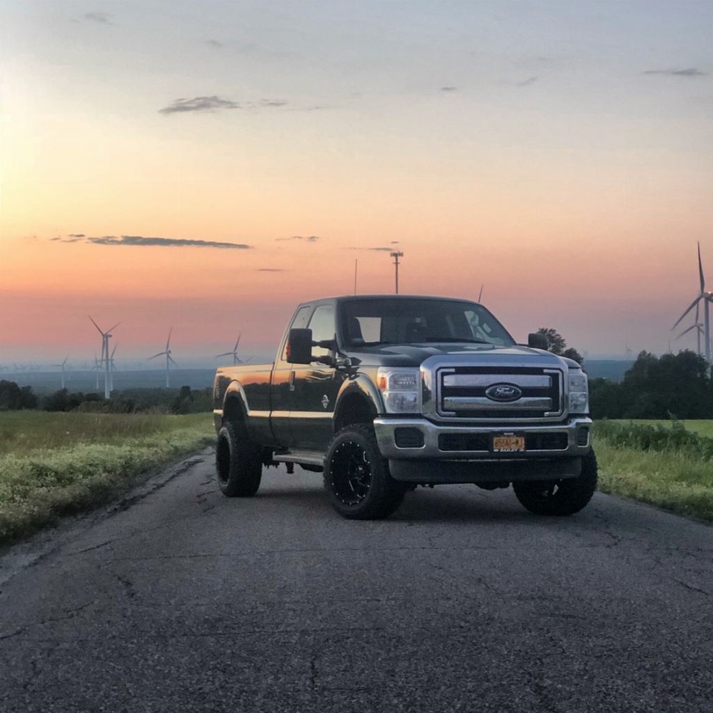

On another note. My leveling kit will be here tomorrow. Going 2.5 inches in the front.
I still have my eyes on some 20x12’s -44’s. EVERYONE around here runs 20x10’s. They look good but like I’ve said before. I like the -44 offset.
Anyone have a set up with a leveling kit with a 20x12 -44 with a 33x12.5 or a 35 12.5?? I know they need some trimming, I’ve done some reading and all I’ve found is seteup like that on a 6.4!

I had a 14 in the shop the other day with x12 & 35s on it with 2.5" level. Bumper brackets, lower valance, inner fender liner AND (cringe) the steel pinchweld/lower fender area were all extensively trimmed. It still rubbed in certain instances fyi

It’s leveled. And conky pup says hi
7.3obs
Nov 18, 2014
205
On 14” wides
Idk about 14 wide!!
Trying to find a set of rims and tires for this truck is killing me! I’ve had it leveled for two days now and it sits too high for my likings. Seriously debating on pulling the 2.5 leveling kit out, the 4 inch lift block out of the rear and throwing a 2 inch lift block in it and then seeing what I can fit under it. It would be level from stock front to a stock f350 rear but a 2 inch block out of a 250.
I’ve always loved a low truck, with a wide and as tall of a tire you can fit under it. This is my obs and I’ve always liked how it’s sat. Between a Dana 60 in the front with -44 20x12’s with 33’s all I’ve had to do was cut a small amount off the bumper.

It took me awhile to decide on what I wanted for rims, then I found them. Come to find out their on nationwide wide backorder. I sent out about 10 emails and I found a company that has the last set available in the nation. After talking to some people and I did see a truck with -44’s with 20x12’s on 33x12.5s. That’s why I ordered. I’m not too worried about them fitting. Just hope the rims look good on the truck.
I’ll for sure post back up when I get them on.

20x12 305/55. 2.5 level and I didn’t have to remove mud flaps or front bumper mount. Doesn’t rub at all.
