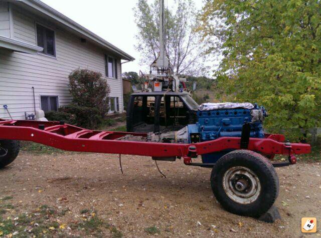

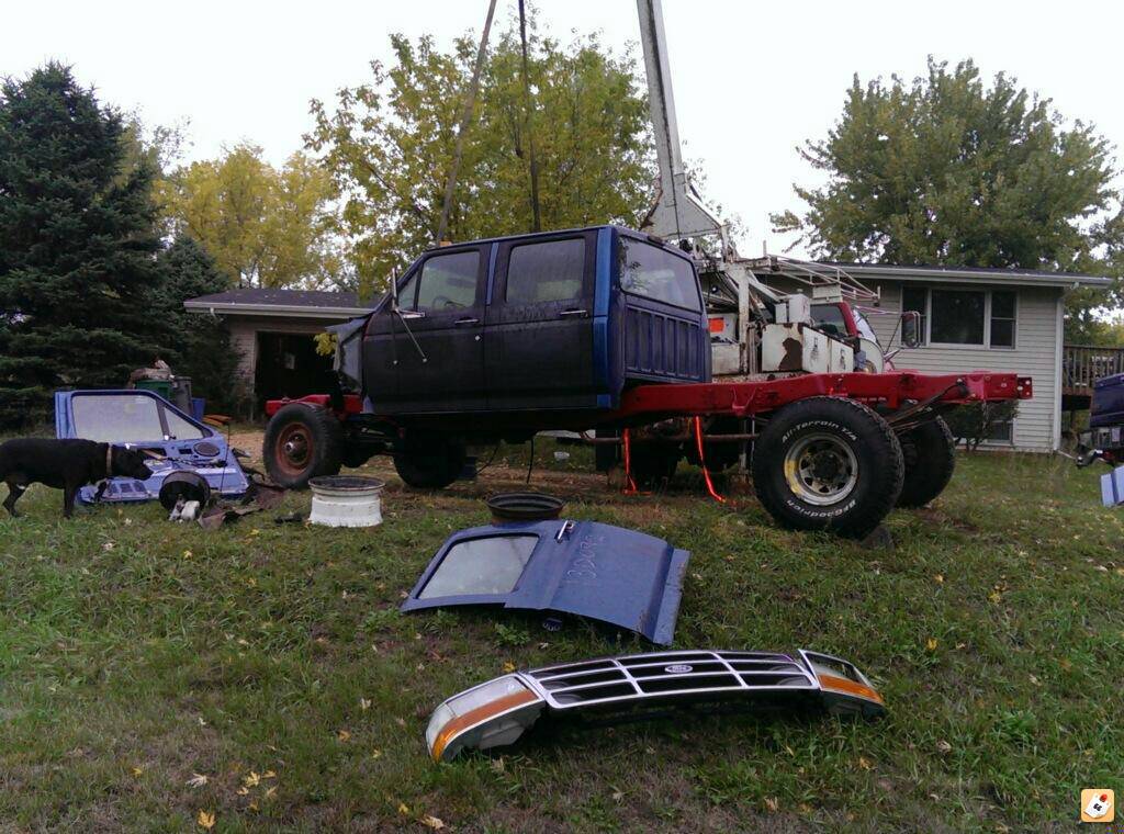

I've been mustering the energy to work on this thing again. Got the new cab on yesterday. Was going to upload some pics, but the free version of tapatalk is no longer and I refuse to pay for it. So at this point, no more pics. Should have the front clip on this week, brake lines run, and start on wiring and swapping the power guts into the doors. Should be doing my header and compound piping, intake and intercooler piping soon. Shortly after that is drive shafts

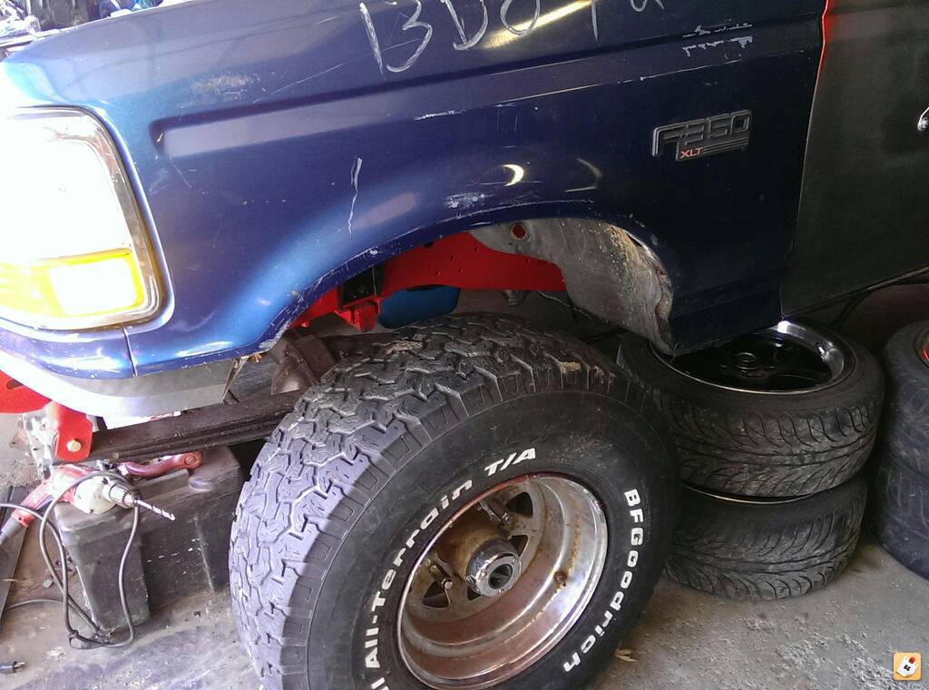

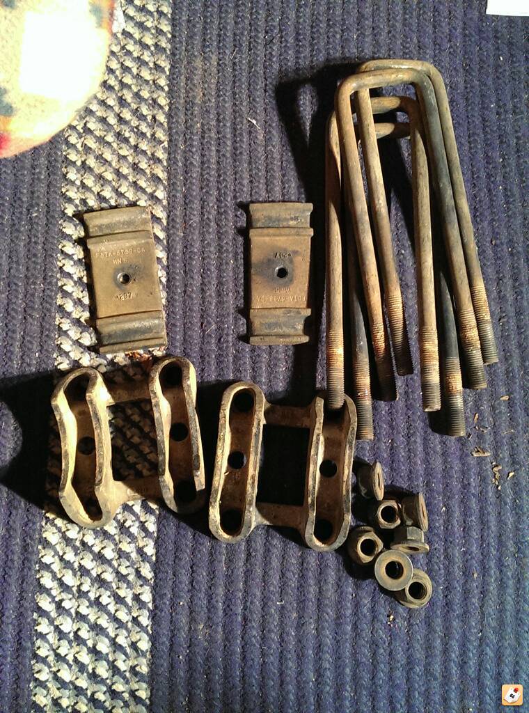

Stock height with 35s. Last picture is the u-bolt plates I've been waiting on!
Sent from my HTCONE using Tapatalk
Looks like an add a leaf in the front. Not stock. But looking good! You should do a white interior so that it'll be red, white, and blue!
swamp_ratt
1,506
hudson, wi
It is an add a leaf up front, but for weight. It doesn't add any ride height. I had that spring custom made to not affect ride quality, but support added weight. I will be adding a mini pack up front to make it ride level. With the new rear axle it did add a little height in the rear and I want to remove that rake

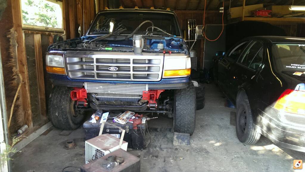

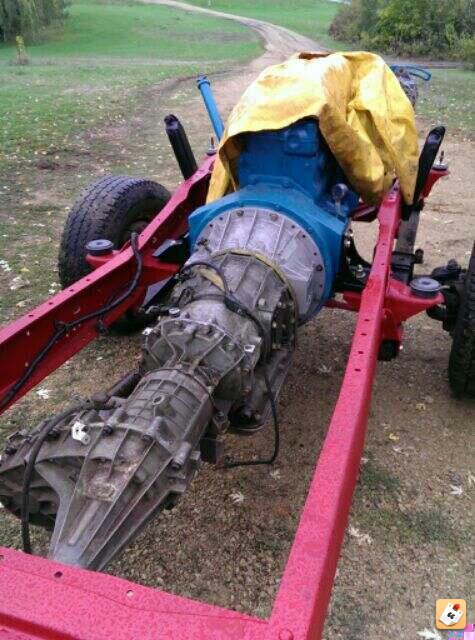

I'm not using any stock mounts. And judging by the picture your motor needs to go backwards about 3 inches and to the passenger side some! You will need to clearance the floor on the driver side and the firewall some to do it
Merc460
Jul 5, 2013
26
I had just set it in there for the first time. The pic was more about the showing differences in our front mounts, Did you build that mount?
