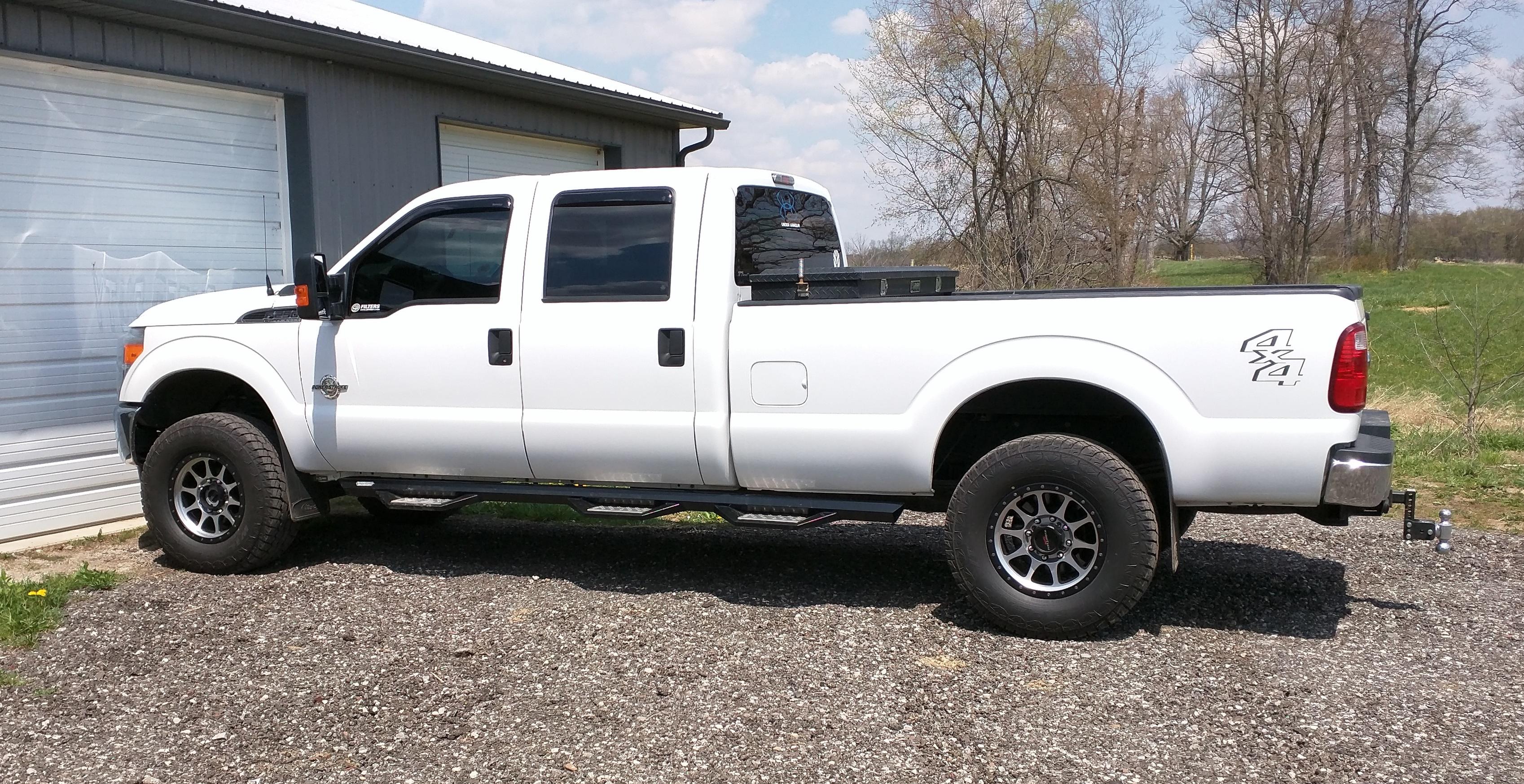

Can agree with MT Diesel, I have the 18x9 Walker Evans 504's and the look is nearly identical to Methods. I stuck with 5.5" BS due to Carli's recommendation and I don't like tires hanging outside the fenders. They were about the only wheel I could find with 5.5" though. Everything fits like a glove! No rubbing anywhere with my falken wild peaks 325/65/R18.
BTW its on a 2.5" backcountry with full packs in the rear
