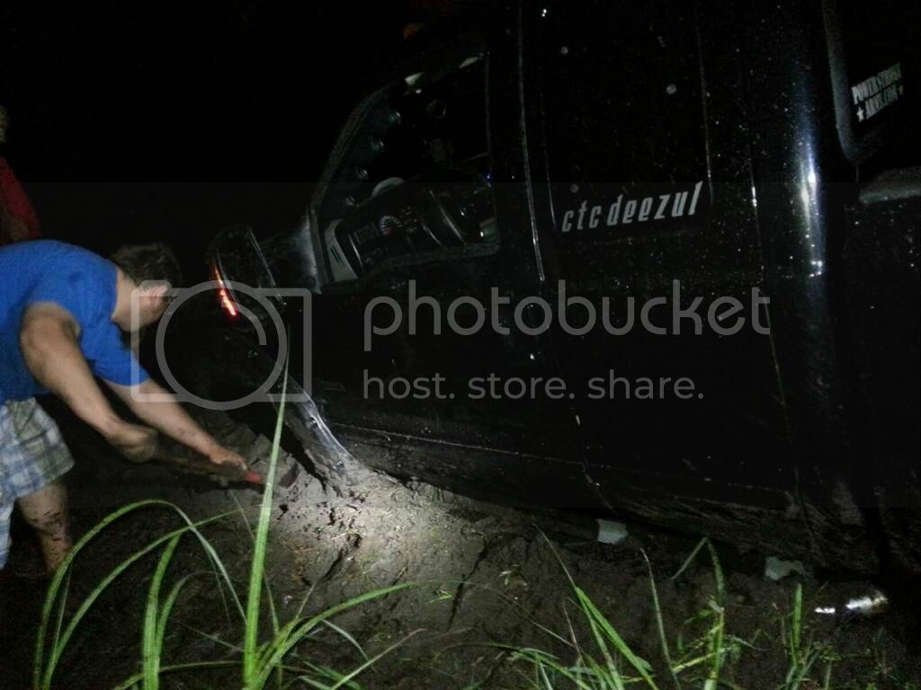

If the shaft is grooved at all it will take out a new bearing. However, shouldn't cause quite that...
Is the wheel missing? I can't tell what I'm looking at..

Lmao. Submerged in mud. Yea I gotta get this stuff done before winter. If the shaft took out the new inner I'll just order new shafts.
