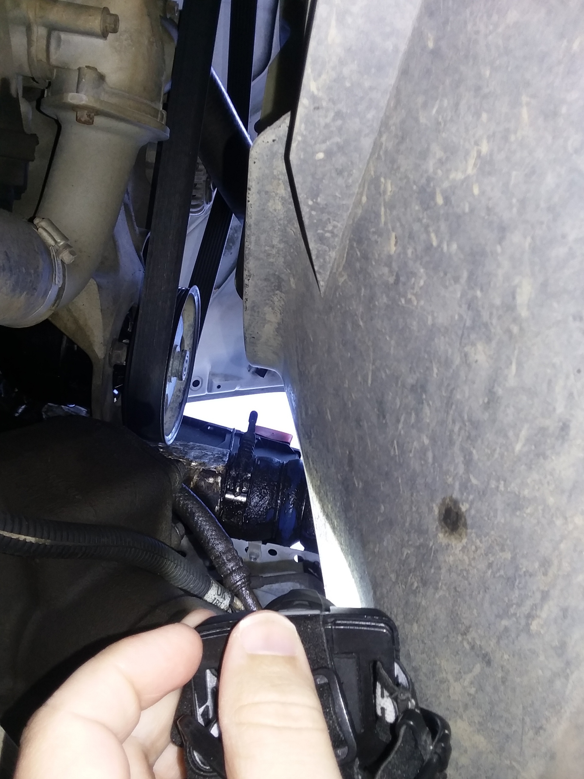

Will do I did notice a oil leak. Seems to be coming from under the power steering pump area and running down onto the underside. I'm gonna take some pictures and post them

Sorry for bad picture first time trying this

Can see oil under the charge tube boot. Not sure where it's coming from.

Could be coming from the intercooler itself.
Other possibilities: power steering leak.
Sent from my SM-N960U using Tapatalk
Don't think the power steering pump because it smells like oil and I'm running atf in the pump which I flushed out. There is a cylinder looking thing that is soaked it sits next to engine but under the ps pump not sure what it is. The intercooler is nasty I'm gonna be cleaning all that soon but I do get small drips of oil on top it and have no clue where oil would be coming from.

It's not terrible, to be honest.
When pushing the headers back on, lube the orings. They say you should be able to push it back together with body weight. I know 150# me at the time, couldn't do it. I had to use a ratchet strap to "press it" together.
There's a few YouTube videos on removal. I prefer to remove the whole thing vs leaving the front header in place.
You will need to drain the coolant and oil.

Do not wear any clothes you care about while fixing it. I also put a big piece of plastic under the truck to save the driveway.

OK thanks guys. Would there be any problems if I just it alone besides a oil mess? Or is it something I need to have fixed or it will fail completely type thing?

Worst case: oil and coolant could mix. But usually just leaks oil externally.

Ok thanks man I looked at a couple youtube videos and it looks to be more than I can do in my driveway. I check my oil once a week and while under the hood keep a eye on the coolant which I plan on flushing real soon. I will keep monitoring it too see if it gets worse.
