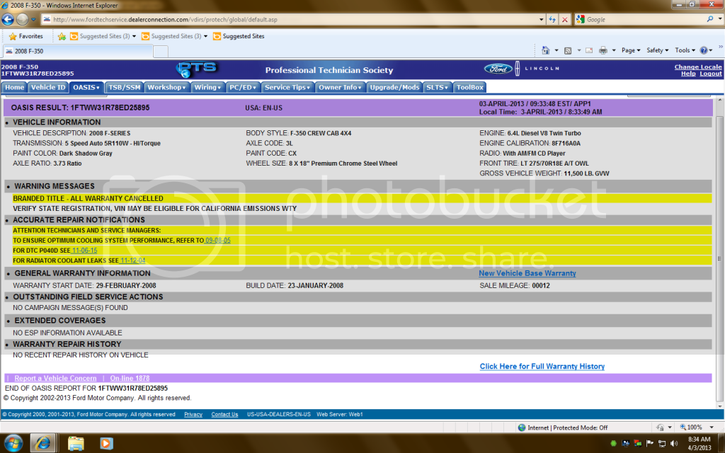

It will be tommorow before I can get the warranty information.
