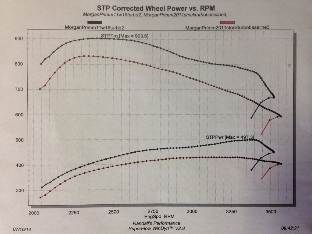

Well. The dyno showed what I was hoping. Made 426/725 stock charger, without changing tune or any other parts besides the turbo kit with billet charger (didn't even clean the s&b) it made 496/903.
Extremely happy with those numbers.
71 hp and 178 ftlb gain with no other modification!
http://youtu.be/hjU3VQwNvI8
Am I retarded? The dyno chart says the stock turbo made 427/825 not 426/725. So you gained 71hp and 78tq. Still considerable, but not 178 as claimed.
