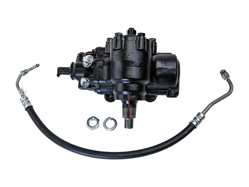

For the 99-04 crowd, the best way to go is the PSC SG-752R. The box is basically a newer box machined for the 99-04 36 spline pitman arm. It comes with a new high side hose. It uses the factory bolts and steering shaft. It a bit pricy but its plug and play and solves the mismatched parts issues.
"newer box". Is it the same as a 2015 box, which is much larger?
Sent from my SM-G973U using Tapatalk

That could be a good find for some folks. Those committed to staying with a dana 50 anyway.
If it's using the original mounting bolts, it's not likely the newer box that mounts with 16mm bolts.
Maybe a non-issue but I don't know if I would want more steering force and not upgrade the hardware.
Agree if it's not using the larger bolts then it's likely not "newer" meaning the larger box.
Also, isnt the sector shaft on the newer boxes larger? If so, i doubt they are machining it smaller.

Yeah, the sector shaft on the 11-16 boxes is HUGE by comparison. Another consideration when increasing the steering force, as with any upgrade the next link in the chain has to be upgraded as well or it becomes the new failure point. Hopefully, they would be using a completely new shaft made for this purpose as opposed to cutting them down which could lead to stress risers. It is still possible this is a good box, but I don't have enough information one way or the other.
A stock rig looking for something better daily driving? probably fine.
I have the Dana 60 front axle. All of the 99-04 Duallies had them. It is a massive box compared to the OE gear box. I can't say for sure what the internals are like but it has the six bolt sector gear cover. The sector gear where it leaves the box is larger than the OEM unit.

I have the Dana 60 front axle. All of the 99-04 Duallies had them. It is a massive box compared to the OE gear box. I can't say for sure what the internals are like but it has the six bolt sector gear cover. The sector gear where it leaves the box is larger than the OEM unit. View attachment 187059
Has anyone installed this box (PSC upgraded box) or compared it to a 2011+ box? I'm on my 2nd redhead in my 02 and need to do something. I don't mind purchasing the PSC box, if it's up to the job. I don't want another problem in the future.
