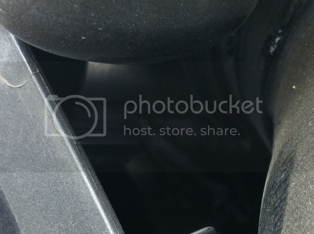

There is a orange plug on top of the egr on the passanger side of the motor.
And then hidden on the driver side is the other orange plug I have the plug tucked away from the fan but here is a crappy pic sorry I will go snap another one when I get home.

Yes, please unplug both the above described harnesses. I would reference our install instructions online, but they are in the middle of a revamp and are not accessible right now.
The most important one to unplug is the throttle valve. Valve is found directly inline with the charge air coming into the engine. Plug is on the bottom of the pipe, down by the fan and somewhat hard to get to.

Well, it turns out that there was a 2nd orange EGR sensor on some type of butterfly valve just in front of the fan. I unplugged that on Thursday and it fixed my issue. I called H&S tech help and they told me about it. I appreciate everyones help.
Was it not the one dodge_dbag stated in his last pic
