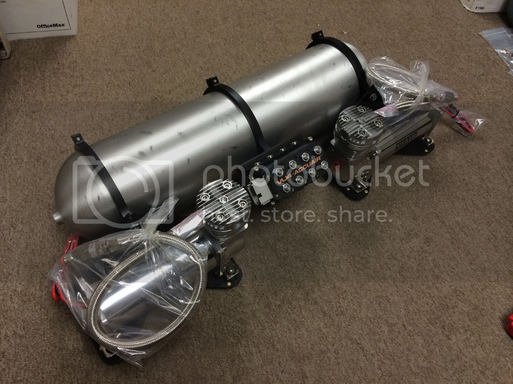

What are your plans for mounting them and what tanks are you going to use?

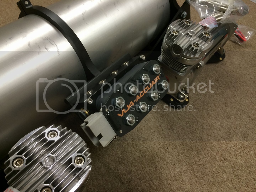

I have those seamless tanks, no worries there. The diesel cartel sold me the tanks and the mounts, like I said before josh is the man to get at for just about anything you need. These tanks will looks like missiles after they get painted, whenever that may be. For now I just test fit one setup to see how it went together. Pretty much perfect,

The compressors look really nice, just make sure you watch how hot those heads get.
Also, do yourself a huge favor and remove the stock check valves and upgrade to SMC check valves. The viair units are junk and will sieze on you without notice.
Otherwise, I really like the setup you're going with, looks great!

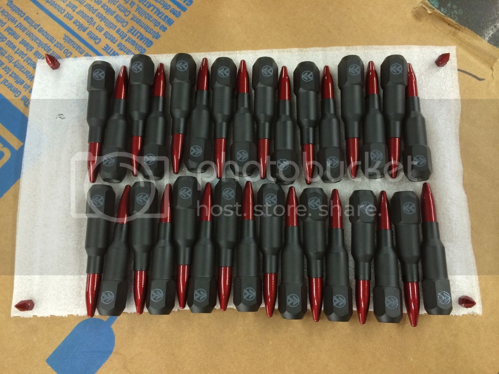

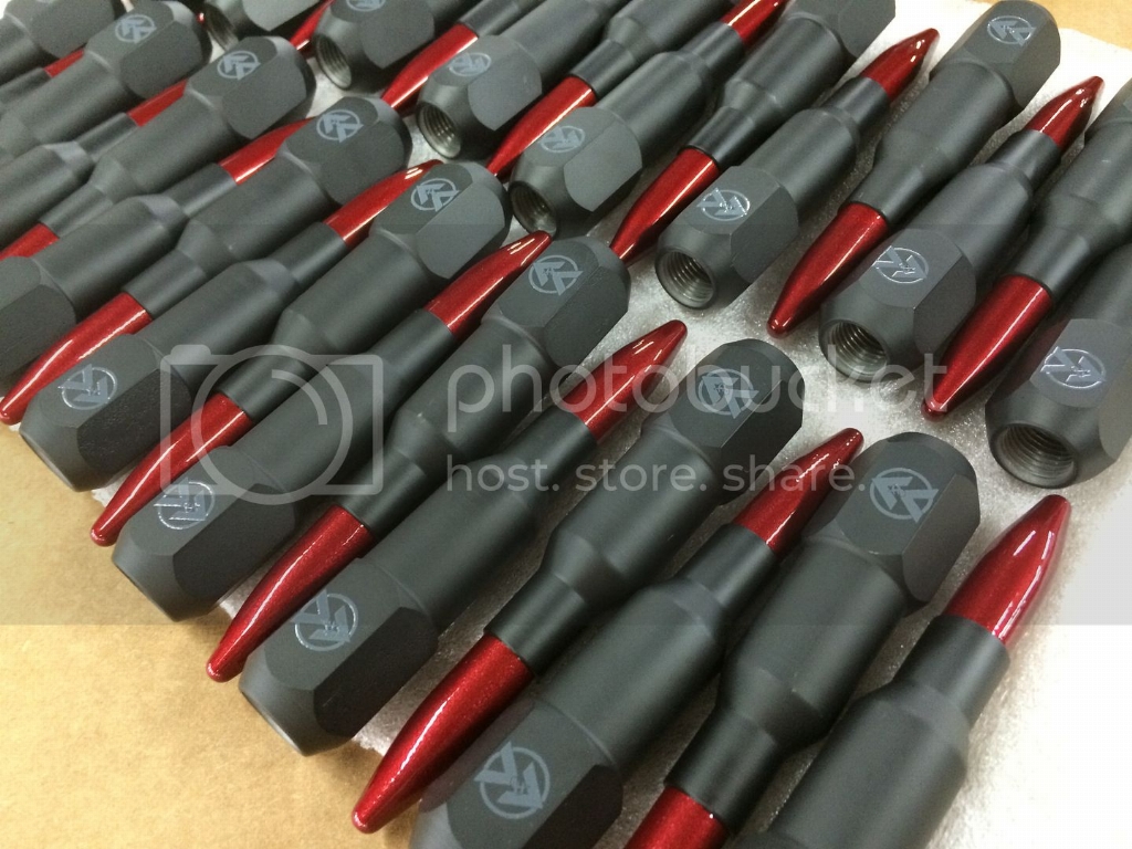

Lug nut time, these vv concepts .50 cal lugs look so good. In my opinion I like these way more than the traditional spiked lugs, just a solid sick piece right there.
CAT35niner
1,312
NJ
Almost looks like a belt for a machine gun. They look so good. Definitely not a everyday item. Very Unique.

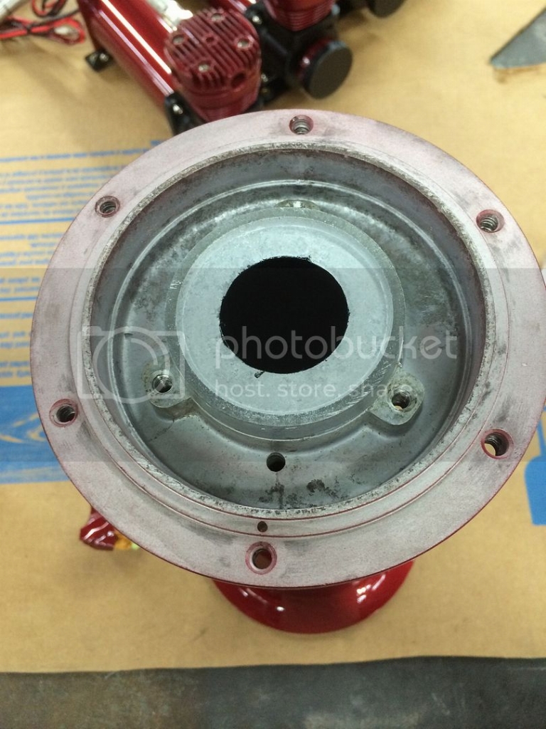

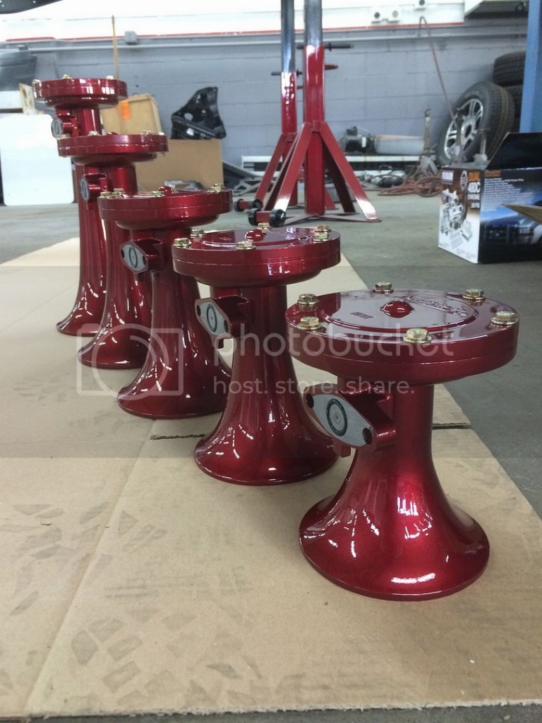

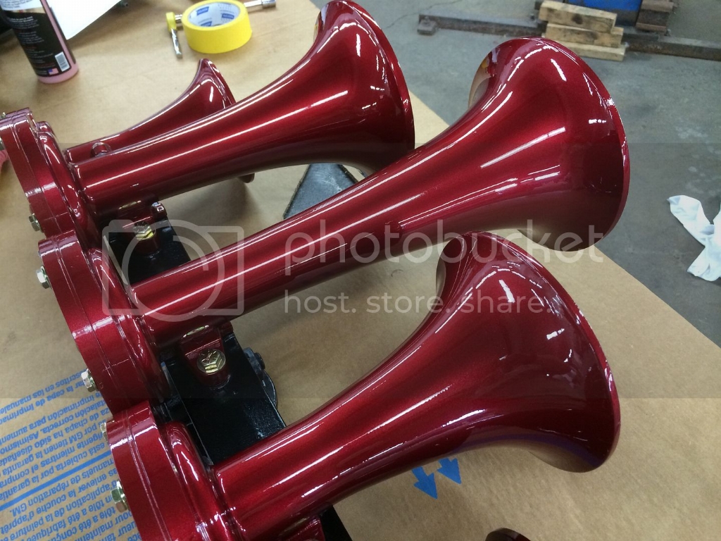

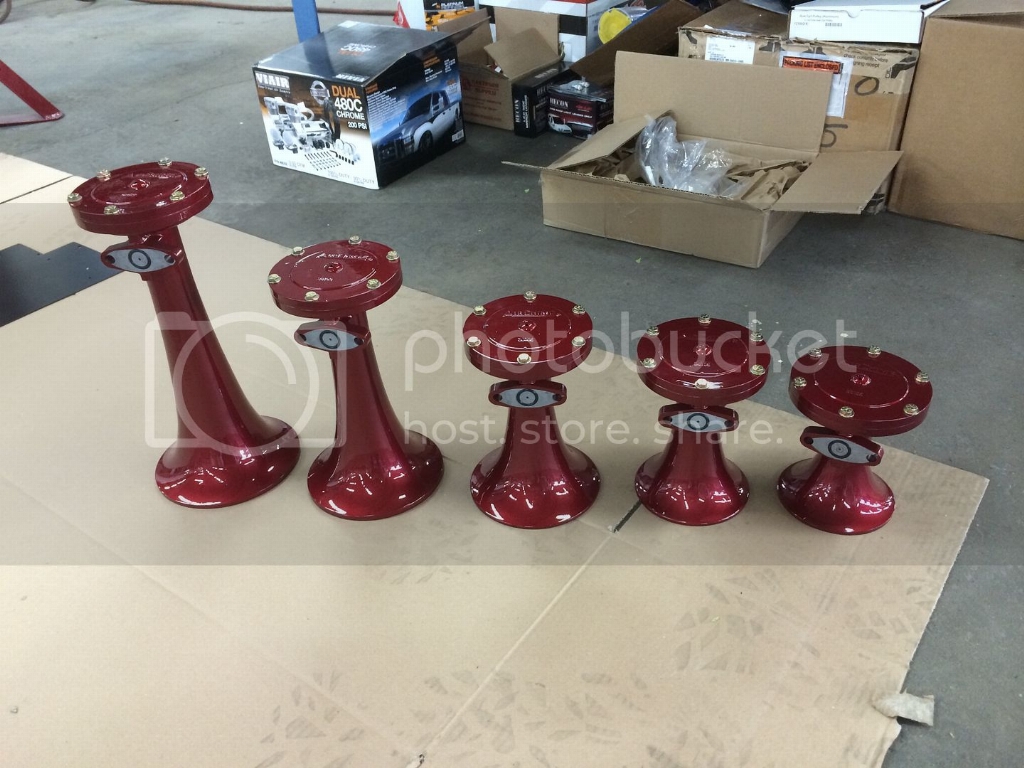

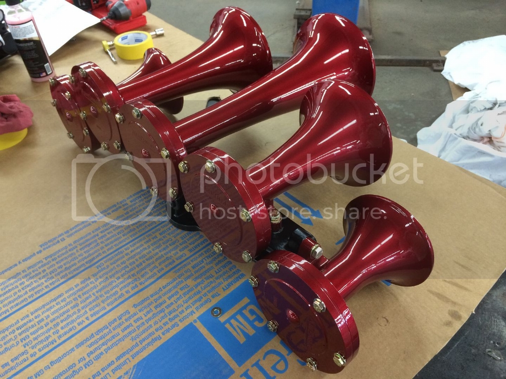

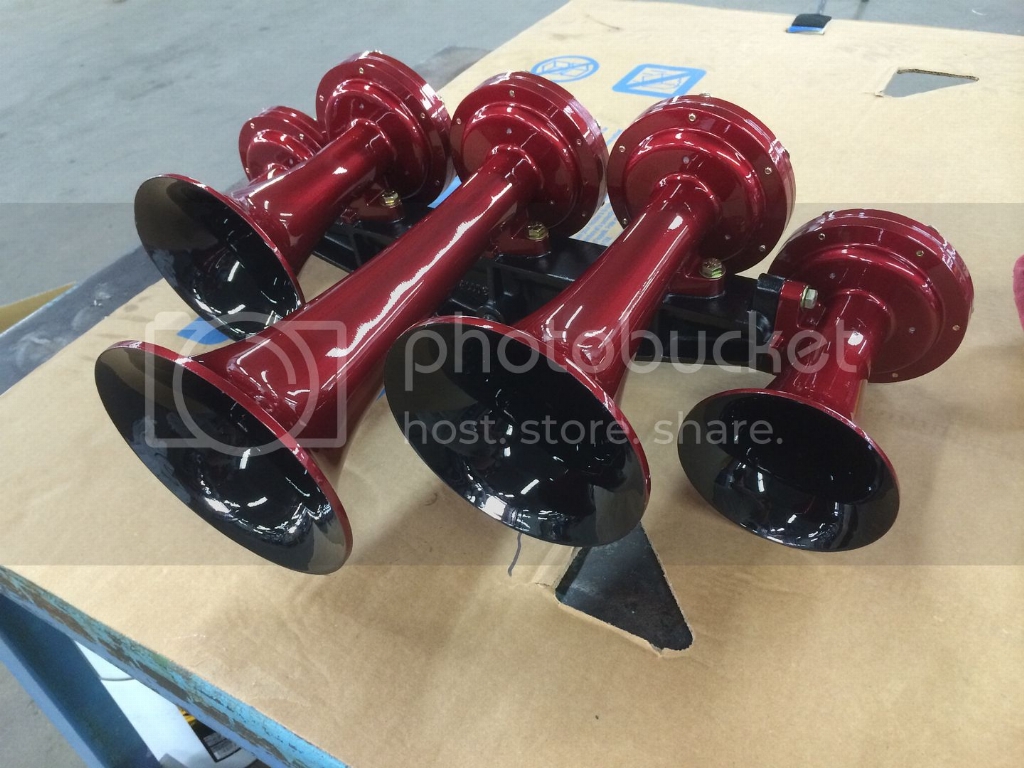

And finally the horns are done, I love the contrast on the bells between the red and black. Man are there some hours put into these horns, when I originally got these I was very disappointed. As the pictures show they were in terrible condition, so much time with separate sprays, multiple tape jobs, filling the casting seams, etc. They didn't disappoint though, I stand behind it every time something comes out of the booth, Paint>Powder all day. These things are beauties, the red rock lights should make them glow!

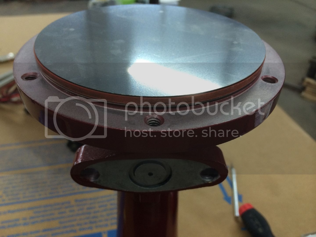

Little assembly, all the plates, gaskets, etc I numbered on tear down. I doubt I have the proper term but each plate is tuned slightly different I believe to give the proper sound characteristics.
I used grade 8 bolts to match the rest of the suspension components,
