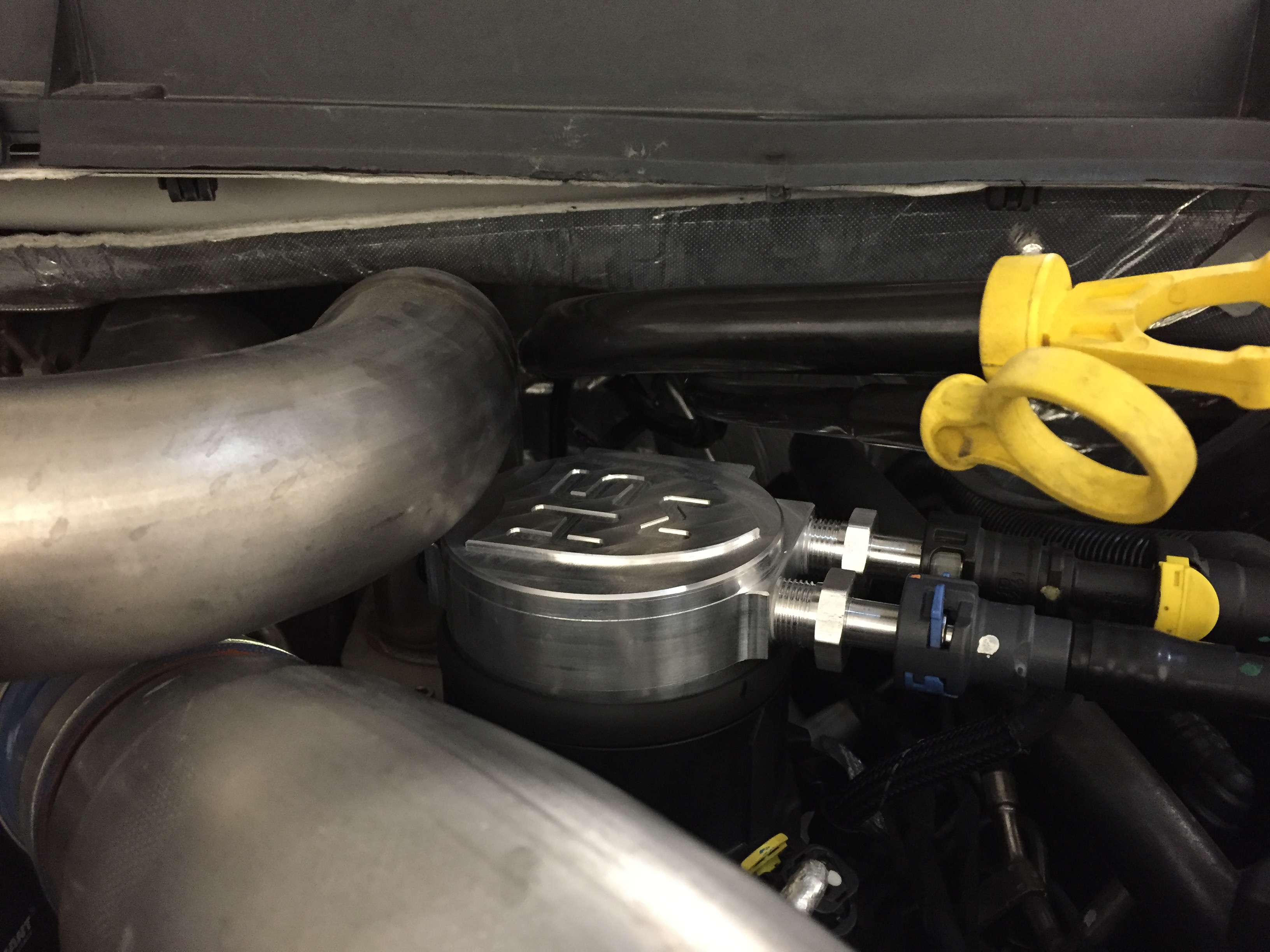

Mine sits down under the piping basically. Pita to change.
