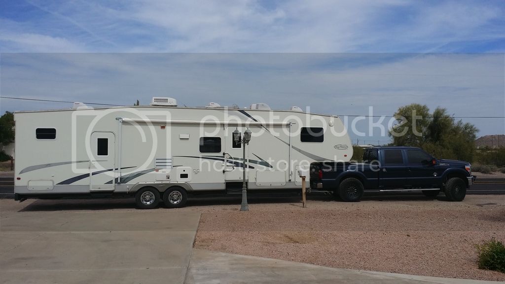

I'm in love with the air cells. Ride way better than the timbrens. The bump stops kinda snap in the bracket for them. I can swap them out in less than 5min. Snap off the bumpstops, zip off the bracket with no need to jack the suspension up. And they're off. It seems in this pic I'm squating, but I didn't add the extra spacers I needed to make it level. I'd rather have more travel after I unhook the trailer while camping.
Truck would ride on the stock bumpstops with this trailer (Deaver springs are to blame)
