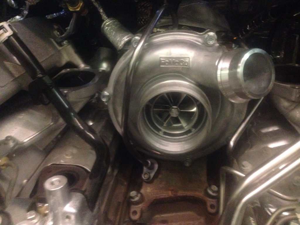

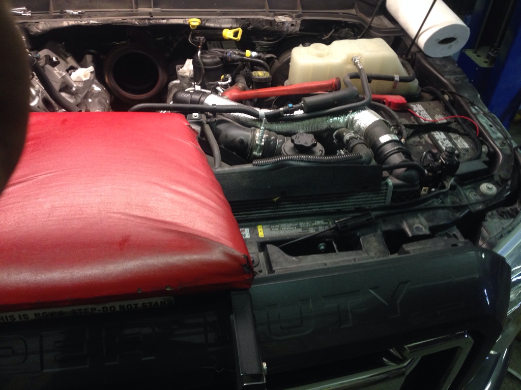

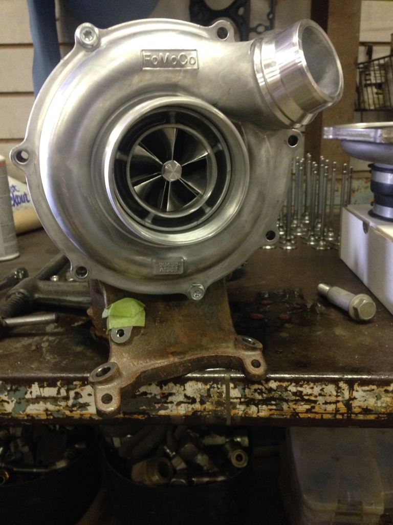

Well, the tracking on my tuner showed delivery yesterday so I decided to get cracking on it. For the first test turbo I used my original turbo (all other will be built from new).
Added the superchips from my boy steevie. Put the dpf back on... It promptly went into limp mode upon startup and informed me that I had zero def and the dpf was overfull! So I couldn't even drive it till I went and got def (since we don't stock that for some reason...). Took it for a drive and even with it in full regen, wow does it liven this truck up!!!
All you hear is spooling whistle in the cab. Sounds very much like the s300 kits. And it the power is smooth and comes on hard. It feels strong even for being in full regen. Makes over 30 psi and spools very well. Carries 10 psi cruising at 60-65. Overall very pleased. I can tell spool isn't quite like stock, but the average person who doesn't drive the truck every day would never notice. Haven't got any other numbers on it yet as it's still in full regen mode. Gonna try to take a long drive and get it all cleaned out. So far I'm super happy.
Hope to be able to come to market in the next month or so with these as long as testing keeps showing the positives that it has.
