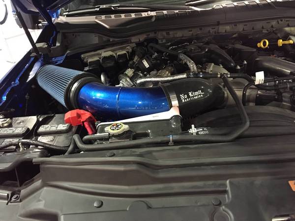

well i was glad to finally meet you and get to slap you around. thanks for choosing us for your only under hood mod . that being said , i can't wait to send you my head lights !
mike, why not move that battery and place filter up where they were on my truck>? first 17 mods:)

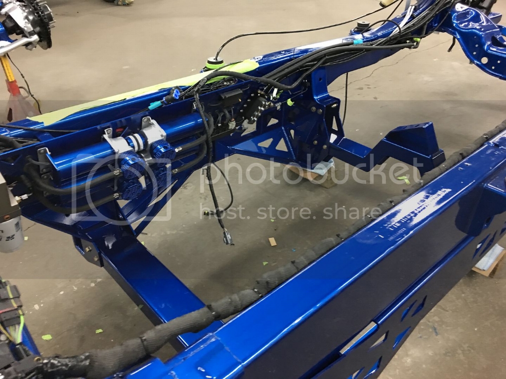

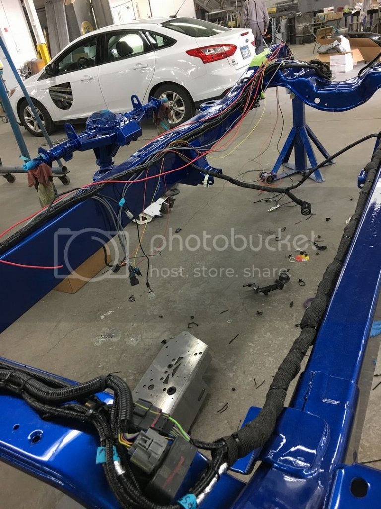

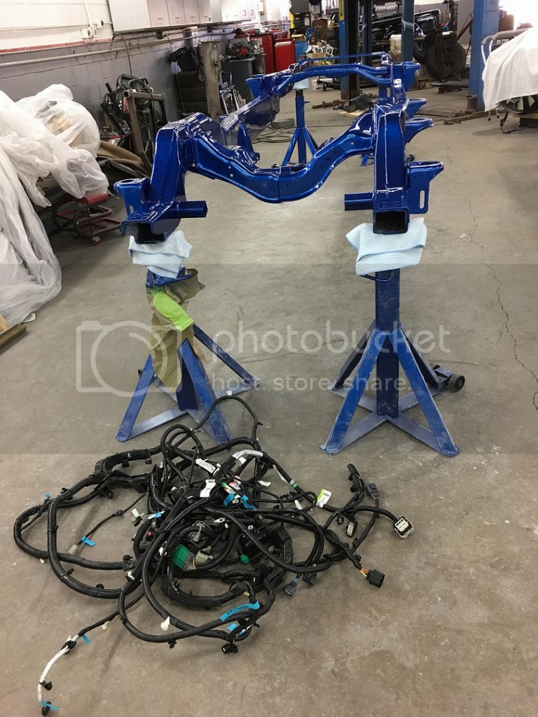

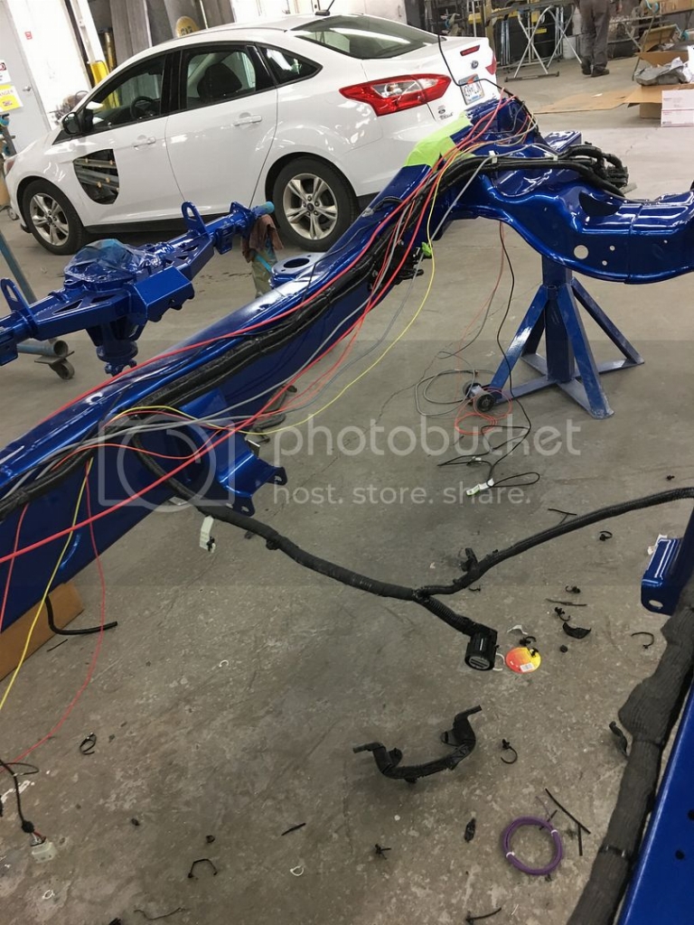

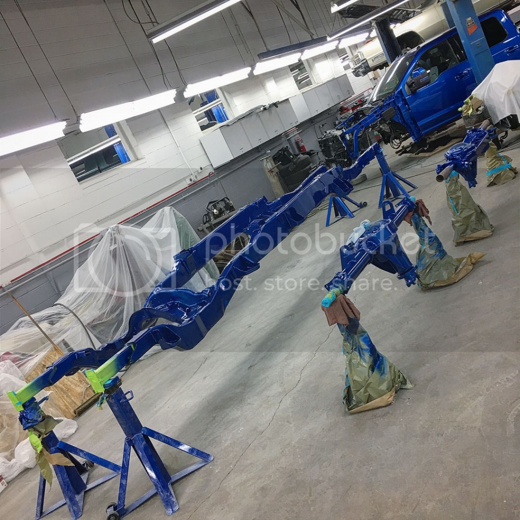

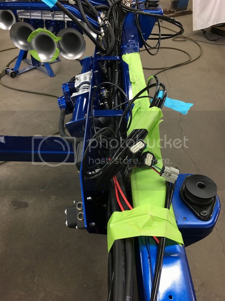

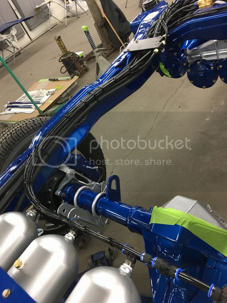

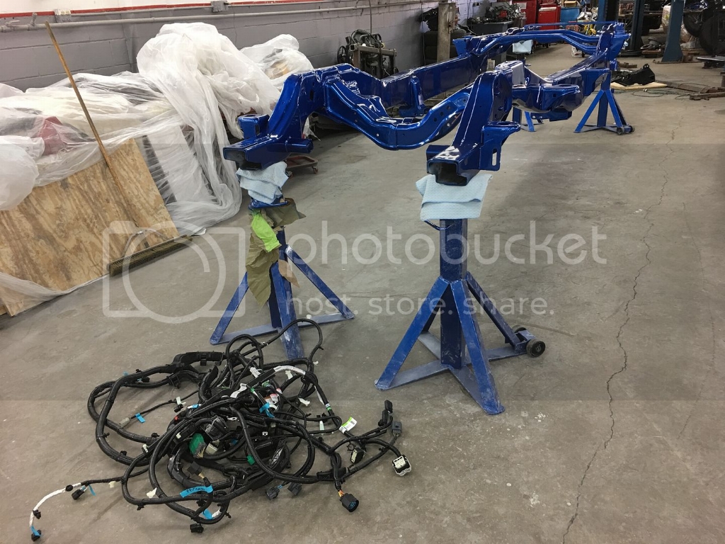

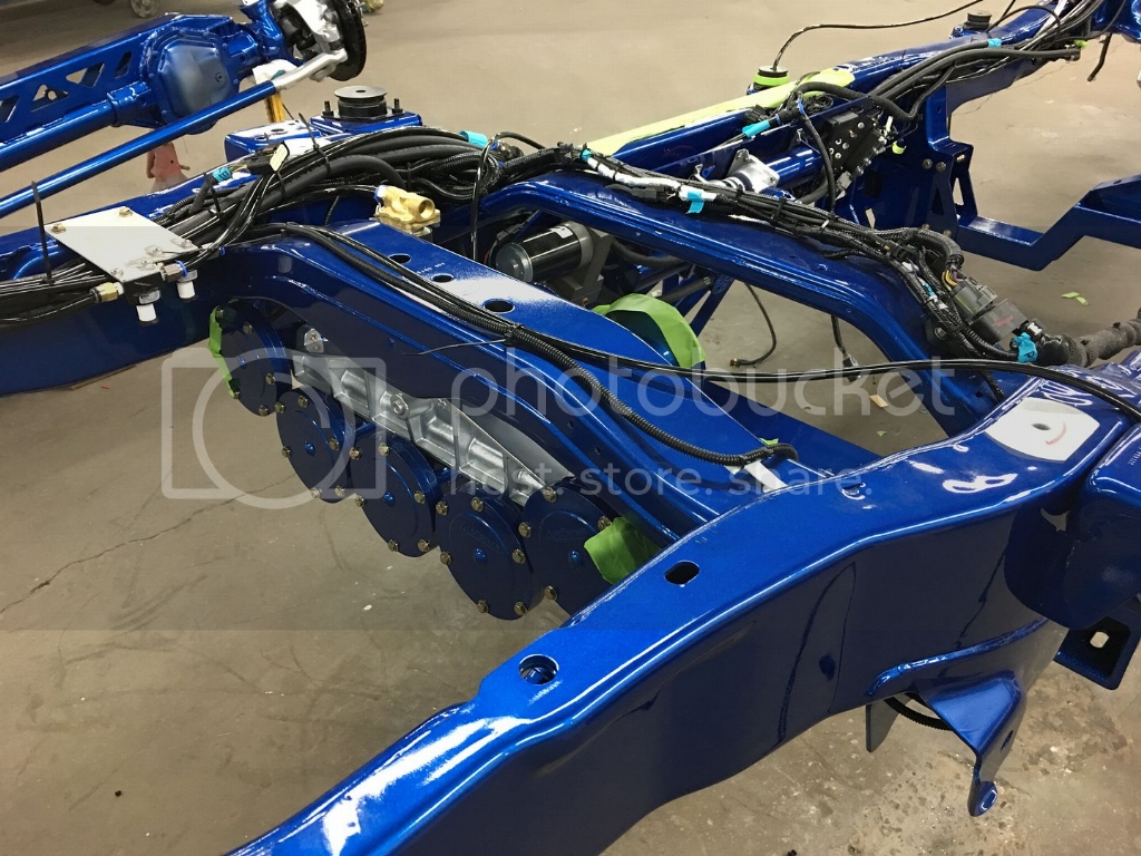

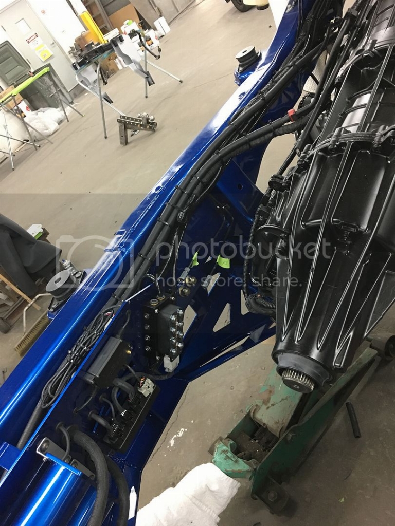

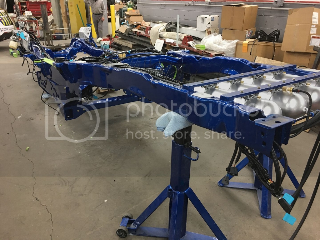

So here we start just a few weeks ago, frame all painted, axles painted getting ready to run air tanks, air lines, frame harness and the endless wiring it seems to run the air control system

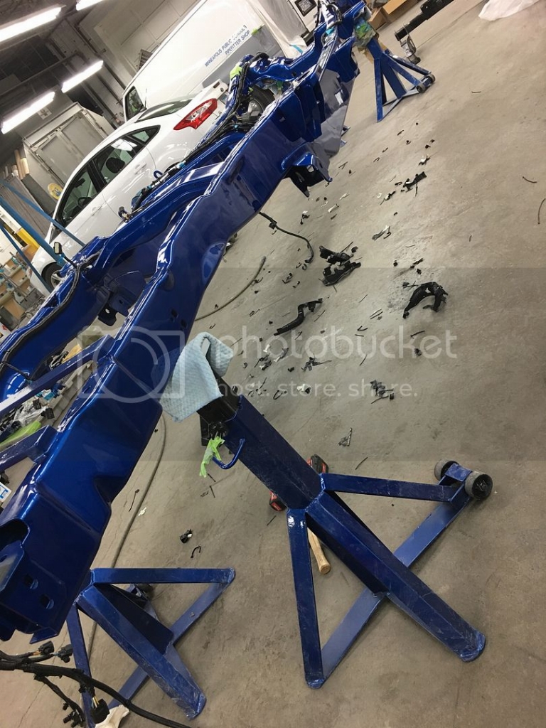

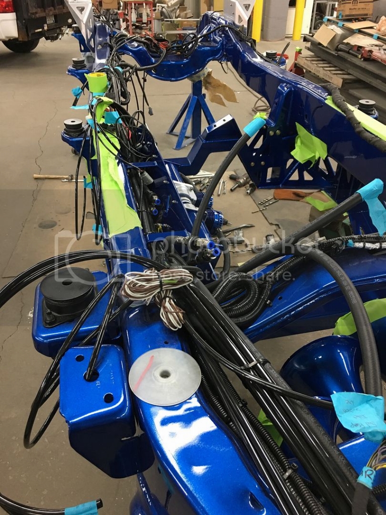

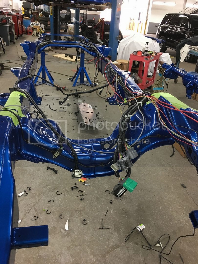

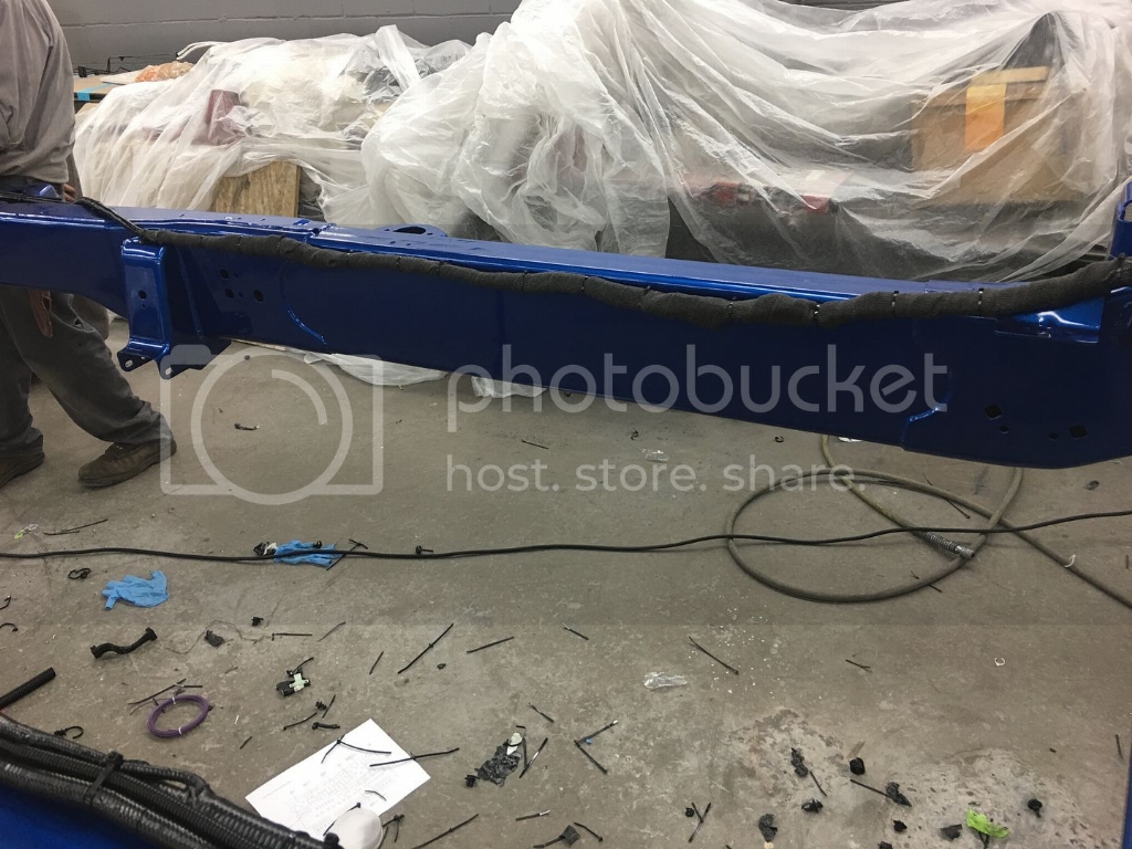

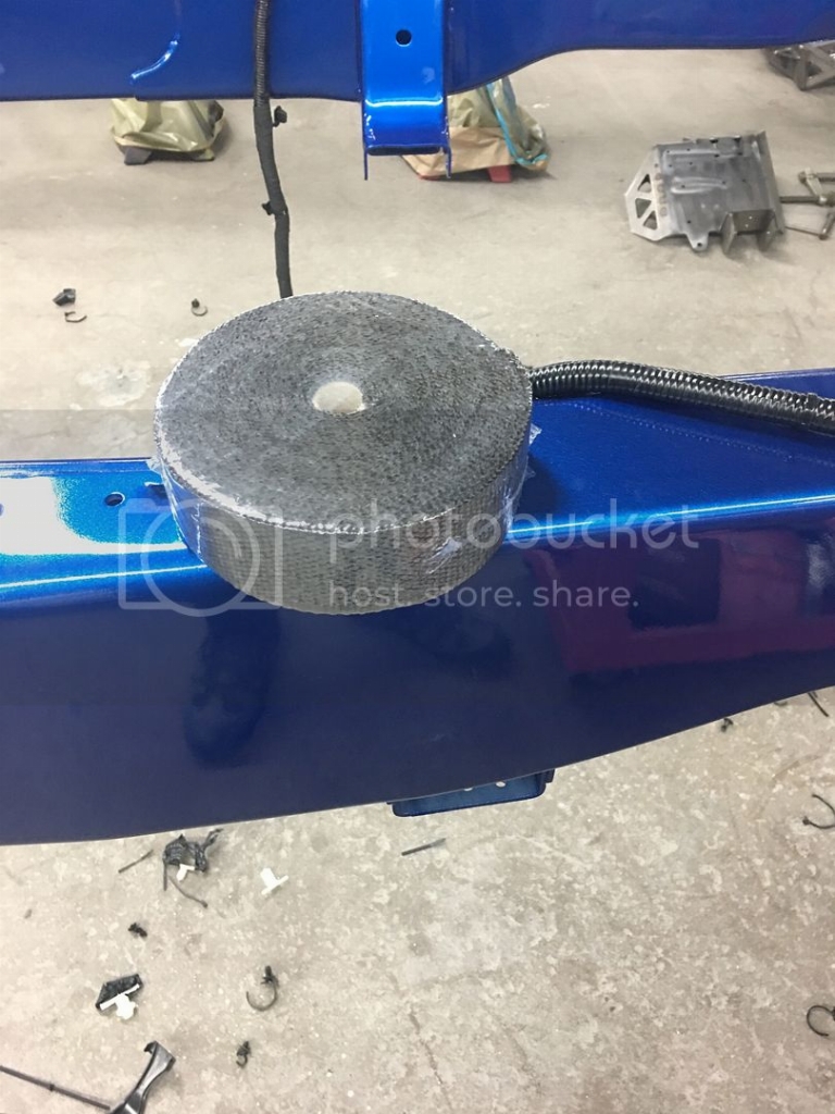

The entire chassis harness was rerouted on the inside of the frame rails, instead of on the outside. The harness was originally ran around each body mount and was quite ugly. About a day was spent cutting and rearranging the harness, exhaust wrap was used around the harness near the exhaust to prevent melting. Wire ties with built in push ins securely and cleanly mounted the wire harness.
A lot of retainers and random plastic pieces were cut out of the harness to clean things up.

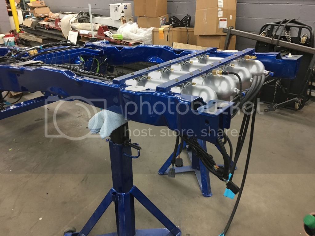

All tucked away and hidden behind the exhaust pipe,

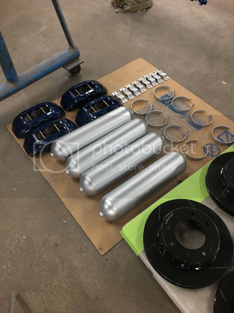

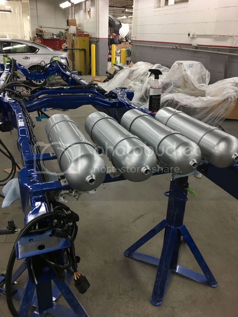

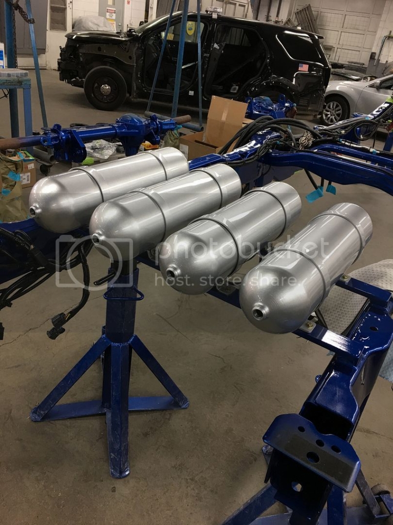

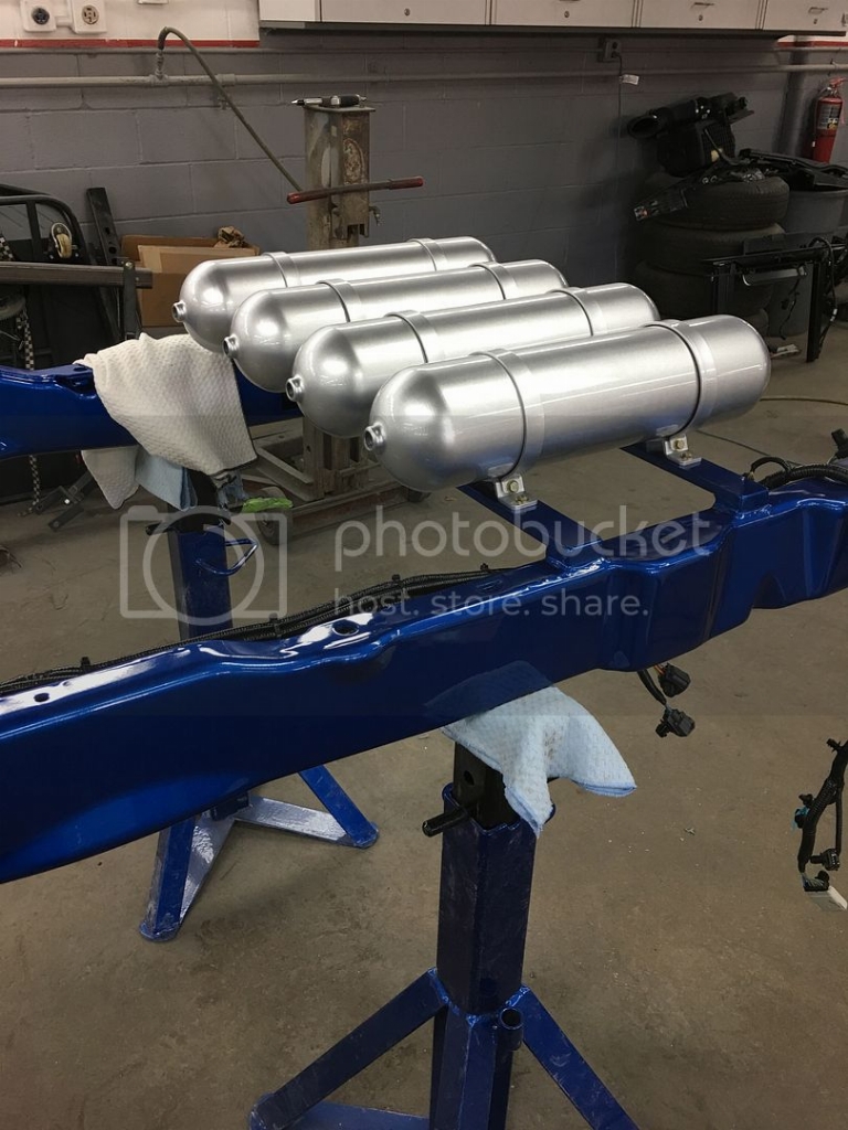

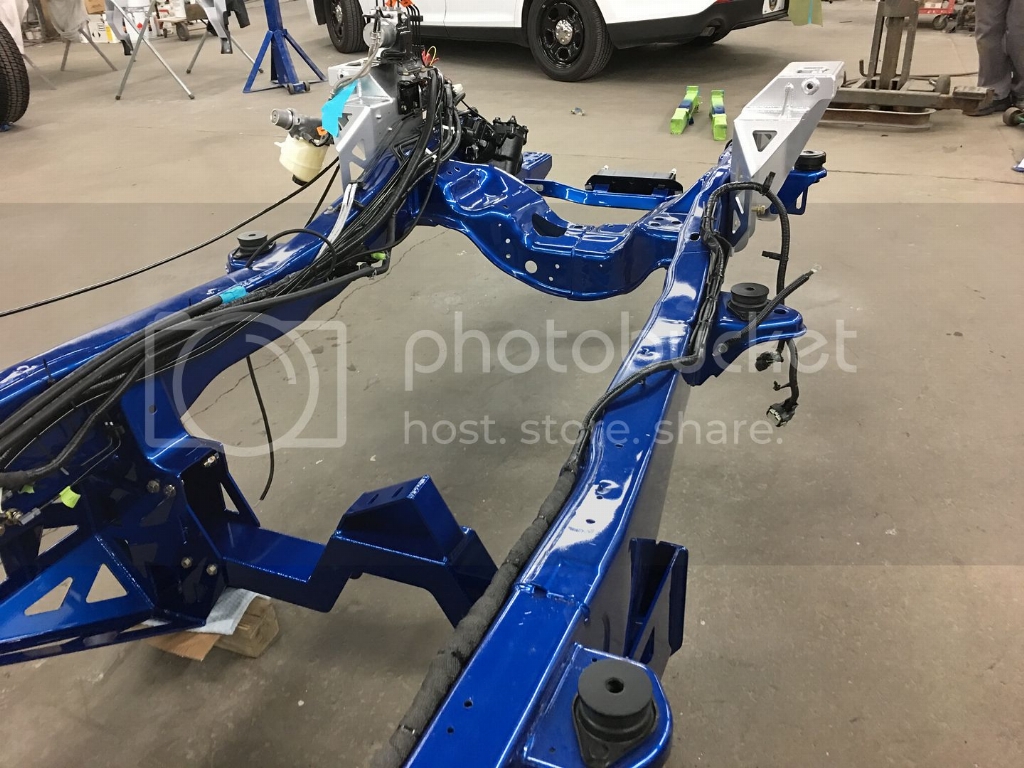

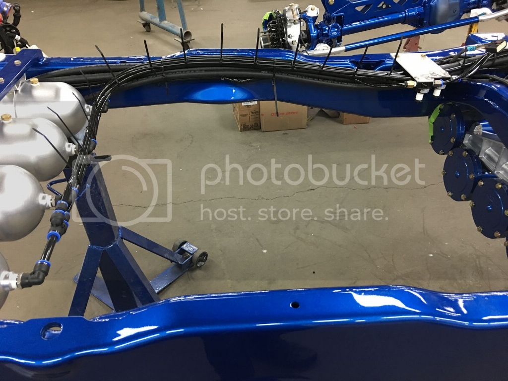

With the chassis harness installed it was time to start running air control wiring, air tanks and air lines. The rear spare tire crossmember were completely removed to fit 4 5'' seamless air tanks.
Yes the tanks were painted metallic silver, although its hard to notice.
The messes of wiring, tubing and fuel lines were starting to hurt my head. But nothing major was missed and things went as smooth as one could hope.
This makes me happy lol,
I will keep the updates coming now, thank you for staying patient with me.
