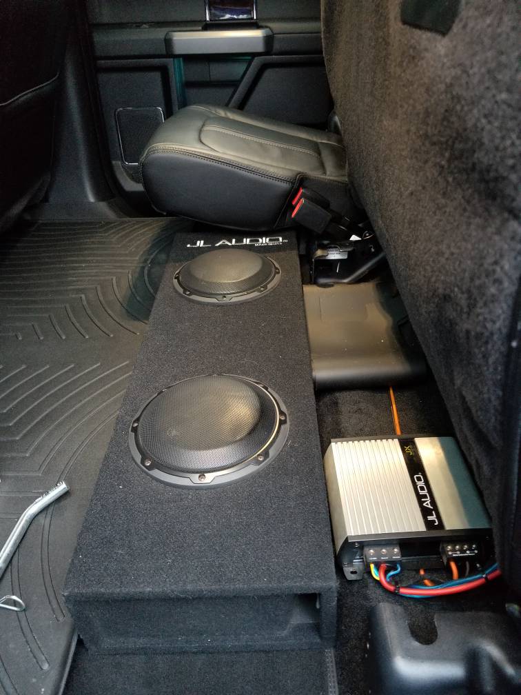

05f250harley
Jan 19, 2013
144
i put 2 jl 8w3s under the back seat. Its plenty of bass for me. they wouldnt fit behind the seat so they went under. I hate that i lost the storage but oh well.
