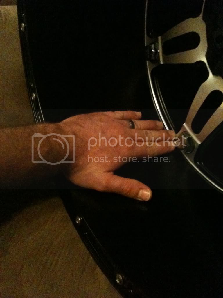

They are axle wise, but they also have a smaller fender opening. And leafs that are in the way where coils are not.
True. But a wheel with that high of an offset should never have issues hitting the leaf I wouldn't think.

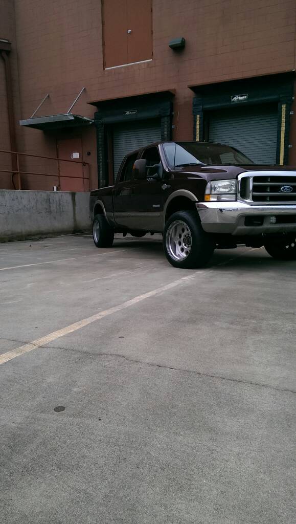

That looks great man, what's the specs?
Sent from a Cummins plant, driving a Powerstroke, with a TDI on the side!
Thanks, the truck is leveled out and lowered just a tad. Sitting on 20x12 -44m fuel hostages. 305/55/20 terra grapplers. Minor stretch to the tire. Slight rubbing at low speeds making sharp turns with body roll. Gotta let it rub for a couple days so i can see exactly where its rubbing and cut accordingly.

Leveled out and lowed a tad? Elaborate.

Bought the truck like that so its the best i can explain it, Better than saying stock setup, and misleading someone.
Best i say is its lowered around an inch. 5200 coils in the front then lowered/leveled accordingly in the rear.. On bilstein shocks.

Looks to be, like you said, a little lower than stock height. Maybe 4800 Springs and no rear block. The pic I posted a couple pages back is stock height in the front and 1" block in the rear with the same size tires and they look way smaller on my truck lol.
